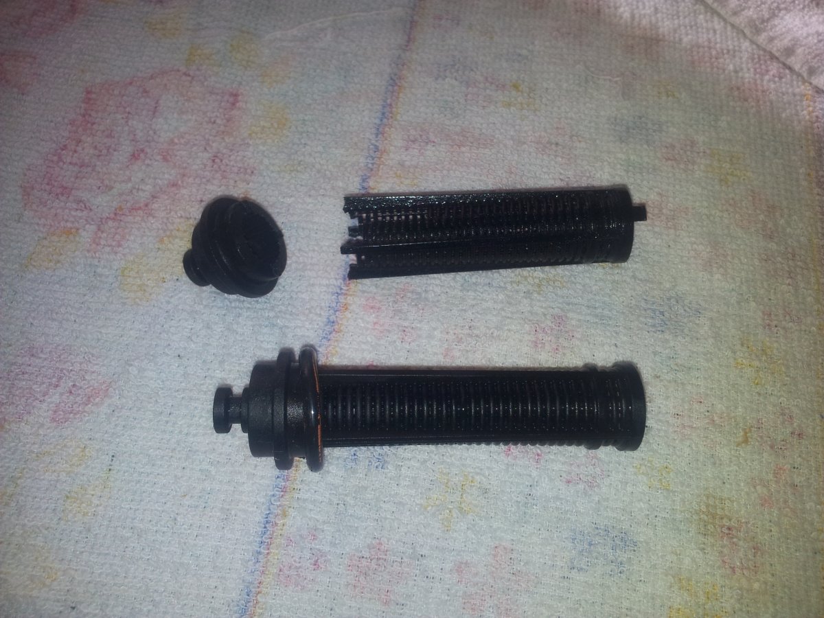

My boiler "Glow worm 30cxi" started leaking water very bad and I had to lock the water mains, now no water at kitchen or toilet.
Opening the boiler found that a bit of plastic became loose/detatched from its rest in one of the tubes.
I have few question that I would really appreciate your answers and help for.
Please watch this youtube below to see what is happening
1- Is it safe to fix it myself?
2- Will it still be safe after all that water that gone around the inside?
3- Is it safe to block it with a piece of cloth temporarily just to use the water on the other taps, but I won't be using the boiler?
5-Is there a way of blocking the water to the boiler only? I tried the little two valves at the bottom back of the boiler but they didn't stop it.
4- What part do I need to replace? Is it only the broken plastic bit or the whole assembly where it goes?
5- Where can I buy it from? Ebay? Other site? Please provide a link.
6- Is there any special notes I need to be aware of before and while replacing it? In case it's something I can do by myself and not suppose to call an engineer for this specific fault.
Thank you in advance
I just found that the broken part is called Domestic Cold Water Inlet Filter.
I am currently searching for it but can't find it so far.

Can you see what has actually broken?
The cover has to be pushed fully down and then the clip should engage with the groove.
Why is that apparently not happening?

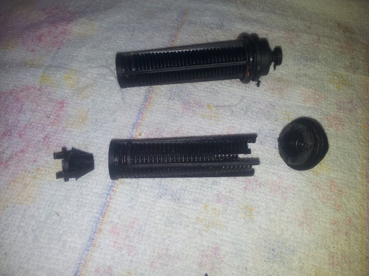

I have just been to a local shop and got one of them.
I replaced it, and when I open the mains it holds for few seconds and then the starts leaking.
I noticed a small difference at the botton which I think might ease the pressure coming to the filter.
Is this the correct part?

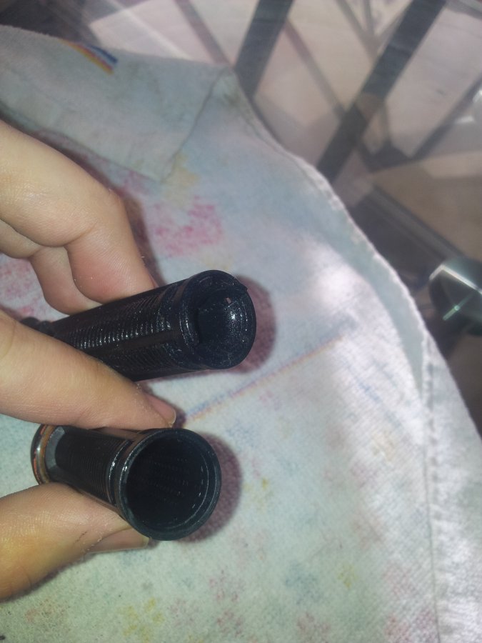

I just found out that the extra bit at the bottom actually comes off, but the new filter doesn't have the openings to hold it, should I make them/force it?

You seem to be concentrating on the internal parts of the filter.
Its the outer casing that contains the water and is the important part in respect of any leaking.
You say that something has snapped. Can you explain what has snapped? What is still leaking?

The broken filter and how is it damaged and where it fits are all in the photos and video.
After the new filter fitted, it holds the water for few seconds and then starts leaking, but not as bad as with the broken one.
Thr metal locker that locks in the filter in place doesn't seem going all the way, I feel/see as if it should go 1mm-1.5mm further, I know that with high water pressure that such small mesurements still make difference.
I tried pushing it as hard as I can, but the limited space is not letting me do better.

The metal clip locks into a groove on the end cap.
That must be fully pushed in before the clip is inserted. I don't think you are pushing the cap all the way in.
I would lubricate the "O" ring with silicone grease. You could use a little washing up liquid instead.
Are you trying to tell me the groove part of the cap separated when the fault occurred? I have never seen one do that. But it may not have been properly inserted beforehand.
Tony
I wasn't putting the new filter correctly, I put the ring first pushing it in place, then the filter then the metal lock which now gone in nicely all the way and clicked, but still the water would still leak from there.
I am giving up, seems I am gonna have to call BG for their one repair service
