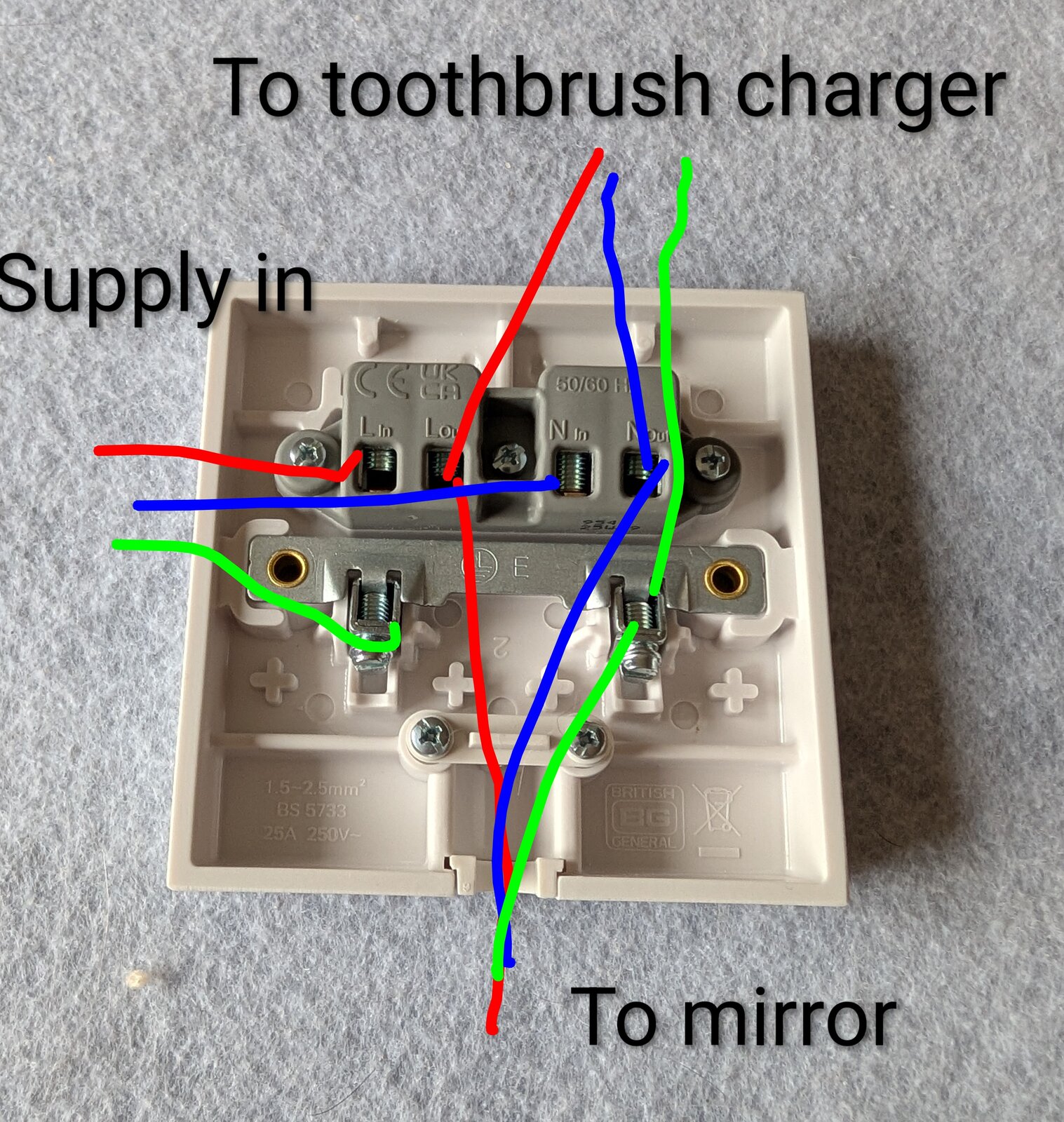

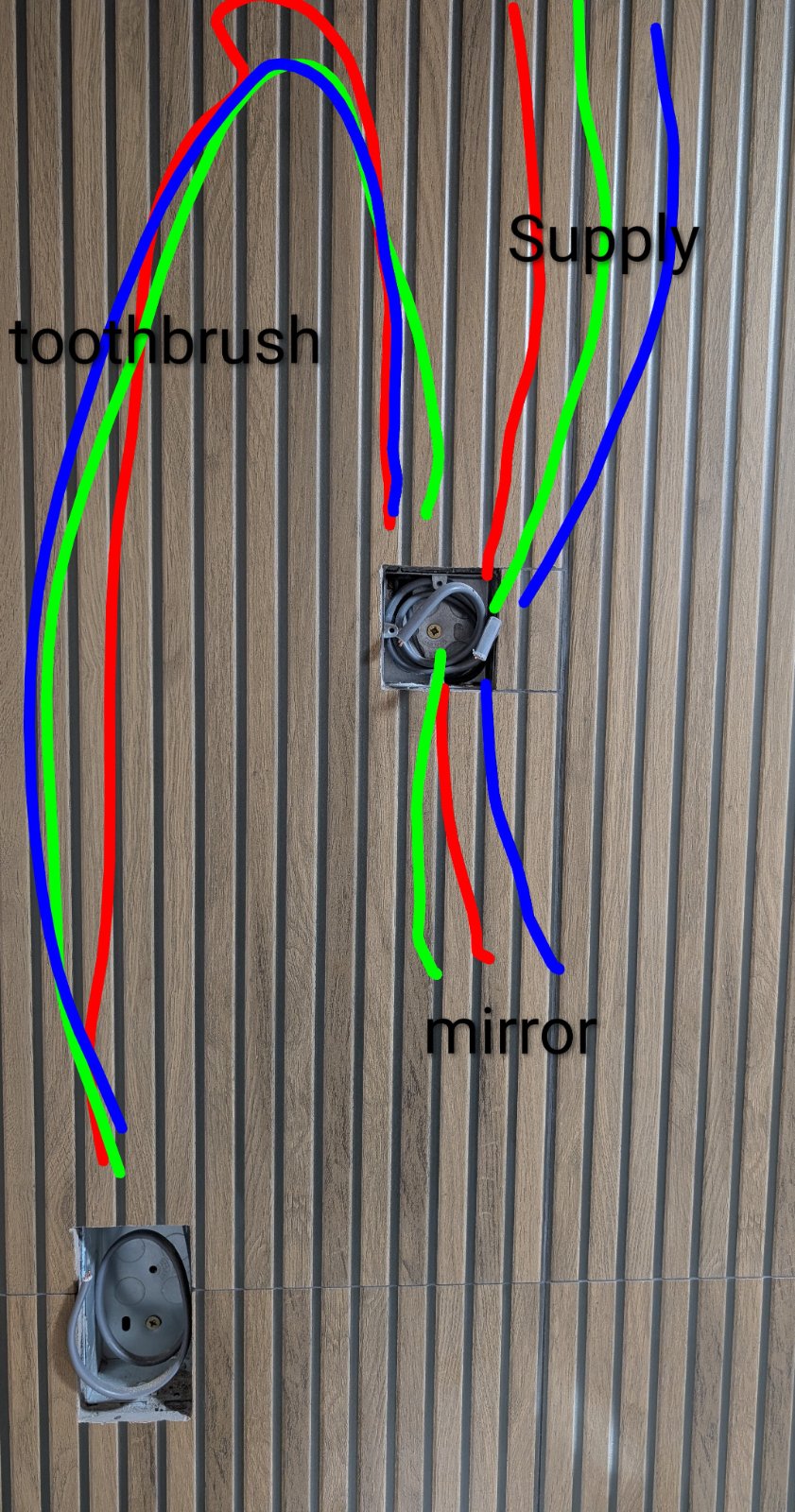

I ran some cables to wire in a toothbrush charger and a mirror with a light.
My thought process was to bring the lighting circuit down to the mirror and power the mirror with a flex outlet then continue the circuit on to the toothbrush charger.
Flex outlets seem to be two connections only, the supply coming in, then the flex going out.
Can a second T&E be added to the out side to feed the toothbrush charger as per images or is this a bodge job?
What's the correct way to do this? Junction box in the loft providing individual feeds down to the two appliances?
You could put all three wires to the IN connections, or all three wires to the OUT connections - it wouldn't make a scrap of difference.
This is what I initially thought, but as flex outlets only seen to come with an in and out, I started questioning it and wondered if I was going down a "cowboy" or bodge route.
Put both T&Es into the „In“ terminals and the flex into the „Out“. Better not to mix solid and stranded under one screw.
