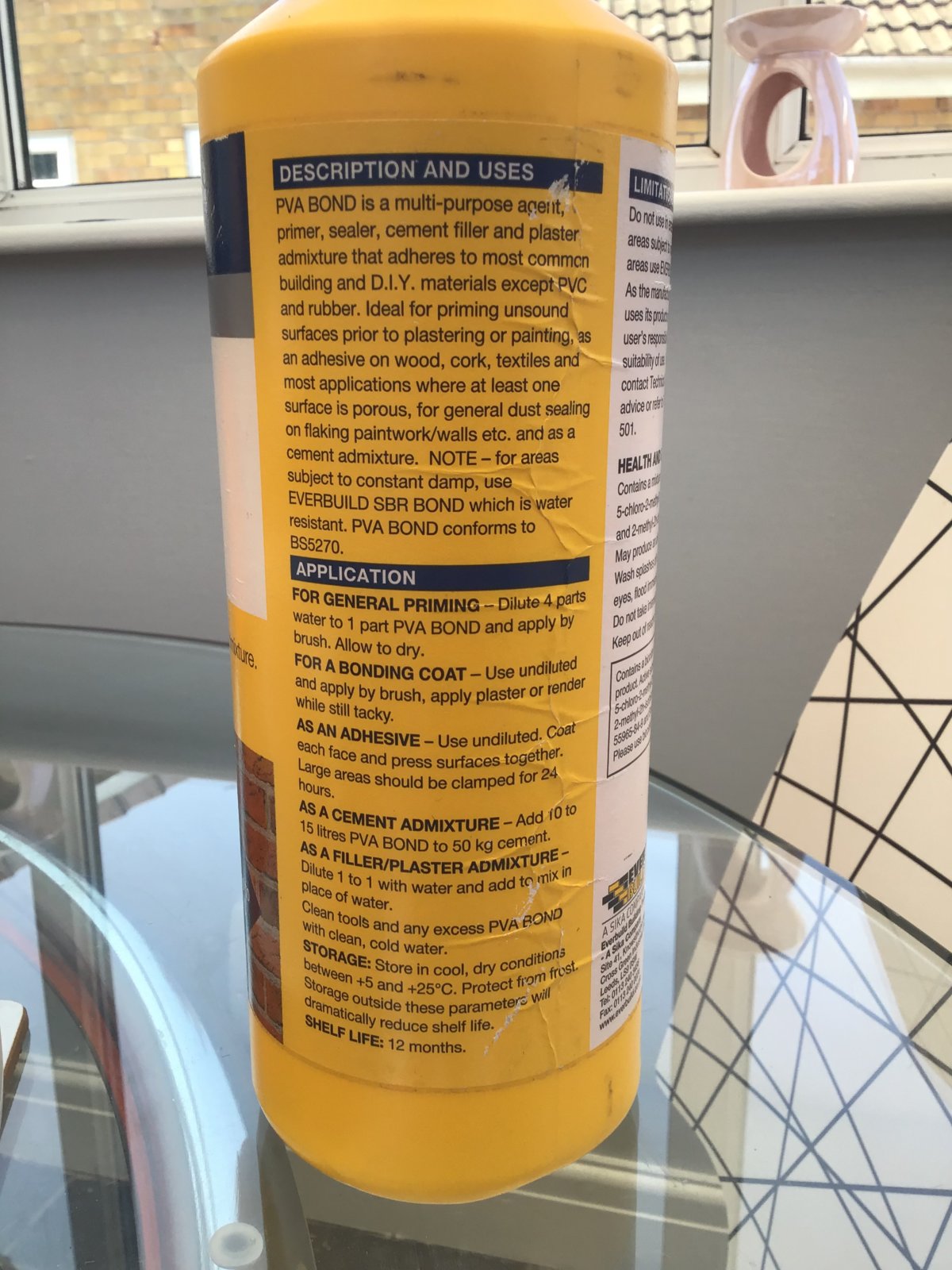

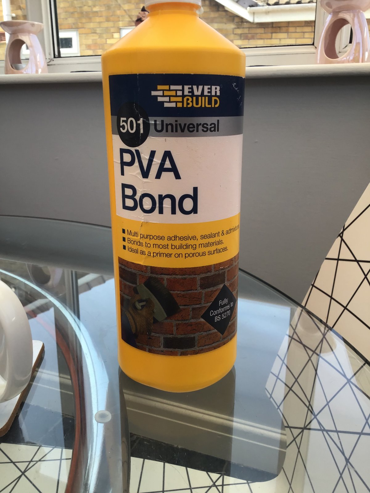

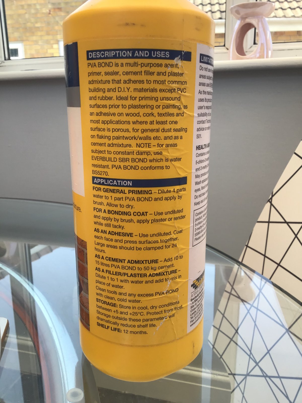

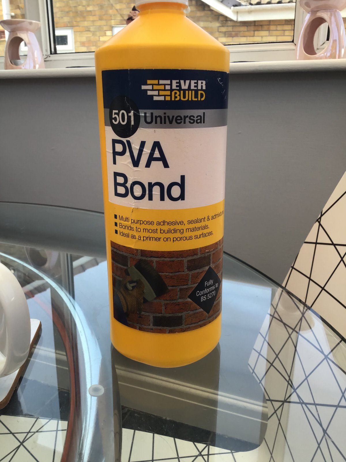

Thanks guys.. I think the most the daughter will do is probably help peel off the old paper which is what I'll do, seeing I've got time on my hands . Another thing, would I need to apply lining paper once I get the old stuff off or can I apply straight to wall without any other treatment.. I think when we put the first paper up we applied a white sealant to the wall because it was plasterboard walls. Will we need to apply this again?
The white stuff was probably pva bond , good idea to recoat with it. I would always use lining paper, an 800 grade should do . Then on with the fresco.
Just so you get the right stuff , £3.99 a litre will do. Good luck.
