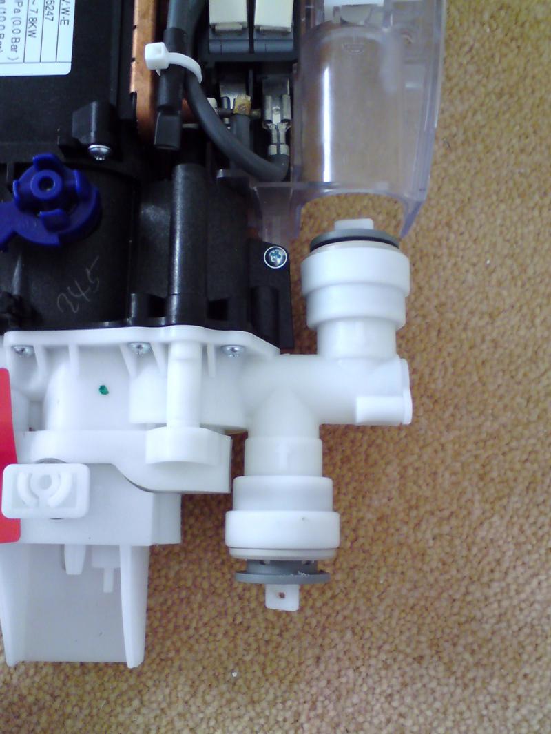

Got a new shower to fit, but cannot for the life of me remove the plug from the water inlet! Any suggestions? Please?

A great tip, but annoyingly I need the top input which is masked by the transparent cover, so barely any room to move or apply pressure.
Other suggestions?
A fear of not being able to put it back together again as it's incorporated into the rest of the unit :o
I can see one screw that it looks like fixes the bottom of the cover is there one at the top also?
