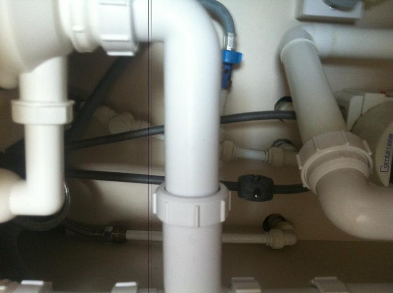

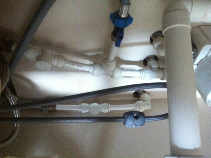

Cant find stopcock in new kitchen
Photos not very clear.
Have a look in other kitchen cupboards, might be there, sometime it under bottom of base unit covering by plinth cover.
Or ask next door ( look the same as your building ) to see where their stopcock is.
Daniel.
What about behind the cupboard back board. Maybe they just covered it up. Are you able to get a mirror and a torch in there to have a look?
Do you have a garage? Sometimes in there.
Where is your external stop-cock located? Eye ball a straight line from the external S-C to the house, and it should indicate where your water enters the property.
As above, a mirror and flashlight to the back of the under cabinet to look up.
Do you have any boxing-in in the kitchen or near to where the water enters the house? Have you checked the gas meter box/cupboard?
Do you have access to a crawl space?
In a refurbished house, i once located the S-C on a shelf above the front door, it was feeding thro the upper floor to drop into the kitchen with the boxed-in SVP.
