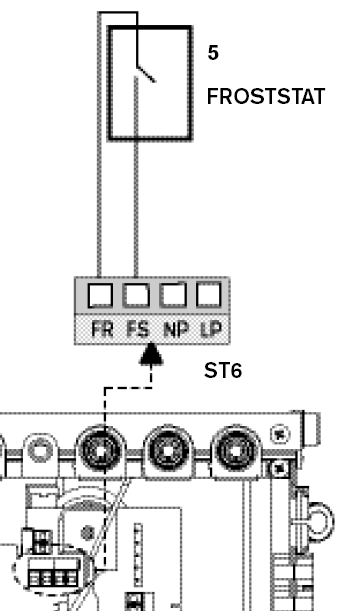

Do you have any connections to the remote frost stat terminals FS and FR?
Im not sure its in a friends house and i have only checked Ls Ns and Lr and dont know where or how to check the remote frost stat can you advise me on this.

An external frost stat overrides all other controls to operate the boiler when the ambient temperature in the area where they are located falls low enough to pose a risk of freezing. They are not usually fitted to most installations, only those where the boiler, or another part of the system are in an unheated garage, outbuilding or exposed location. Some frost stats have a limited low range, but some are capable of 20 degrees plus. So if one was fitted, and had been inadvertently turned up, or was faulty, that could create the problem you describe.
If a frost stat is fitted it should have been wired to terminals FS and FR. As Lr and FR both have the same function, (ie operating the boiler) it is quite possible that FR is linked to Lr internally.
