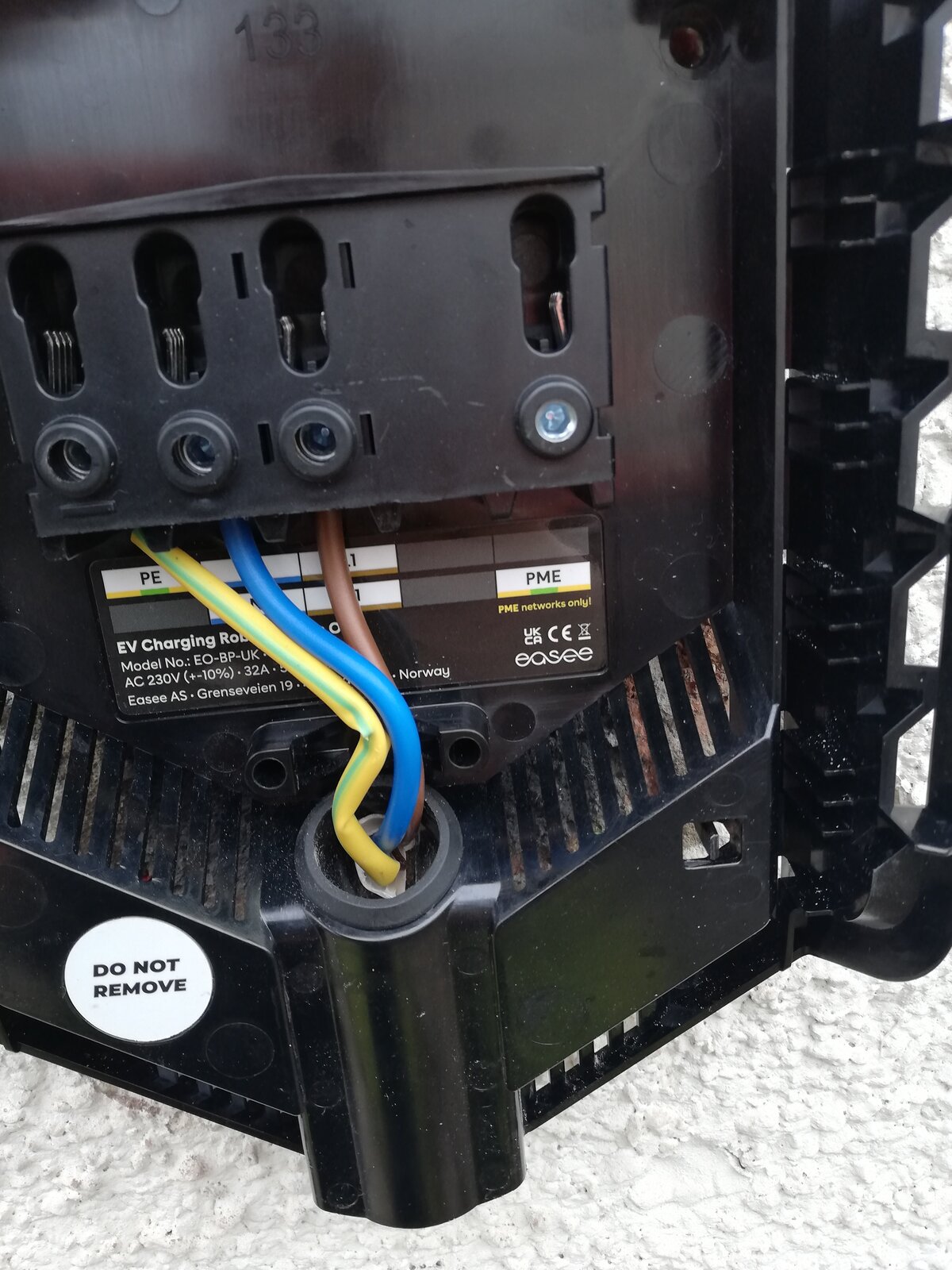

Hi, I was looking for some advice regarding a mates EV charger that he had installed through a scheme when he bought the car.
He called me to loosen the charger off the wall so he could sort the roughcasting that the installer had burst whilst drilling through the wall.
Install seems shoddy, wall burst, no clips inside, cable clamp missing in charger, no test certs but my attention was drawn to the earth connection in the charger.
It has 2 earth connections, TT/TN-S and PME, he has connected into the TT side when it is a PME system that my mate has.
I called the installer to double check it was correct, he seemed unsure and that he only ever connects to TT and said to leave it.
I'm not familiar with car chargers, I thought they needed an earth rod but not sure if the technology has moved on over the years.
Should the earth connection be in the PME side?

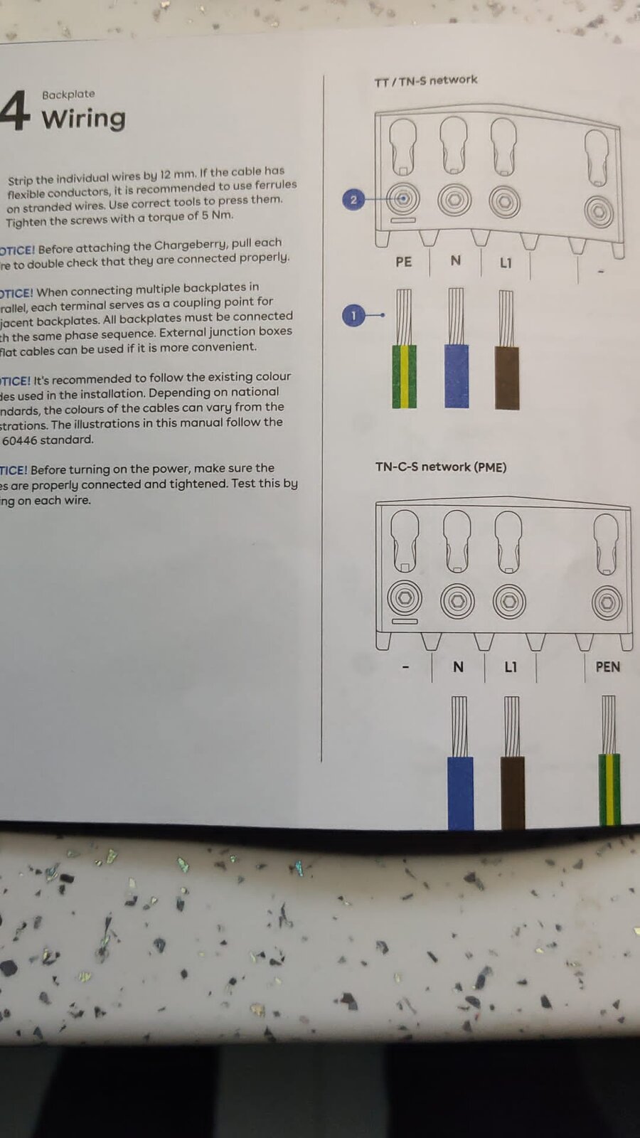

It's an Easeeone charger that has been fitted, I've included a picture from the manual and the charger itself.

To be fair their instructions don't make sense.
They have "L1", "N" & "PEN" listed as connections in their TN-C-S drawing. You won't have a PEN conductor at this point. The PEN conductor in a TN-C-S installation is simply at the origin - it is the TN-C (Combined) part of the equation, with the -S (Separate) from that point on. The fact they have listed PEN and N as two separate conductors is nonsensical. A PEN is a protective Earthed neutral - i.e. combined Neutral & Earth connection.
We also don't know what type of devices are fitted upstream, e.g. there might be PEN fault detection upstream.
With a TN-C-S supply there are three options.
1) If the is enough separation convert to TT supply.
2) Use an earth electrode as a reference point to detect loss of PEN
3) Use the incoming voltage to detect loss of PEN.
For some reason it seems allowed 70 volt between earths on a EV charger, everything else is 50 volt, not a clue why, but it senses voltage and if not in the 207 to 253 volt range it fully disconnects the charger first lives then earth.
I looked for internet instructions and could only find U-Tube videos, so not a clue which method it uses. All I could find was a single/three phase unit which is not as you show. It would seem only option would be to call the manufacturers help line.
Some do, most don't, some have options for them.
The Easee has one of the protection methods as described in BS7671, so can be installed without an earth rod.
However that only works if it's connected according to the 'TN-C-S' diagram, which it hasn't.
It's installed incorrectly.

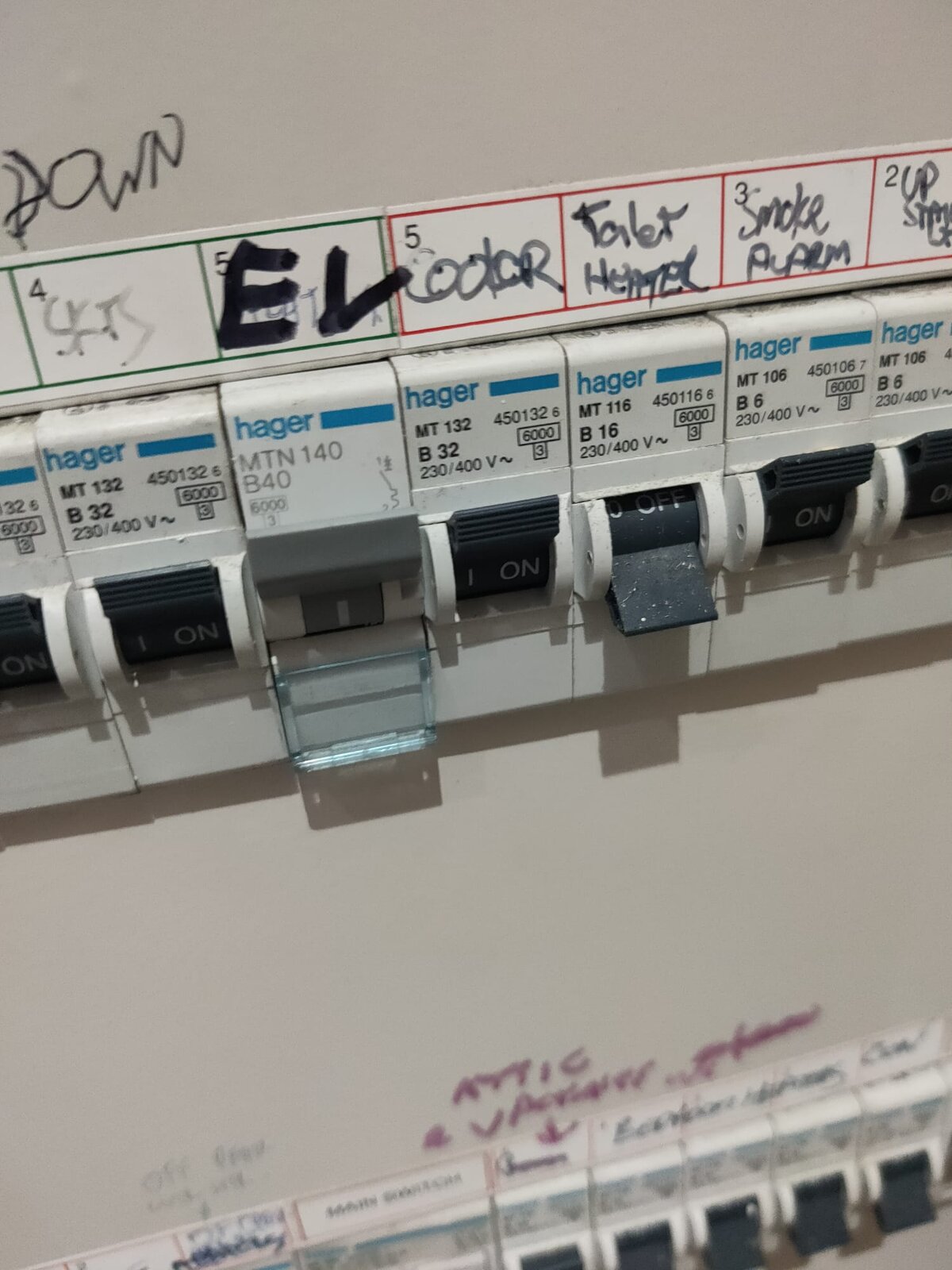

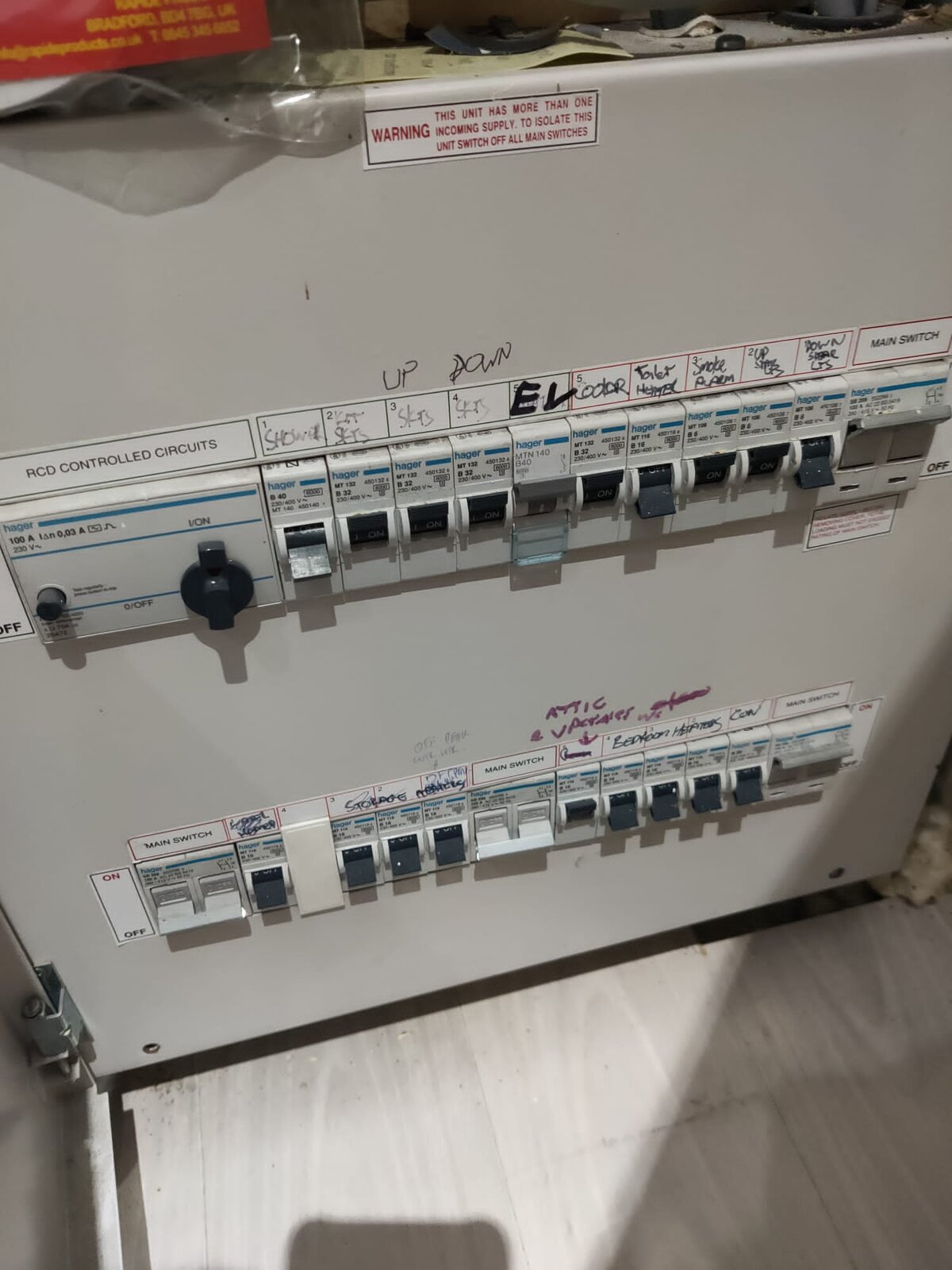

What is the rest of the installation like - cable type, where is the cable installed, what is it connected to in the consumer unit ?
Thanks everyone for your replies.
The charger is wired in 6mm T&E, it's back to back with consumer unit so the cable is 2m max.
It's connected to a 32A MCB, the main Switch is 30ma.
Looking into EV chargers online it seems they may have to have a type B RCD (again I may be wrong) so I'm not sure if the main RCD will comply?
That is a type AC RCD, not appropriate for supplying any EV. Type A minimum if a RCD is required, which it probably wasn't in that installation.
Not appropriate to add another circuit to an RCD that already supplies so many other circuits either.
The Easee includes the equivalent of a Type B, however those can't be installed downstream of a Type AC.
Ultimately it's been slung in by someone who either doesn't care, doesn't know that they are doing, or both.
