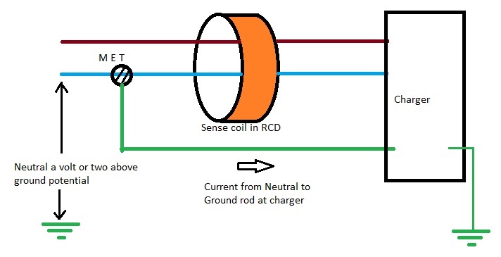

If the Earth in the building is derived from the Neutral then it should not be connected to the ground rod forming the Earth for the charger to prevent current flowing from Neutral to Ground . This current does not pass through the RCD and hence has no current limiting protection other than the impedance of the ground rod.
If I have read correctly, would the RCD not open?
No as the current from neutral to rod does not go through the RCD sense coil

It makes the point that connecting a Neutral derived "earth" to a low impedance local earth can and does create a signficant risk of high current flowing through the earthing system.
If the installer of the car chargeer provides a low impedance "earth" to local ground and then exports the "earth" then reality the Neutral of the supply has been connected to ground. This can then high currents flowing through the earthing system. Very unlikely that the impedance of the charger's ground rod will be low enough for the currents to be high enough to cause any damage. . The risk is small but there have been several instances of fires caused by earth and/or bonding cables overheating when the Neutral has been faulty or damaged ( metal theft ) and the local ground was via a metallic water supply pipe.
