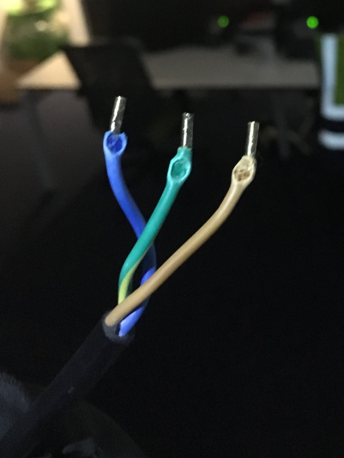

Most of the light fittings I disconnected were like this :rolleyes:
Reminds me of a new Spectrum kitchen install.
Every socket was connected something like, and I had to re-terminate every socket.
I found a whole new house install where not a single wire had been stripped and insulation displacement had been relied upon along with chewed screwheads where they had been done up so hard to make it work, the only exception being the CU tails where there was something like 15mm of bare copper.
Apparently 'in my country' fittings were designed to be installed like that.

I opened up a cheap crappy Chinese multi adapter / extension lead which had failed a PAT test for having no earth continuity. Its LN&E wires had been terminated by screwing into the insulation as in the top photo - but there were no ferrules on the wires and no sign of them having been stripped before terminating. What were they thinking?
Whats for tea that day? The footy results? Does that bird down the pub fancy them?
Anything, but obviously not what they were supposed to be doing :)
