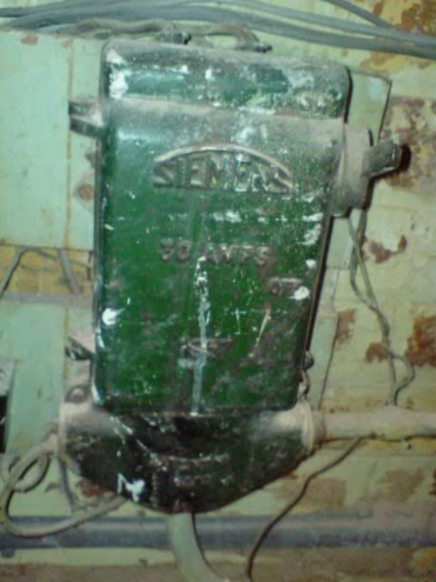

With "Siemens" and "30A" on the front, feeding rubber-insulated, fabric-covered tails of about 0.007in².
That's YEDL for you!
Certainly is. (Well CE Electric UK these days) :wink:
Not many like that round your way then?
There are a few, but not many.
I cover Macclesfield & High Peak, Staffordshire, Cheshire & South & West Yorks.
Staffs has the highest incidence of CI cutouts, mostly on TT supplies... :shock:

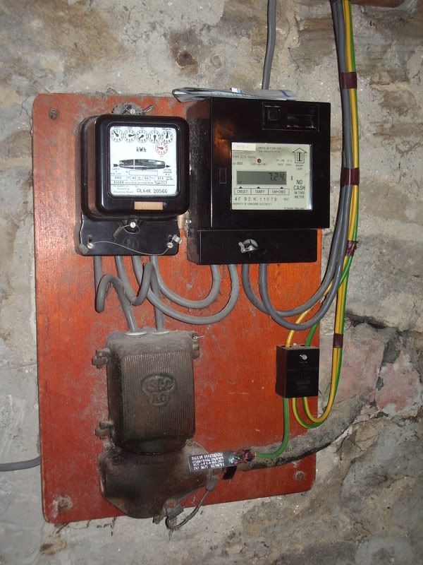

This one is in my house in Hull - also YEDL :-
Securespark, are all Cast Iron Cutouts on TT supplies ? I guessed by looking at the earthing arrangement on mine, it was a TN-C. ? I can't see an earth rod anywhere on my property & all the Bonding Earths go straight back to the Consumer Unit Earth Bar.

TNS or TNCS ?
TNS or TNCS ?

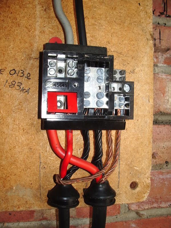

Hmmm, just looked at the plans for the tnc, tns & tncs arrangements. I suppose without being able to see into the Cut-Out itself, it's pretty hard to tell ? Do the Electricity Companies do the Neutral~Earth connections within the Cut-Out usually ?
No. Not all CI cutouts are on TT by any means, but what I was saying was the vast majority of SUBTERRANEAN TT supplies in Staffs I find are Cast Iron.
Yours looks like TN-S which is the earth connection coming off the sheath (or the CI casing in your case).
TN-C-S is usually done within the cut-out, but then some TN-S supplies are done that way too. The only way to tell them apart is the thickness of the cable.
TN-S with earth connected within cutout - modern pvc cable:
TN-C-S:
You can see the TN-S here is fed with split-con cable - 3 conductors, whereas the TN-C-S supply cable is straight concentric - effectively phase & a combined PEN conductor.

Here is another slightly different naked TN-S for you :lol:
Virtually all the CI cutouts in my area are ISCO, with the odd seimens and lucy oxford dotted about.
Like this (But not normally with a BS951 clamp on them) :lol:
And a TN-S in my house ;-)
Yes, yes - I still have not got around to changing the CU and tails.......but have to move the CU for building works soon anyway!
