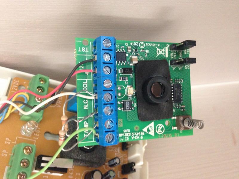

Hi all, we have an old Castle Care tech 1600 alarm system that is playing up.
When you try to arm the system it just beeps constantly and doesn't set. It shows a number 5.
I have conducted the walk test and sensor 5 doesn't show, the infra red lights up and notices you fine.
I have replaced the sensor anyway and it still has the same problem.
Any ideas as this is throwing me a bit.
Thanks.
I've tested all the wiring and it has between 13 and 14 at the live, 0.30v at the tamper (same as another i tested) but absolutely 0 at the NC white wire.
I looked at another sensor and that is reading 5v at the white.
Yes i can set the alarm by linking out the zone. 5# basically after the pin.
No REMOVE the two wires from zone 5 in the panel, fit a shorting link in zone 5 does it now set ok ?
Take out the 1k resistor ( brown black ) from the tamper/ alarm terminal and put it across zone 5 in the panel with the wires removed , will the alarm now set ? Check red / black for 13v at the pir
