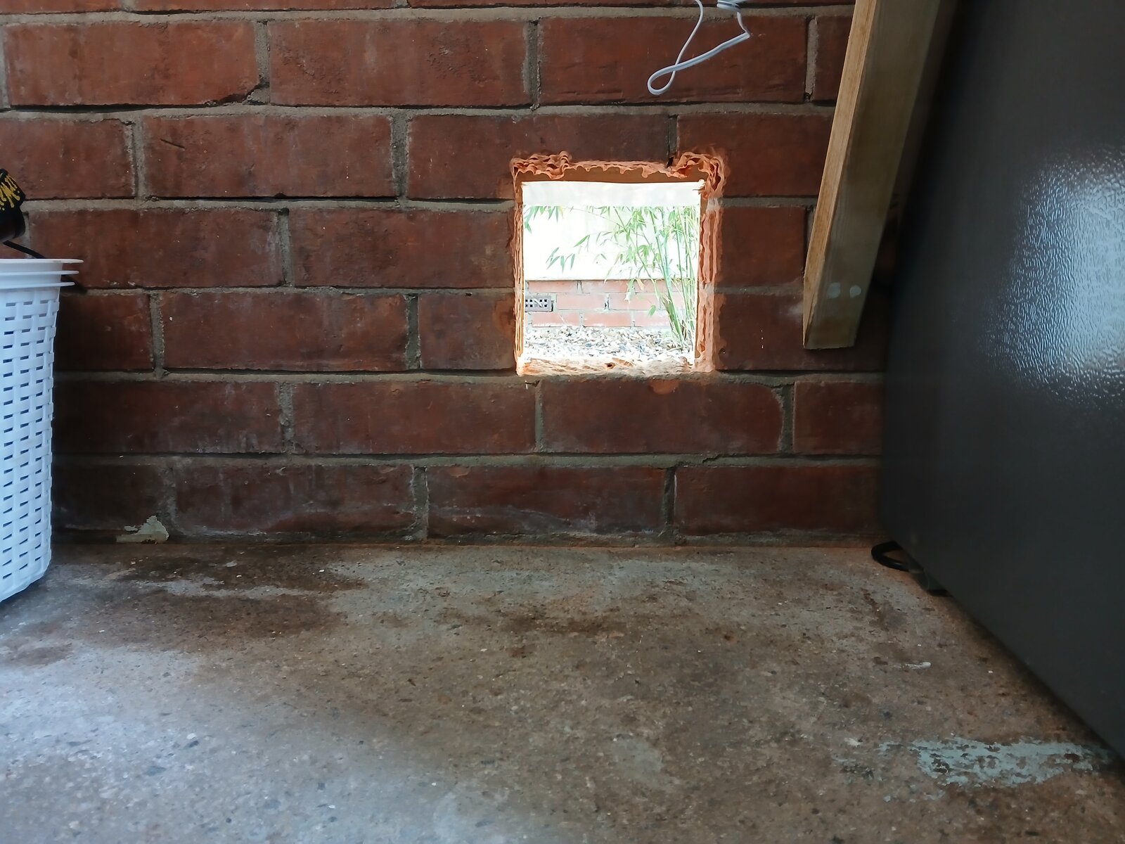

Cat flap cut through weakens single skin brick wall?

One thing is certain; an AI has never built a wall, nor knocked a hole in one. Dodgy foundations or not, if the wall is presently standing, putting a 200x200 hole in it will have no discernible effect, even if the hole were made right at the end of a leaf so there was only brickwork on one side of the hole it wouldn't fall down, unless the mortar is completely shagged and can be wriggled out with a pencil. Even if the foundations were made of sand, there would be no change, because a hole of that size just doesn't have a significant enough effect on the transmission of self-weight load down the wall. By the time you're at the bottom of the bricks on the row below the load triangle will have closed up again..
If you want to be ultra careful, you could look at hiring a large core drill and drilling through the wall (no hammer) - cat flaps can be fitted to round holes

So far so good. I put a card template to the wall and drew around it.
Stitch-drilled for about 2 hours. Hoover nearly caught fire...
Shout out to Bosch Expert drill bits. Sailed through with a corded drill (not on hammer). Honey combing every which way was a P.I.T.A. eventually with a 4 inch screwdriver it snapped the block out and fell in at me.
A multi tool with diamond head made it all very neat indeed. .....
And it was upside down.
Had to drill more to take off corners. Gutted.
So far, mine and neighbours house are still standing. Cat is not at all amused.

Do make a step on either side.
The cat flap needs to be at the height of the cat's head when standing inside on the floor. They can't slither on their bellies and slide out like a snake, they stand on their legs and jump through it. They like to look through first, to check for any neighbouring enemy moggies out there.
Measure your cat's height when standing. Make the top of the door the tips of their ears.
You'll probably need a step or ramp on the outside, at about the same height as the inside floor.
This hopefully solves your worries about cutting too low down, but it was never a risk anyway.
