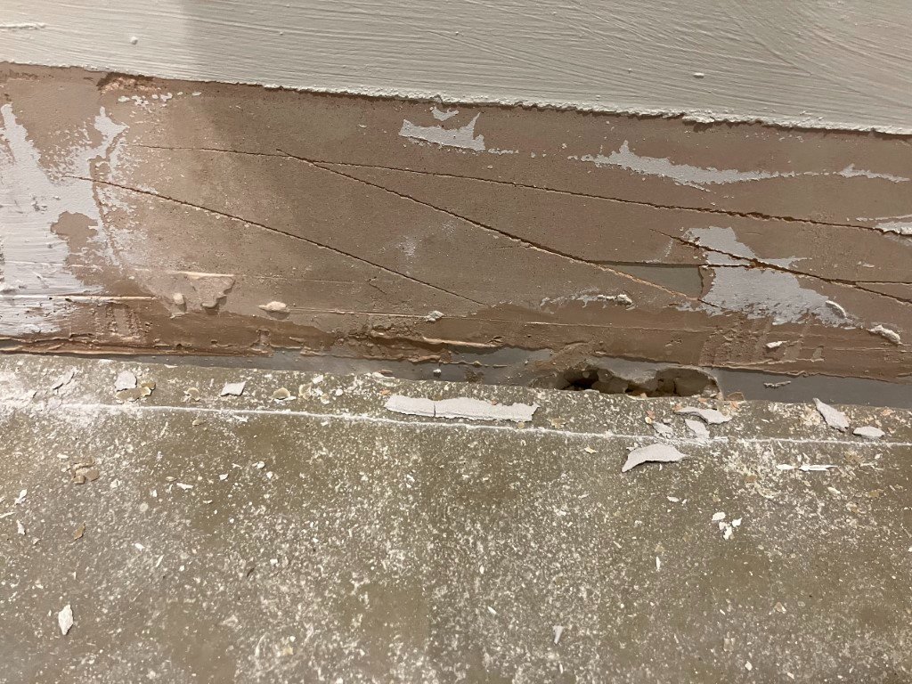

Hi,
I have had to remove some stone skirting from my wall which has left an ugly gap between the stone floor tiles and the plasterboard wall.
Bookcases are being fitted to the wall (couldn't be fitted around the skirting) so I won't see the gap but there's a bit of a draught. My first thought was to use caulk but the gap's pretty big - please see the attached image. It doesn't need to be pretty but can anyone suggest the best way of approaching this?
Thanks :)

Expanding foam is not really a draught sealant, but can be used as a packer before sealing with a flexible mastic or caulk. Or foam EPDm/neoprene strips as packing.
Mm, it depends on how it's applied. It can fail to expand and leave holes. For newbie users I'd recommend to damp the surfaces slightly first, then slightly overfill the gap and trim back the excess rather than try to gauge how much it will expand and risk not applying enough
Dare say with what is posted in the picture though I'd be buying a bag of easyfill and a plasterers trowel

It's a gap filling product, and is not something that would be specified for draught proofing. Something to do with the air voids within it, the inconsistent volume and lack of flexibility.

If you have a narrow gap and air is whistling through the gap and you fill that gap with ex-foam - air won't get through.

Expanding foam and/or mastic will deal with the gap for air tightness. Grouting is pointless.
All gaps need to be sealed to prevent air leakage. Use expanding foam, then plaster over
Most expanding foams are closed cell.
In the past I have used them to block both air flow and water ingress.
I am not suggesting that they will hold back an olympic sized swimming pool of water, but using using them is not necessarily a bodge.
