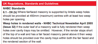

Render isn't impermeable so a small amount could escape over time. If render were impermeable, presumably water wouldn't get in so it would only be condensation anyway.
Even Encon, who have an incentive to sell more weep vents, say there's no need in rendered walls:
https://www.encon.co.uk/sites/default/files/products/downloads/rytweep_datasheet.pdf
Down here we can take quite a pounding from the weather and a rendered cavity wall can still get driving rain penetrating to the cavity.
I would not want to risk omitting the weep holes, otherwise, even with stop ends, the water is likely to spill off the ends of the cavity tray and you can get damp patches either side of the opening. Who bothers with stop ends or turns up the end of the tray these days?
