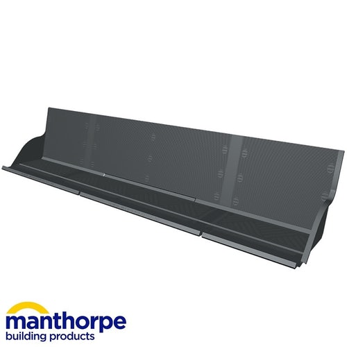

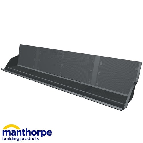

I think he's talking about these...
With the trays you are talking about, they are just placed under the bricks on the outer leaf and have enough "flap" to catch moisture dripping down the outer wall or from the wall ties. This is where the moisture is going to come from, not the internal wall; why would you have moisture dripping down the internal wall?
Using DPC it is built into the inner course to hold it in place.
Yes they are the ones i was on about. I didn't realise they were just for catching moisture thats found it's way in through he outer wall and tracked it's way down the cavity or what's dripped off the middle of the wall ties. As I've only used stepped DPC before apart from it fixing to the inner leaf to hold it in place, i thought it may find it's way down behind it but now you've explained this would probably only happen if the top of the cavity wasn't closed off or that cheap insulation blown in allowed it to track across.
