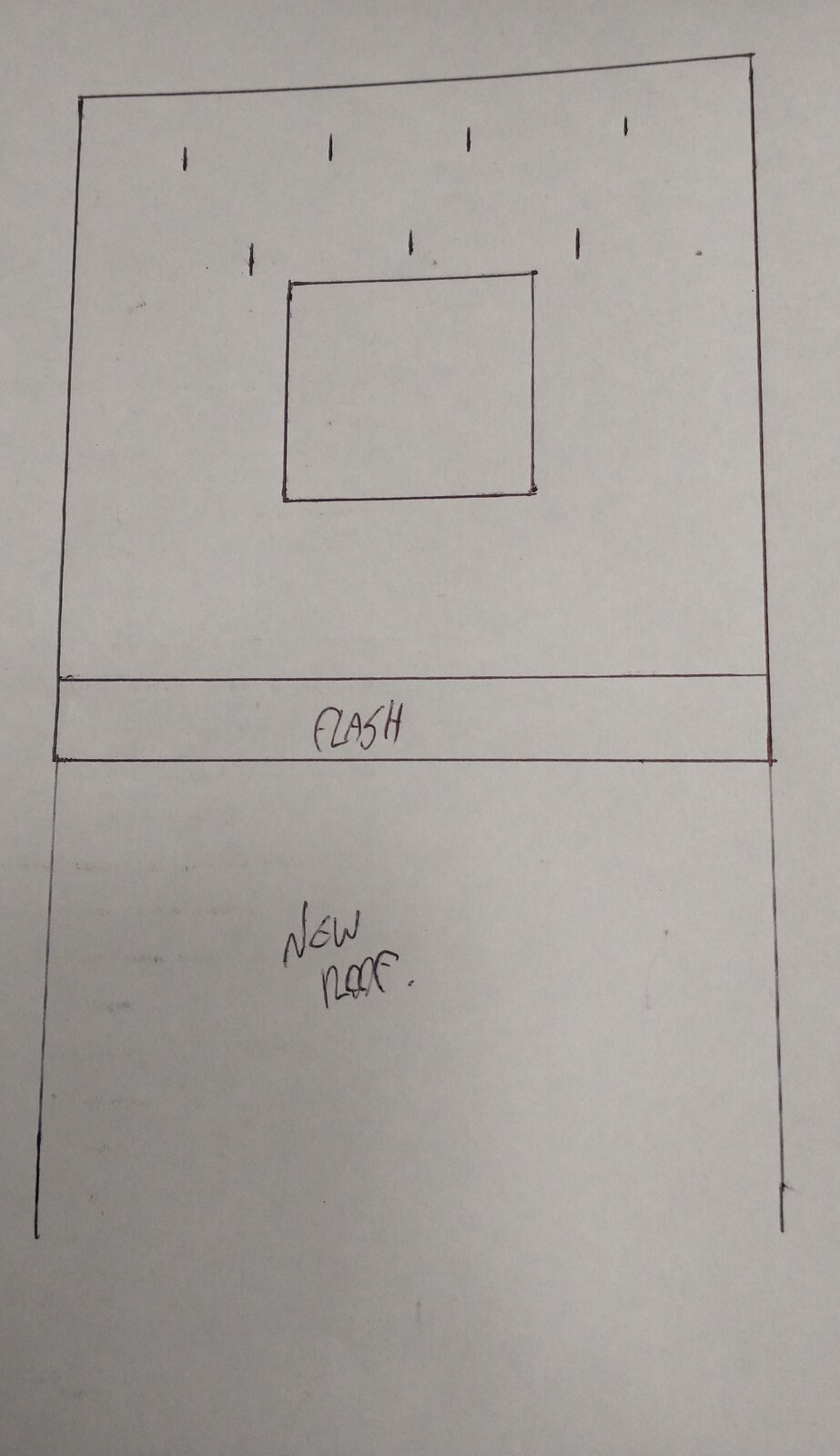

About 2 years ago i moved into a house built in the 80s which has had an extension built. Within the first 4 months of living there we had a huge leak onto the ceiling of the extension.
A couple of builders and lots of investigation later a new flashing was installed and the leak hasnt happened since....until recently.
Now it's not even on the same scale as last time which makes me wonder if it's the flashing or a lack of cavity trays?
Excuse my 2 minute drawing but I've put a line where I can see weep holes on the original wall ( the square is a window)but there isn't any where the flashing meets the wall? I can tell they have been fitted as you can see where the bricks have been removed.
Obviously I don't have original drawing or plans as I didn't build it but is there any reason why they would not of put these in?
It only seems to happen in strong westerly winds.
Many thanks

Would you say a small stain on the ceiling rather than massive amounts of water are more representative of lack of cavity trays?
What are my best options? Installing cavity trays is obviously a given but is this something most builders will do? I got images in my head of the wall falling down :eek:
The pointing is abit patchy in places so I was going to refill those when it's better weather which obviously won't stop the problem but it can't make it worse right?
The pointing will be a good start, especially the perp joints.
The trays are installed by removing 1m sections at a time.
