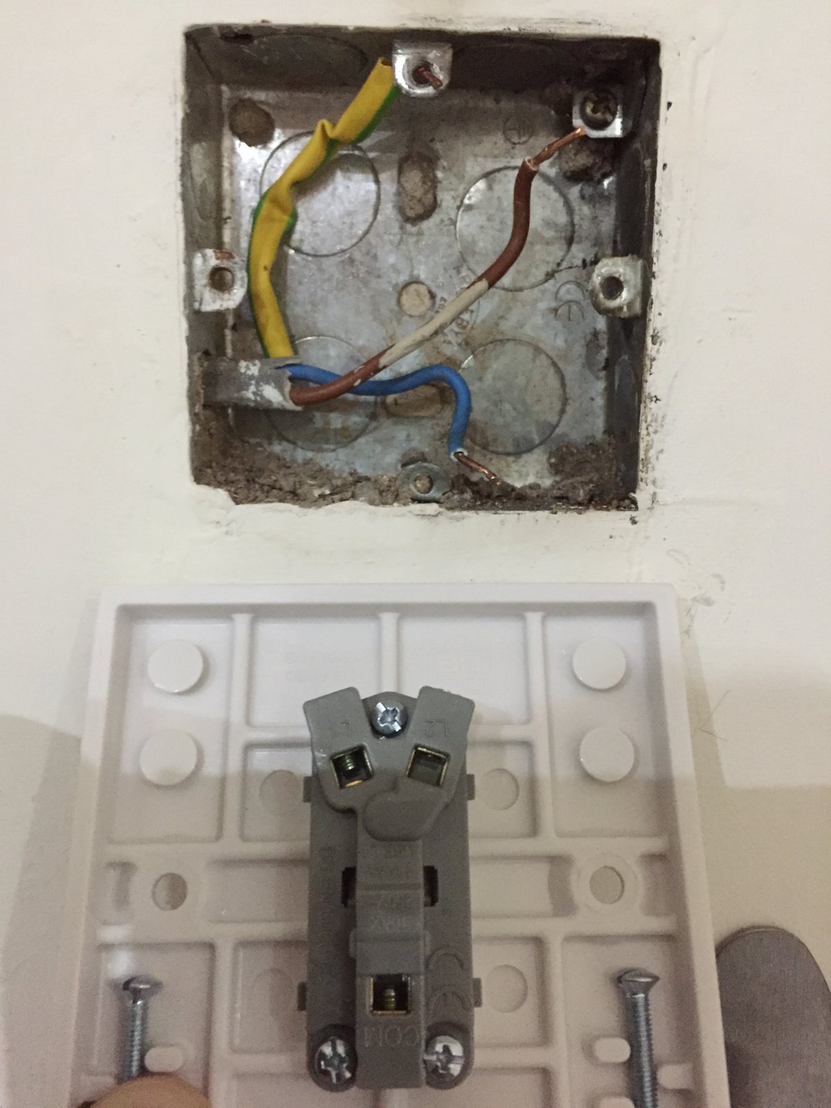

I don't know much about electrics, but I just replaced a security light outside my front door.
The old one was activated by a normal thrower switch on the inside of my door.
Recently, my wife flipped the switch on the inside (while the security light was not connected on the outside) and the CB popped. So I removed the inside flip switch.
Now I have attached a security light on the outside and it works without there being a switch on the inside. It works with PIR.
But, when I connect the wires inside with a new flip switch, it blows the CB again.
Any idea what I should do?
JH

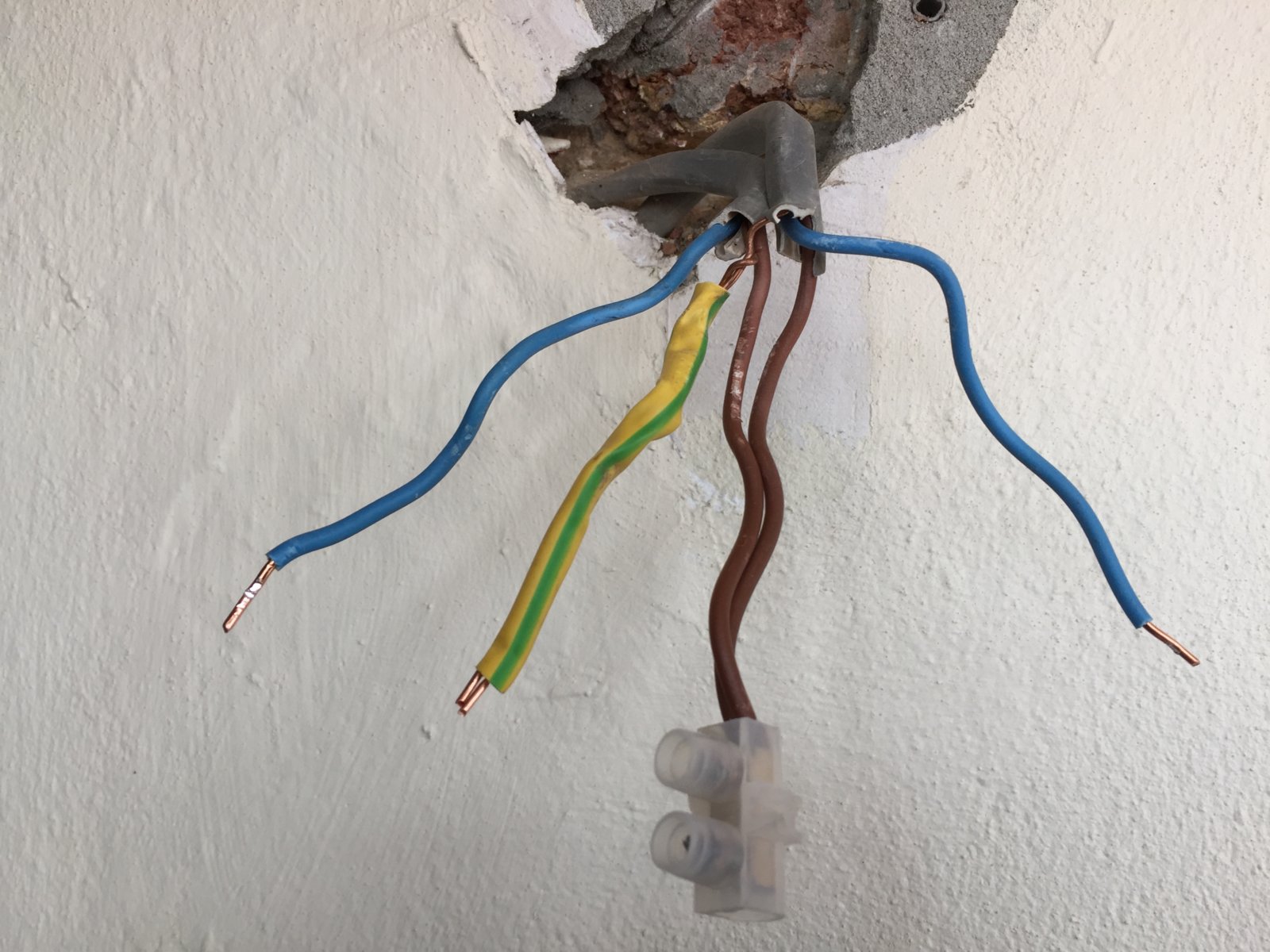

It has a Double Brown, a Double Blue and Earth wire on the outside.
On the inside, it has a Brown, Blue and Earth wire.
I connected the Brown Wire to the Common port and the Blue Wire to the L1 Port and I just wrapped the Earth wire to the Back Box. Then I flipped the CB on and that's When it Blew.
That's correct.
Not sure what that means.
Connect them both to the back box - screw top right in picture.
If you mean the CB trips with the outside wires loose as in the picture then you must have a fault in (one of) the cables.
The light L and N should each be connected to a blue wire. Is that what you did?
You will have to determine which blue is which, can't tell from here.

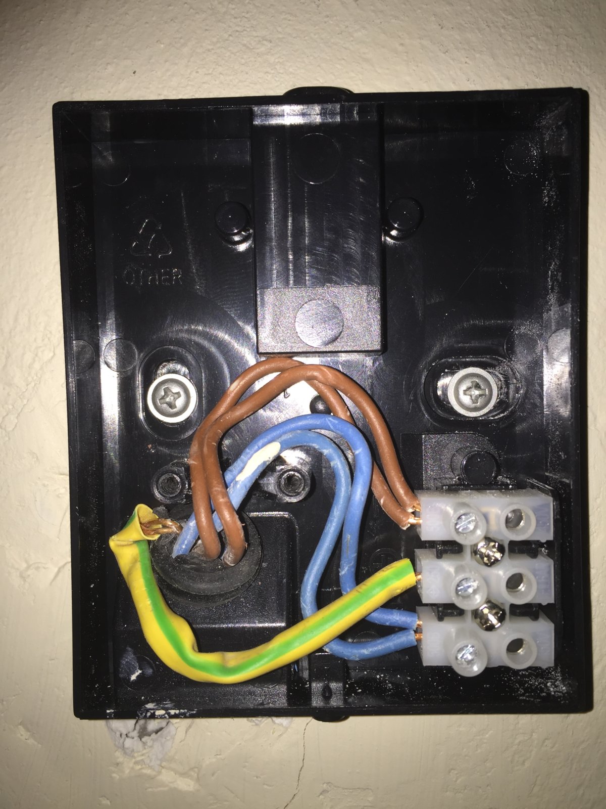

Look at the "Before" image. This is how I connected it. I suspect that it's wrong since you are saying that I need to connect the 2 blue wires without connecting the brown wires.

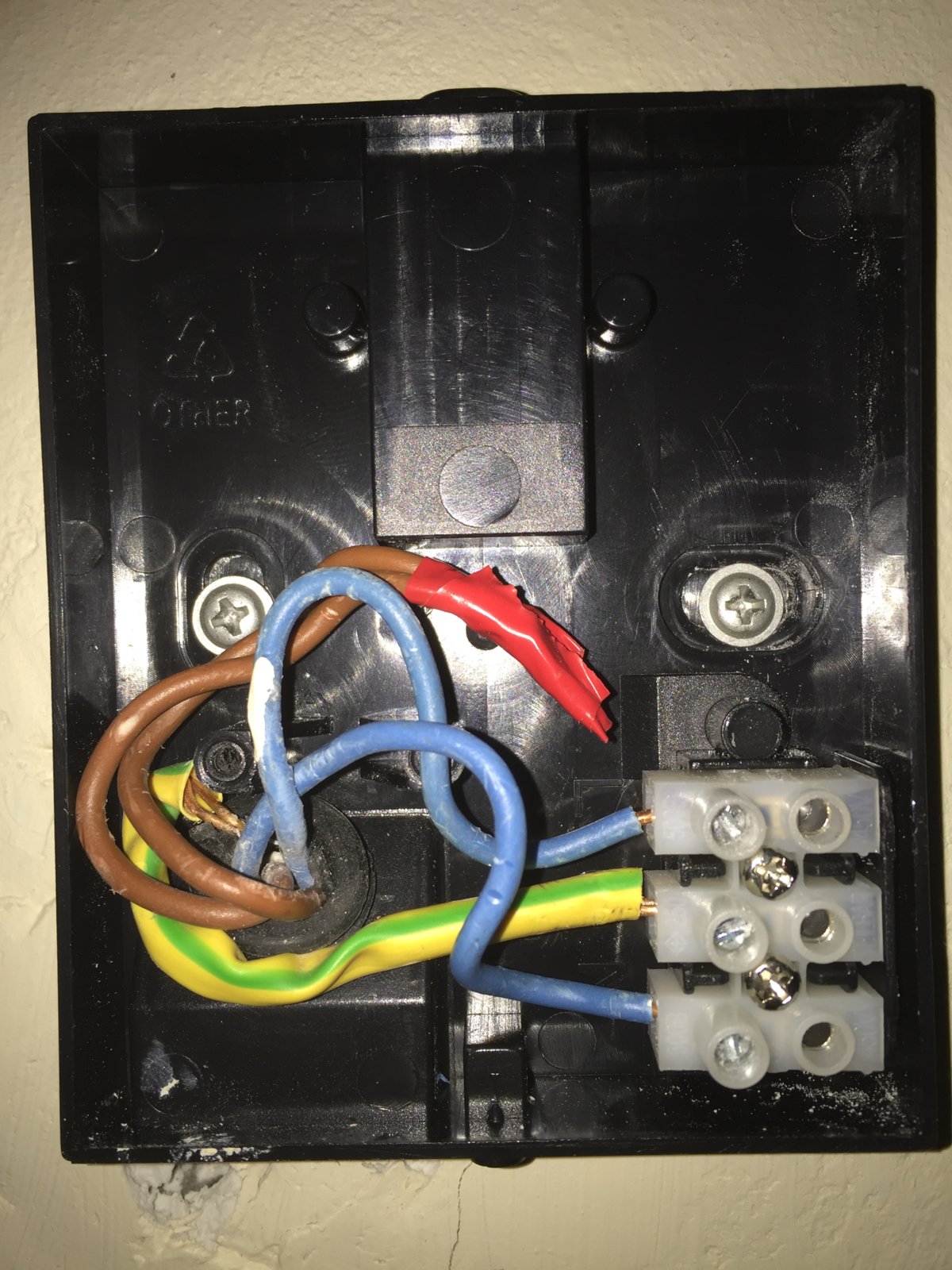

So then I changed it (After image). I taped up the brown wires and connected the 2 blue wires instead, but then the light didn't work after putting the CB back on.

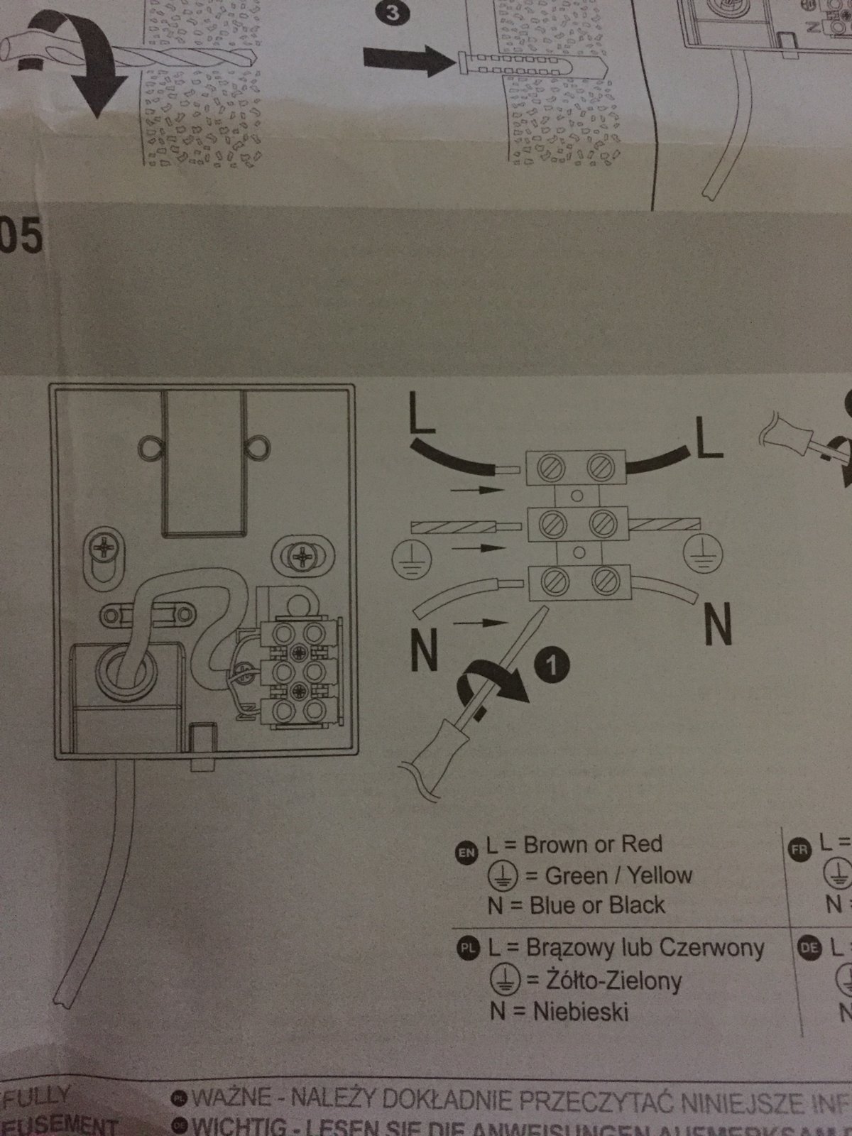

According to the attached Diagram, I seem to have connected it correctly first time.
What am I doing wrong?
It was wrong and why the CB tripped - see if you can work out why.
Put them back as they were in the outside picture -
I see no diagram - but no

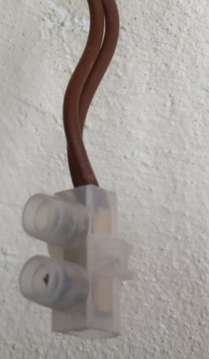

Are you saying that I need to connect the 2 brown wires into that plastic casing rather than taping them up with red electrical tape?
And leave the 2 blue wires connected with the L & N terminals?
Diagram attached.
Yes, they must be connected together.
Yes.
Diagram attached.
The diagram does not have a separate cable going to the switch.
