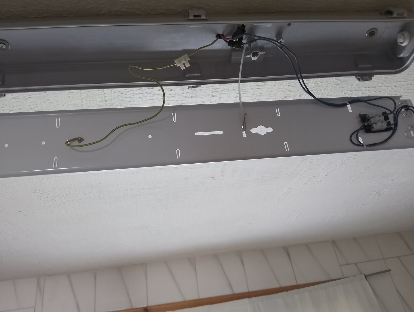

I'm putting up a ceiling lamp. There's no previous photos of what the wires connection layout was before. Nothing else in room like a fan etc, just a wall switch to operate it.

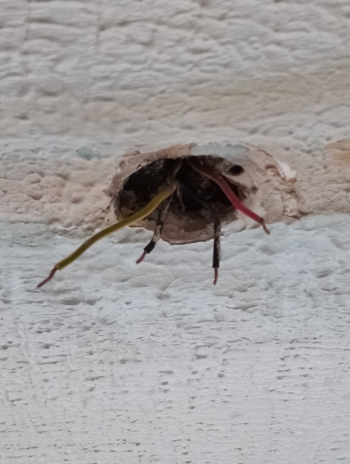

Ceiling wires has two black, one red and one green/yellow.
The bathroom light is not operating either although it was before disconnection of the wires in question.
New lamp has a brown and blue wire into it's own separate connector block and I've added a small nut, bolt and washer on the metal inside the new lamp in preparation for the earth.
With a bedside lamp I've identified the switch cable (black) and marked it with red tape. There's also 2 small ten centimetres long wires (a blue and a brown) not connected to anything but we're involved in it's successful operation before. I have new connector blocks to aid in the fitting.
I'm looking for advice in what wires get connected to what?

Where are the" 2 small ten centimetres long wires" ,and what were they connected to ?
Where is the second black wire connected ?

The power is off and there are no wires from the ceiling connected to that lamp, that mock photo was just to show the type of lamp. Photo taken with no power on and any ceiling wires are now hanging out the ceiling hole attached to nothing.
So your pictured light fitting is not the one you are going to fit ?
I don't really follow your info re the bedside lamp being used to establish the switched live is black ??
I suspect the 2 black wires are neutrals and the red wire is the switched live,but you would need testing equipment to confirm this.
Do you have any voltage measuring instruments ?
It's dark, in the morning I'll go back and lay all the pieces out unattached (small wires,lamp,blocks) and a ceiling photo of the hole showing 4 wires with one of them marked with red tape.
But how did you use the bedside lamp to establish a black wire was the switched live ?
The lamp in the photo is the new lamp to be fitted.

Bedside lamp, I put one black and the red wire to determine the switched live.
Ok the lamp worked with one red wire and one black wire connected to it. Which it would do if the red wire was live and the black neutral.
