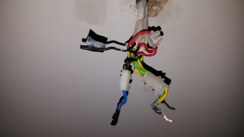

We've recently had our hallway and ceiling plastered and naturally had to remove the ceiling light. Everything came away OK but i uncovered a bit of a mess.
We wanted to replace the existing fittings with some new lights but because of the mess of wires that we have, i cannot fit the new light fitting. We have 3 T&E poking out of the ceiling and a bunch of terminal blocks for the loop, earth and switched live. The combination of wires and terminal blocks are constantly fighting with the light fitting so i'm at a bit of a loss.
Any advice would be much appreciated. Thanks in advance.
I see 4 T&E :p Not the worst arrangement I've seen though. If you new fitting doesn't have space to wire in multiple wires and therefore removing the need for the connector blocks, then try and tidy up the wiring so that you can gently flatten the connectors to the ceiling so that the new fitting fits over them or even better see if you can push them all above the plaster. Replacing the connector blocks with something like wago connectors might make a neater job and help with space. If not just make sure the connector block terminals are tight and no exposed cores (e.g. that neutral one). And assuming that single black is the switched live, add some brown tape to it.

Although you have an additional cable, which may be providing power to something else, may be another light, or a smoke alarm perhaps.
From the wiring in your photo, the single black with the tape on should be the switched live to the light, the two blacks in the connector block will be the neutral to the light.

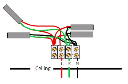

Would consolidating all of the existing wires into a single terminal block be acceptable and then take single L/E/N wires off this terminal block to the light fitting?
Yes you can use a single connector block (with separate terminals as per the diagram) instead of having them all separate (as they are now), however this might make it more difficult depending on how much space you have in the light fitting/ceiling hole.
Yeah, the switched live in the photo is black (and should have some brown tape on). I coloured it red in the drawing by mistake.

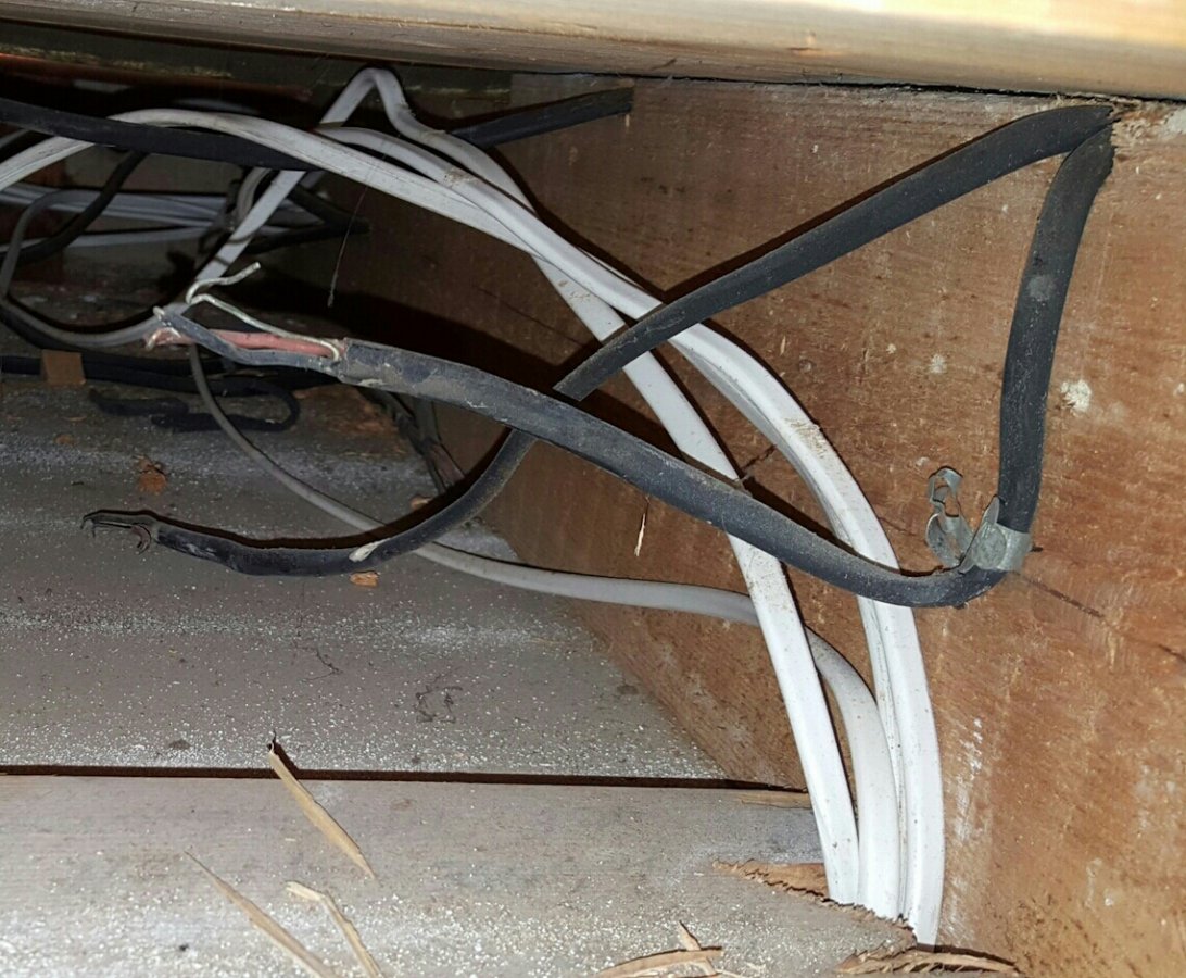

Anywho, i decided to take a peak under the carpet upstairs and hey Presto, the boards have been up for previous work and were only screwed down. I now have great access to install a junction box and tidy everything up rather than mess around trying to tuck cables back up.
Can anyone recommend a junction box that will take 4 inputs and 1 output? Thanks.

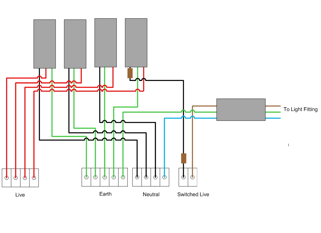

Ok, i think i have got my plan together. See attached.
Just as an aside, i like the look of the Wago stuff. Can anyone recommend i.e MF rated?
As per my drawing, i could easily buy a 1 x 2 way, 2 x 4 way and 1 x 5 way Wagos and a wagobox making everything nice and tidy and easy to fit too.
