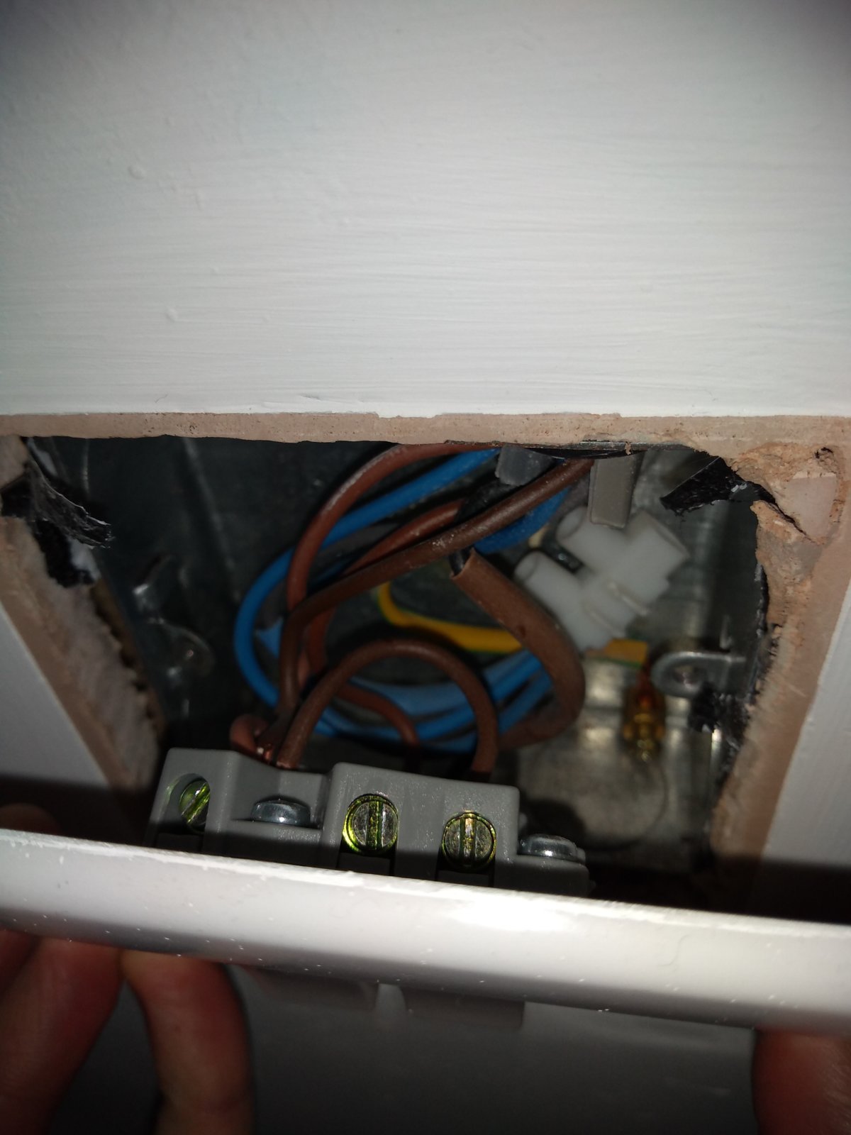

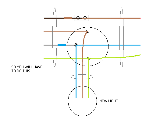

Hi all,
This is probably one of the most annoying requests ever but just want some advice with regards to fitting a new light fixture. I unscrewed my plastic rose pendant when I moved into my new build, and took a photo ready to fit my new metal light fitting. Fast forward three months and I loosened off the wires ready to put up a new metal fitting and realised I must have deleted the photo of the setup...doh....feel so stupid. It looks relatively obvious. I have a terminal block with 3 connections in the light fitting, I do have a spare terminal block. I'm not 100% on which is the switch live from the ceiling....god damn it. The photo shows a bit of the confusion, two cables, each with an earth that goes into one (never seen an earth like this). Then I have 3 brown but all of slightly different brown colour! One has a black wire with brown sleeve so will assume thats the switch live but what's the grey with blue sleeve? Never seen that before. With my 3 connections in my light fitting I will assume I must use another terminal block to put the lives together? Am I thinking correctly? I am a little worried because when I took the fitting down the fuse tripped and yet the downstairs lighting circuit was off. I only think the earth and neutral wires touched...enough phantom voltage to trip the switch?! Any advice on what goes where would be appreciated.
The Grey with the Blue should be a Neutral, EFLI will be along he's a whizz with lighting. Is there another light in the Circuit or two switches though
Hi, yes there are two lights in the room controlled by one panel, two switches. With this one disconnected the other light fitting does not work so I have assumed end of loop.
Can you see the other end of the twin and earth cable inside the other ceiling rose?
And, does the triple and earth cable go to the the switch? Photo of the back of the switch(s)?
I fitted another light to the other ceiling fitting, simply live, neutral and earth so easy job. I can't get a picture of the switch at the moment though so I can't be sure the triple goes back to the switch.
Good. You will need it.
I'm not 100% on which is the switch live from the ceiling.The photo shows a bit of the confusion, two cables, each with an earth that goes into one (never seen an earth like this).
All earth wires should be joined together so not exactly sure what you mean.
Well, two browns and a black with brown sleeve.
Very likely - one of them.
The blue sleeve signifies Neutral - if correct.
They only give you the minimum.
However it does not look like a loop at ceiling arrangement so presumably is loop at switch.
That will be an RCD and they do trip if you touch N & E.

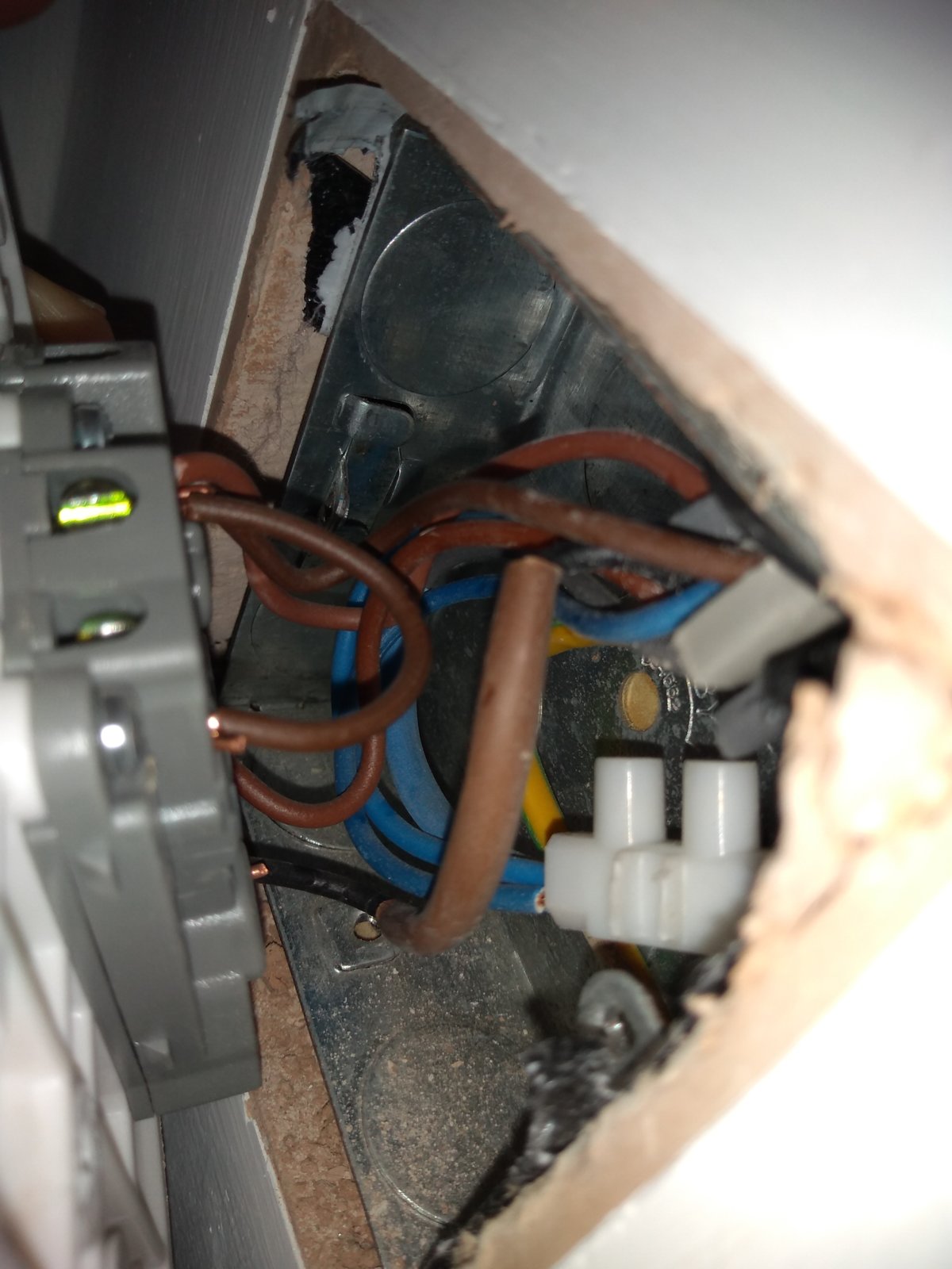

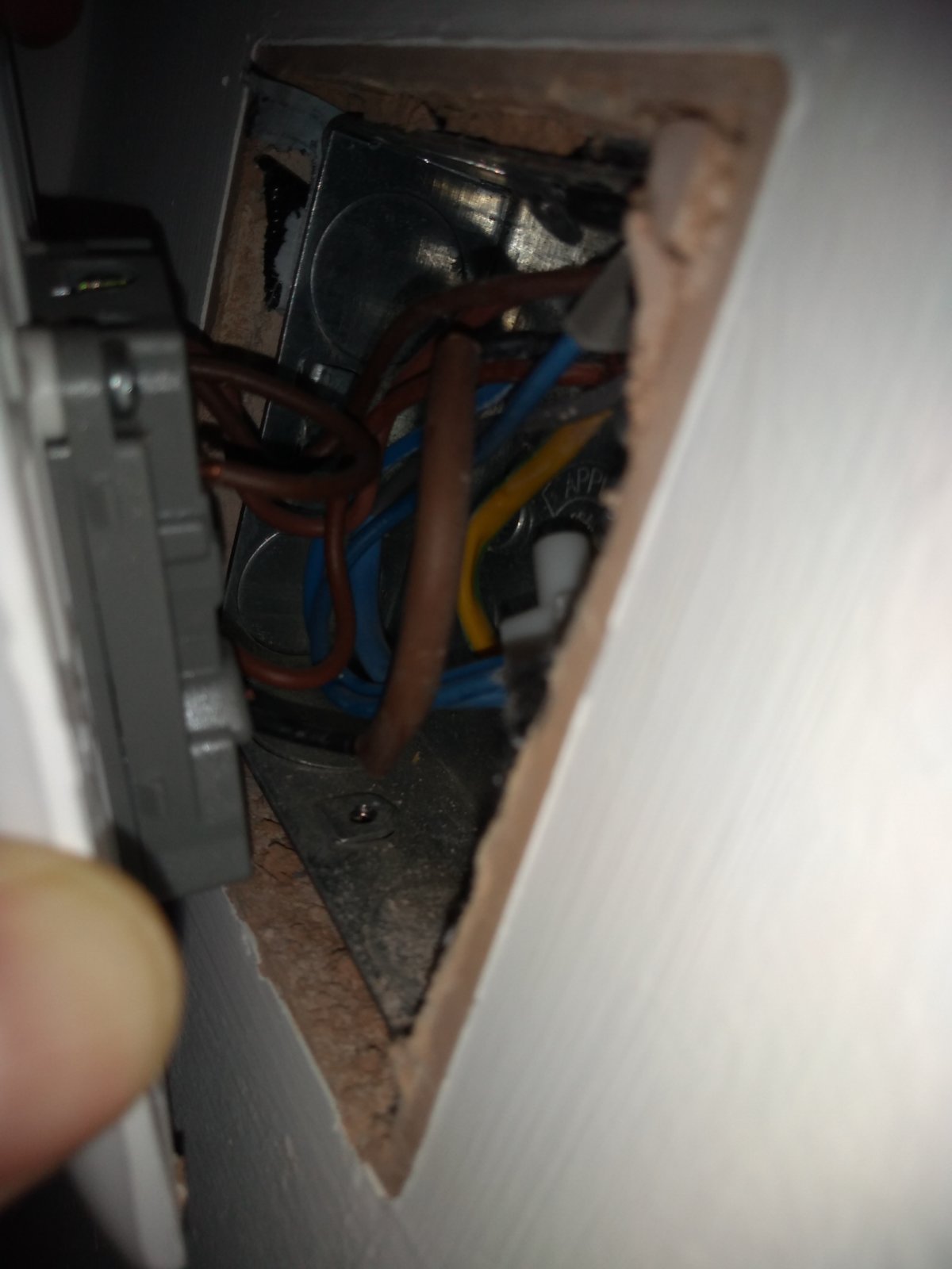

It looks pretty obvious, but we had better wait for picture of the switch wiring first.

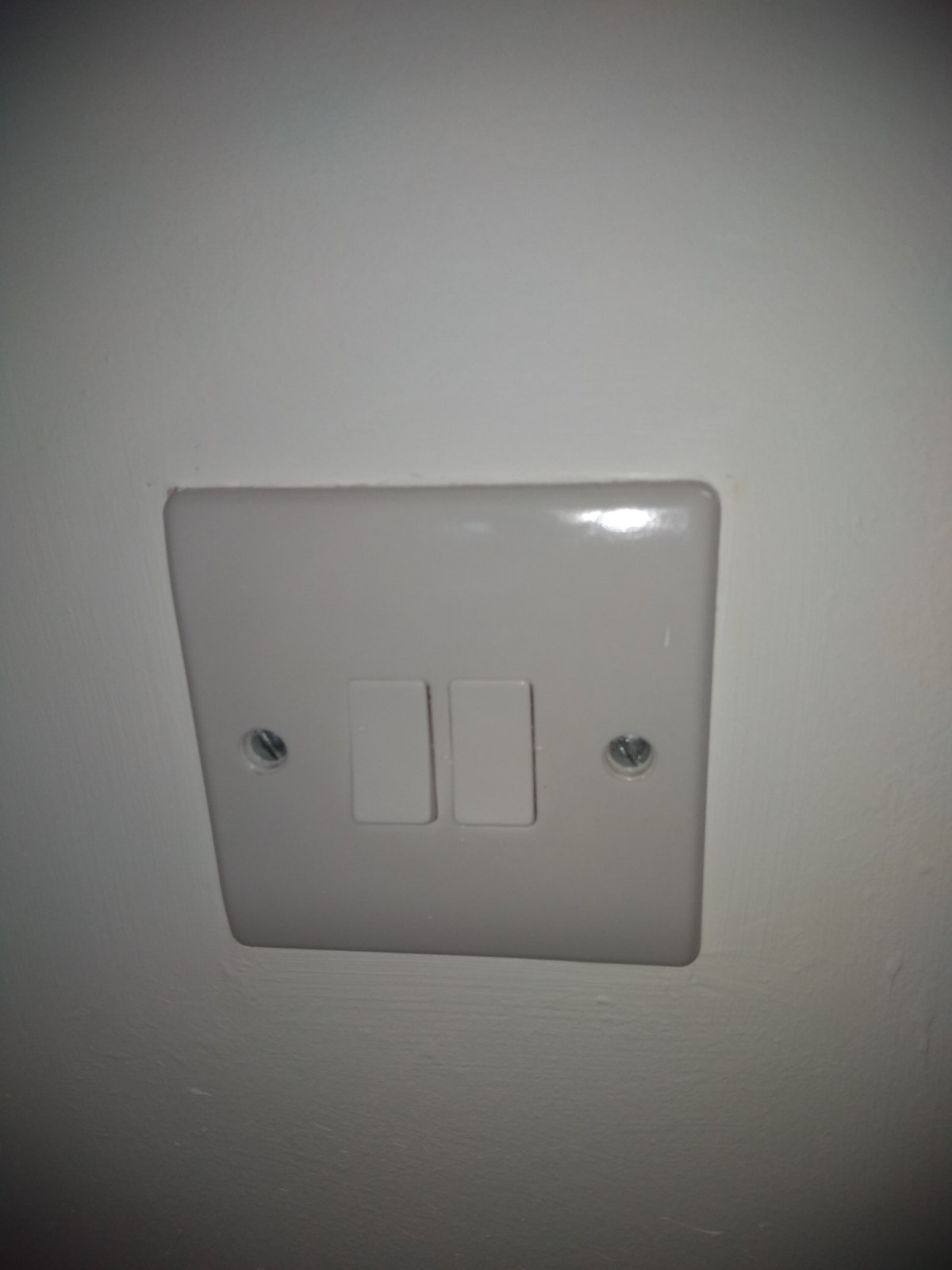

Hi all. Thank you for your replies. Here is the switch photos as best as I can take them.

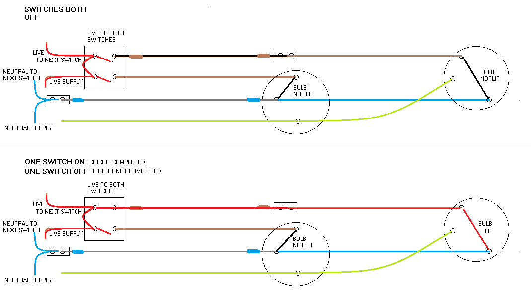

So, do you think it is the same as my diagram?
You should try and learn how it works so it makes sense - rather than just be told which wire to connect where.
Can you see how it works from my diagram?

In your picture, the LIVE SUPPLY and LIVE TO NEXT SWITCH (i.e. next room) are both in one switch with the link wire to the other switch but it makes no difference.

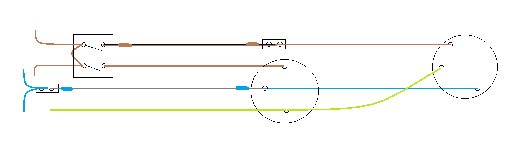

I did do another diagram but see I forgot to send it.
Anyway - was it right?
Hi, yes that looks correct. Not rocket science but I was still unsure and shaken by the tripping of the fuse when earth and neutral touched...which my neighbour had exactly the same...both of us had our downstairs circuit off but I guess if there was enough residual voltage in it could trip a 5amp fuse. Failing that I'll get Miller homes in to ensure its wired correctly in the first place! Yes that junction box is what I was thinking, seems safe enough to be above the ceiling, or I could go with wago connectors which I've heard are really reliable....
Touching Neutral and Earth will trip an RCD/RCBO but not an MCB and definitely not a fuse so not sure what happened.
Yes Wagos are fine but they must be in an enclosure - Wago Box.
