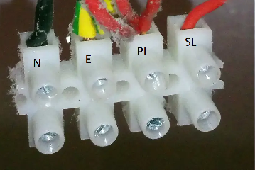

'BLUE in the left connector; BROWN in the right. '
So am I going with this then? (Yes it is brown and not red).

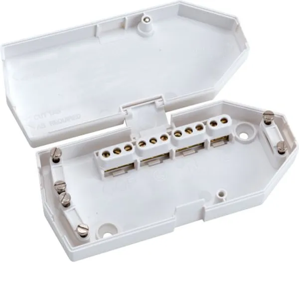

Marked N for neutral, E for earth, PL for permanent line, and SL for switched line. You don't need to take PL to the new lamp, but often swapping the connector block in the new lamp for one with the extra connection is the easiest way to deal with the PL wires. There are special connectors 1714818093037.pngto allow you to convert from three cables to one before the lamp, note there are cable clamps as well as terminals, also there are maintenance free versions,
up to you what method used.
If your ceiling rose has four terminals, I‘d suggest moving the connections from the current choc block to the terminals built into the ceiling rose. Having single-insulated wires and loose connectors pushed up into the ceiling doesn‘t really conform to the regs.
Use a sharpie to label the three red wires that are connected together in the current setup and reconnect them as they were.
