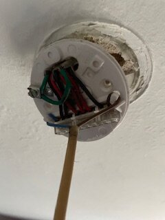

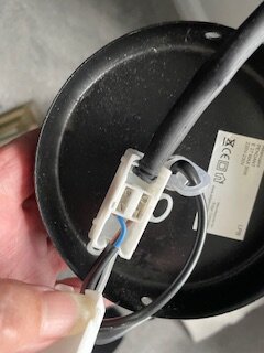

I have bought a metal pendant light fitting with a bracket and two core wiring screwed into a connector - how do I connect it to the ceiling rose?
Probably safest to put up a pic but if the core is the pendant wiring, the brown wire to the part of the roses marked line, the blue to neutral. If it’s metal rather than metal effect it should be earthed as well.
The existing ceiling rose and the new fitting

It is metal, but the fitting has a square in a square symbol, so I think it's double insulated.
You'll have to put all the connections in a junction box above in the ceiling and drop a 2 core flex into the light.
Also it has to be connected in the connector block/case supplied to keep the class 2 rating.
Thank you! Blimey I thought it would be easy, apparently not. :(

I would/have used Greenbrook lighting connectors for similar situations.
The large connector has a loop terminal for the three reds.
The plug in connector can join straight onto the pendant wiring, maintaining the double insulation.
The only caveat, is a slightly larger hole in the ceiling may be needed to poke the connector up through.
They are also really useful for heavy fittings on high ceilings where you don't want to be balancing it on your head and connecting up terminals!
