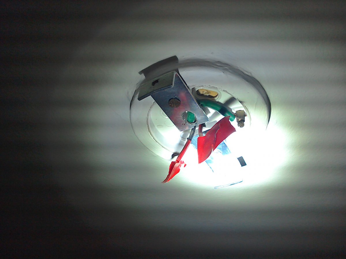

Hi, I'm replying to an old thread as it was the closest I could find to answering my problem (although I'm sure it has been asked since). I have a metal light with the usual two wires, plus an earth coming from the flex cable, plus an earth connected to the metal casing separately. Do I need to attach those two earths to each other and then to the earth coming from the ceiling?
By leaving the plastic patress on, you do realise the fitting will not fit flush to the ceiling
I do, yes, thanks. I had to cut the metal bracket into three and discard the middle bit as it was from another light and was too wide, so wanted to check the holes I had cut were in the right place.
Can I just screw the two earth wires from the light into the metal bit where the green/blue wire from the ceiling is attached or should I use a plastic connector block?
Either really, if they will all go in that earth post fitted to the plastic patress thats fine, earth terminals do not need to be insulated.
