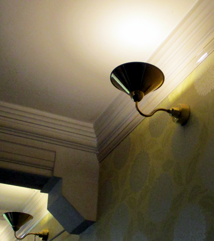

I have a lot of them (brass ones) in my house, installed 30+ years ago (when I moved in) - when I, too, bought a large 'job lot' at a very good price.
As you say, they are excellent. I don't only use them on ceilings, as intended, but also on walls for uplighters...
