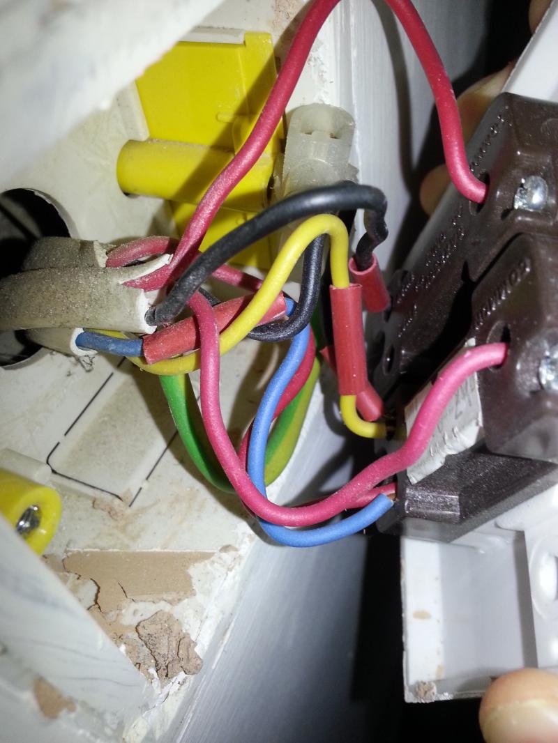

I learned that Brown is L1, Grey is L2, and Black is Common.

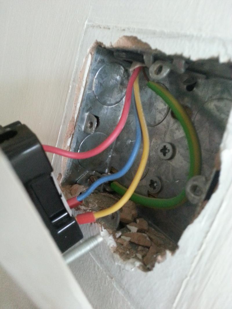

The switches are wired as would be expected.
However, as you will have noticed, there are no brown/blue cored cables there.
Therefore the switches are either wired from another light or there is a junction box somewhere to which the pictured light is connected.
