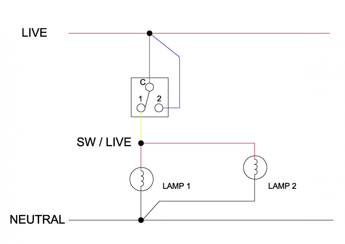

Based on your photo of the wires at the ceiling rose, and your description of how it functions, it could be wired like this:
As you haven't given the switch information as requested previously by iggifer, I have have had to ignore the second switch for now, but it may well be relevant. This drawing also assumes that the cables shown in your photograph entering the ceiling rose left to right are:
1. L&N to/from supply
2. L&N to/from supply
3. L&N to second light fitting
4. Switch wires
If so, here's what would happen.
With the switch in position 1, lamp 1 is connected across live and neutral and is lit, whilst lamp 2 has a live applied to both sides and so is off.
When the switch is moved to position 2 it removes the switched live. At this point Lamps 1 and 2 are connected in series across the live and neutral thus sharing the voltage between them, and being dimly lit.

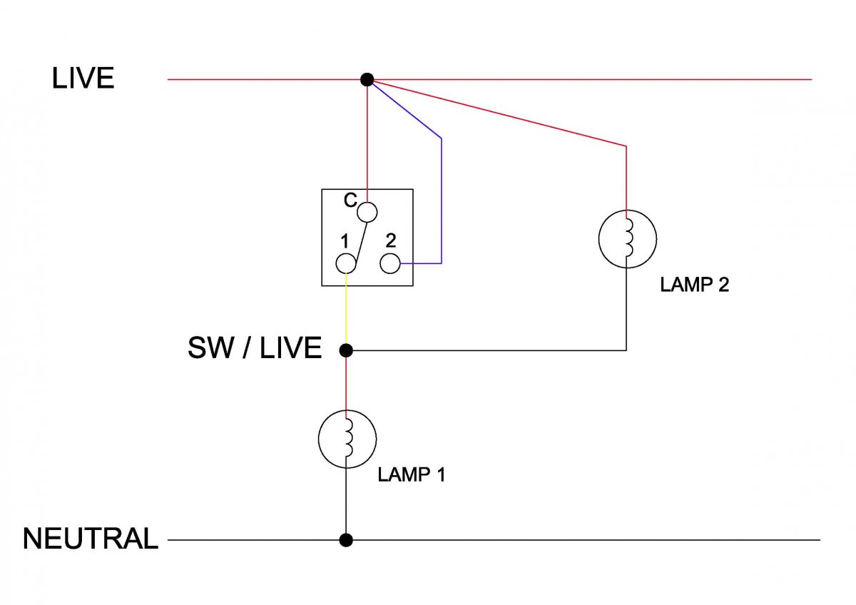

It may be simply that the wires to the second lamp are wrongly connected and just need changing as below. But this is only theory based on limited information lacking details of the rest of the circuit, so will need checking by someone competent and with knowledge of the entire circuit first. Also it is odd that two of the switch wires (Yellow, Blue) are connected to the same terminal at the ceiling rose, one may be disused as securespark suggested, if indeed they are the switch wires as we suppose.

Hi sorry I meant that there wasn't a light fitting attached to the ceiling rose. The photo I sent first was how it was when I moved in. I have now moved the wires in accordance to the image above.
But one light stays on all the time. The ryb cable is for a burglar alarm is believe after chasing he wires.
