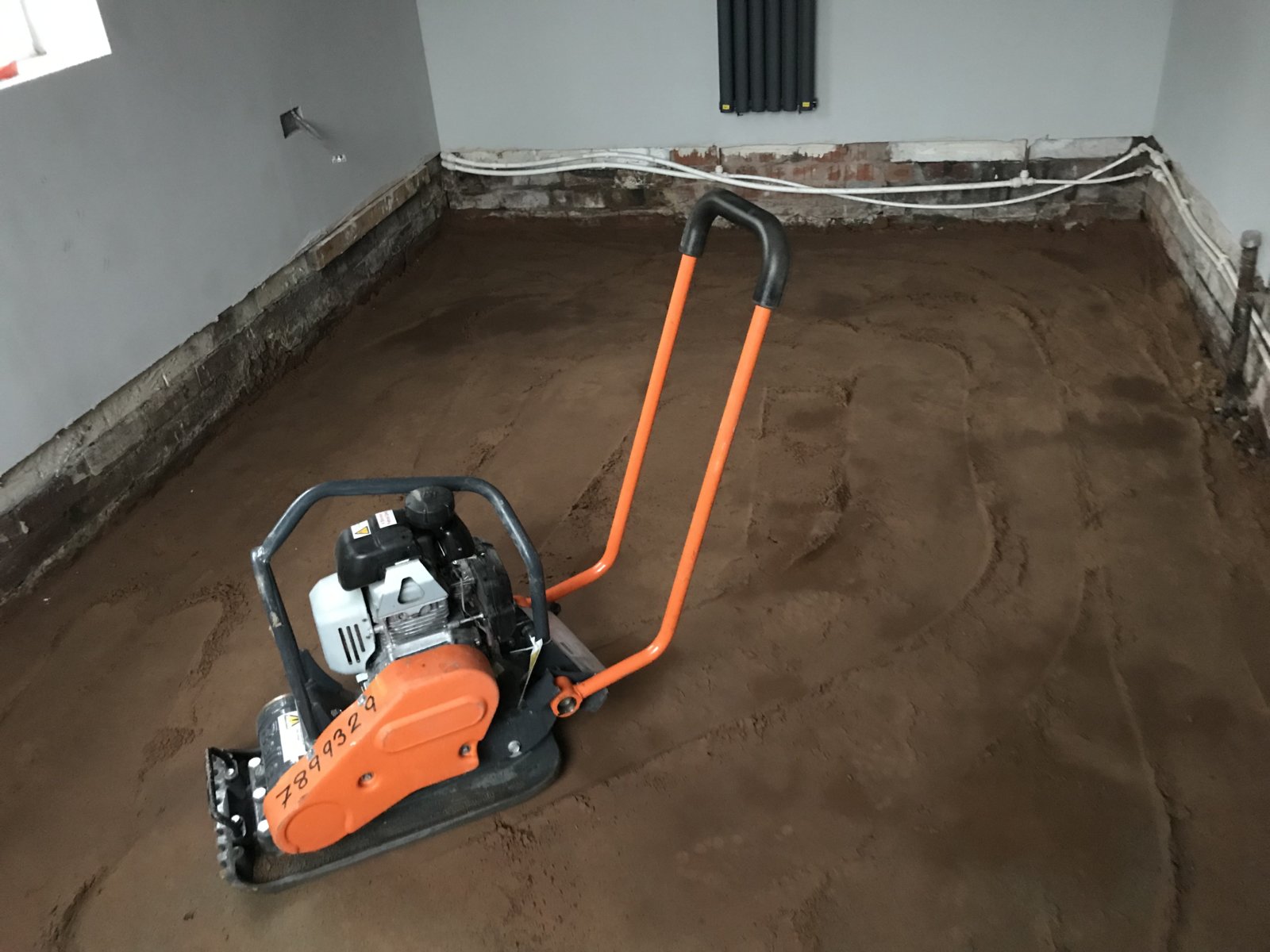

I've now got it all dug out. Can anyone tell me what the best type of hardcore and Sand is to use as I've read there's different sorts. Thanks.
Mine was solid and stony so I just used sand. Some building, some grit because that’s what I had knocking around.
I was going to put 2" of hardcore and 2" of sand. Wondering now after what you've said if I can just double up the thickness of sand and not bother with hardcore. Cheers Ian.
You might be able to wack 4” of MOT down smooth, that might be better than thick sand.
Mine was only maybe an inch thick

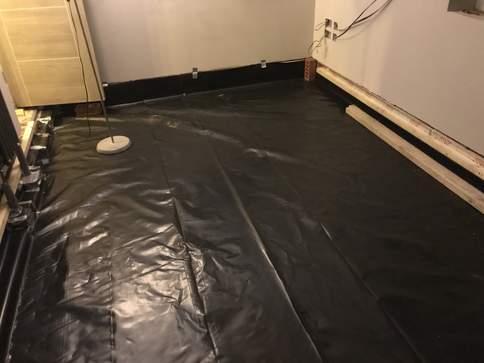

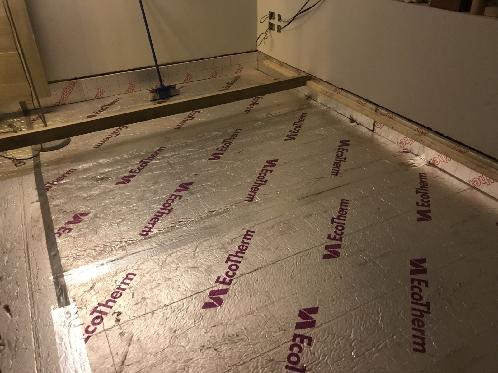

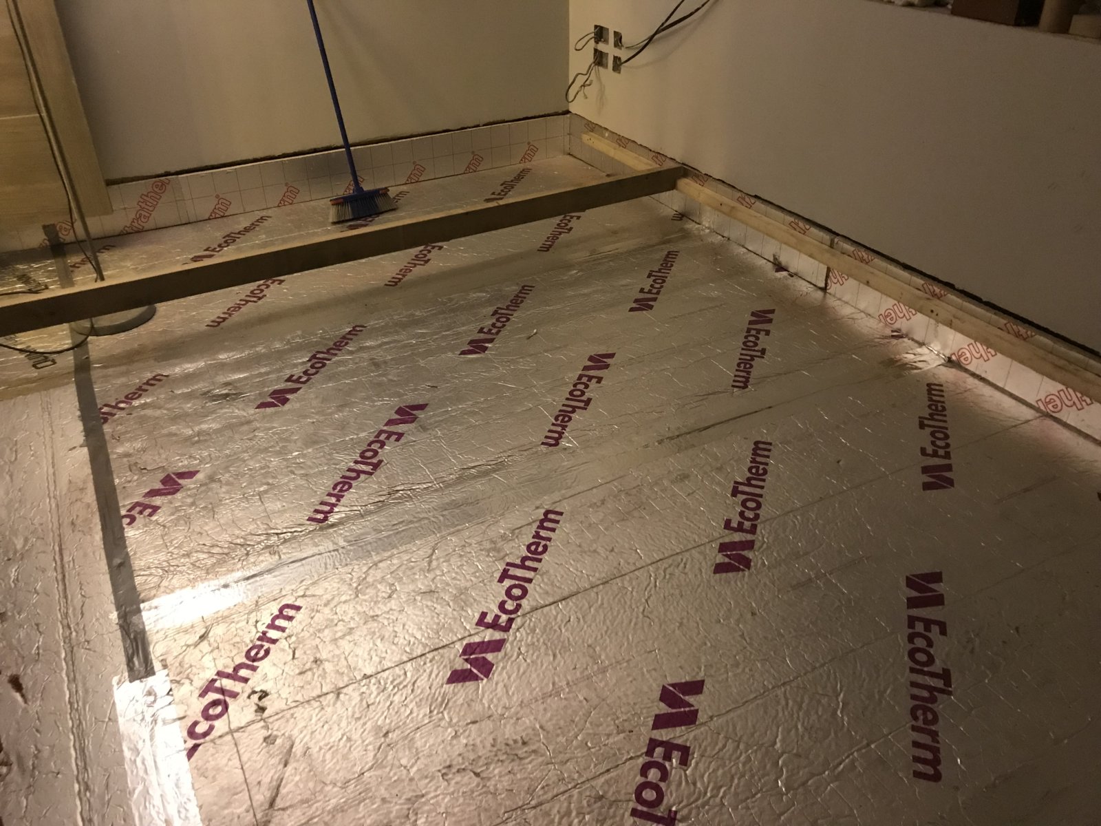

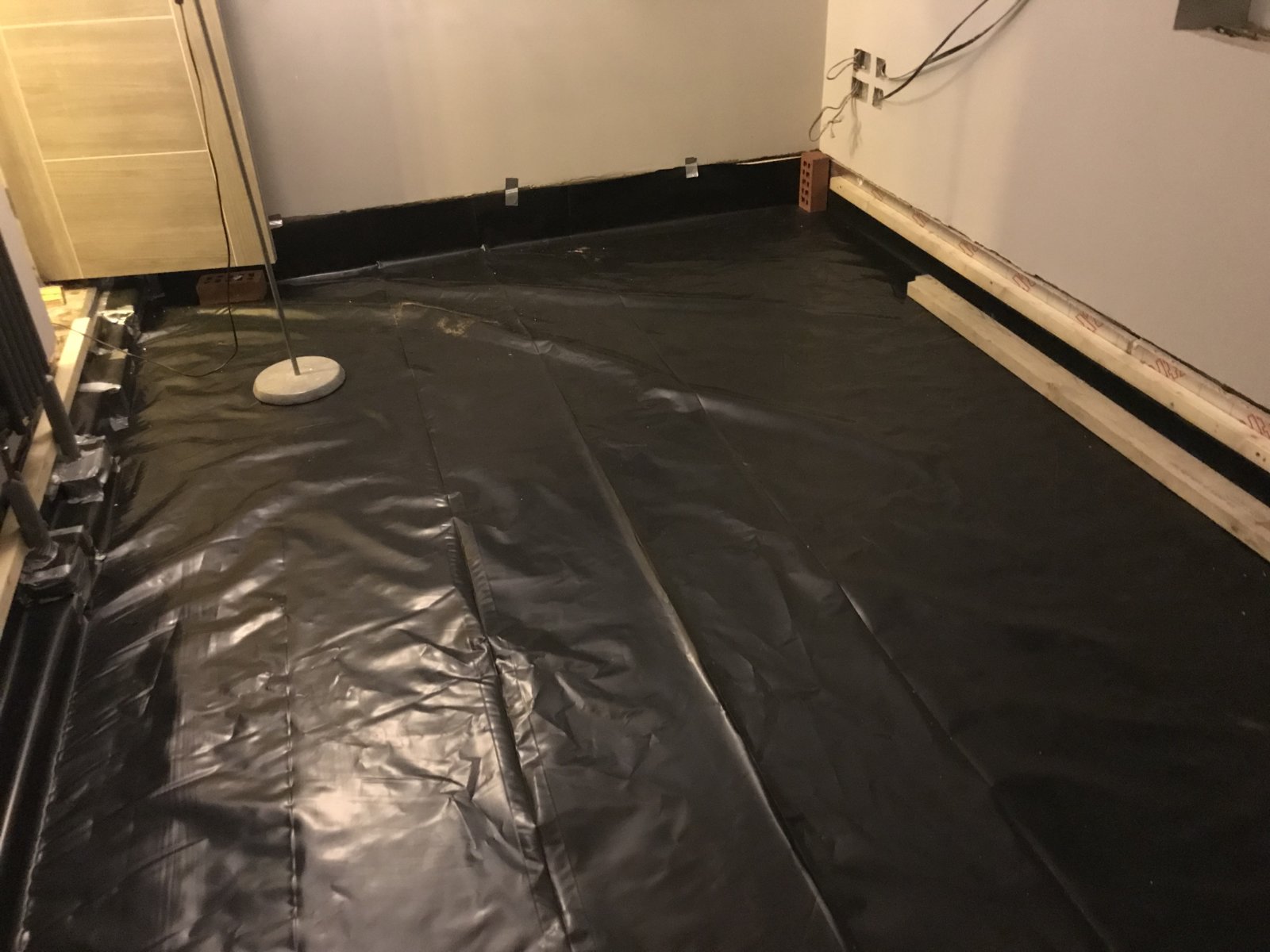

Hi all. I'm putting insulation on top of my sand. Can anyone tell me if I have to seal the gaps between the boards with tape or can I just pour the concrete straight on?
I believe that you use tape, otherwise water in the mix can get underneath and potentially the insulation begins to float. Might be worth a second DPC membrane?
