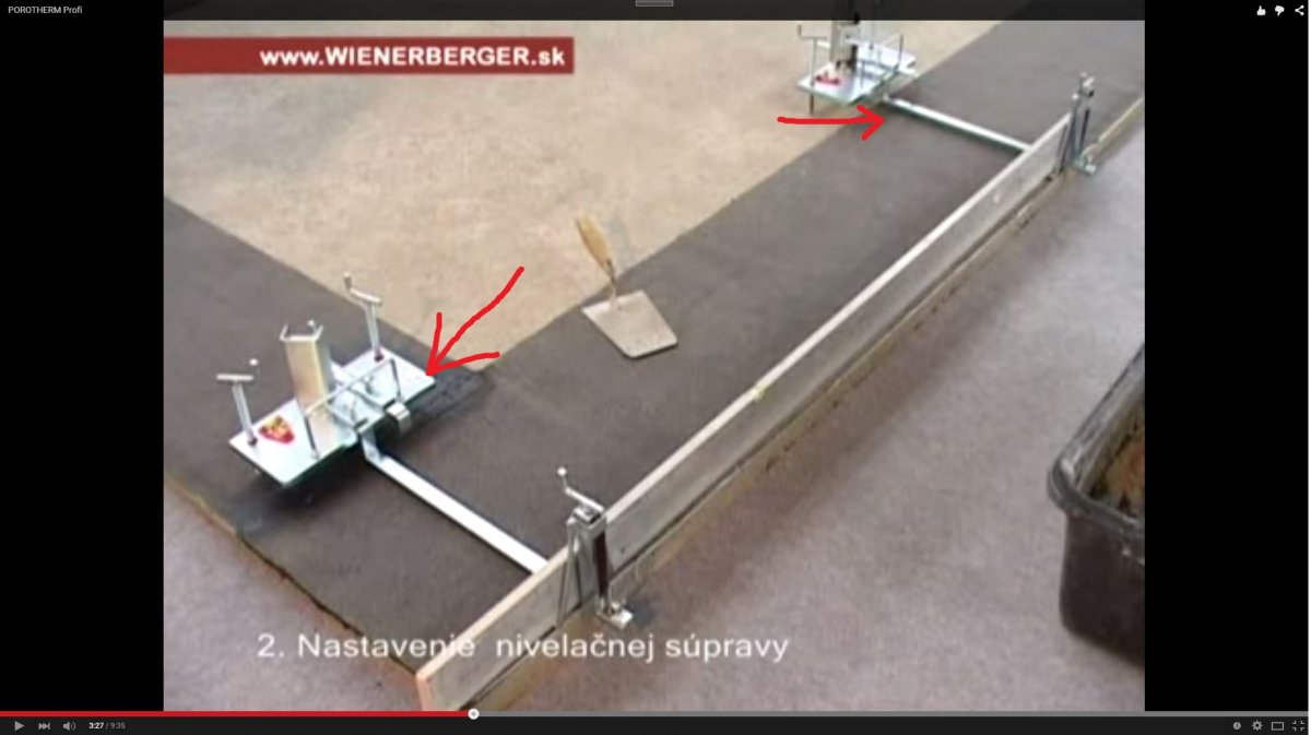

Hi guys i have decided to build my workshop using Thermoplan blocks aka Weinerberger
The first course has to sit on a dead level bed of cement.
I have seen on youtube that they use a leveling frame, see the beginning of this video:
Does anyone know where I can get one of these frames from?

I'd be more concerned about where to get that roller spreader thing they used on top of the first course- for the mortar bed just use 3 x 2 as shuttering and a straight edge across the top as tamper/level. Bit worrying how deep that bed is- mortar isn't really that strong. Be interested to hear how you get on.

The roller is £70 available from the block suppliers in the UK . But I can't find where the leveling bars are for sale.
