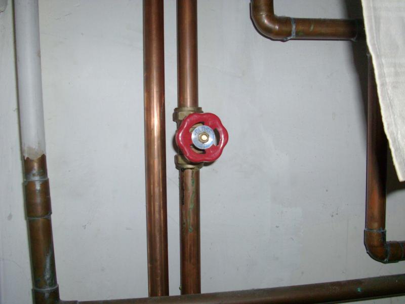

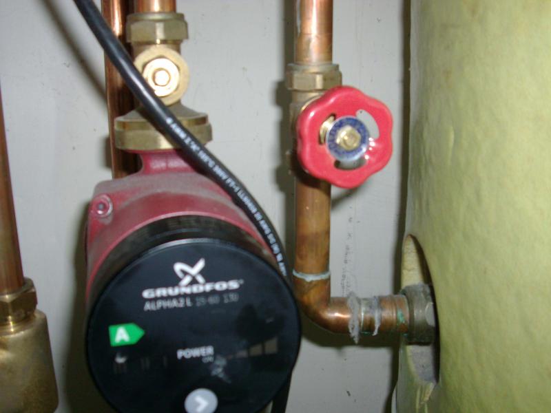

Btw what are the "red turn wheels" for that are attached to the pipes? One is attached to a pipe that goes to the heater and the other one is higher up on one of the pipes. I only ask because i have been messing about with these too!
See pictures attached
If you are not getting a digital reading on the pump when there is power to it then the pump will be at fault..
The red things are gate valves, stop messing with them or ya could be creating more faults. The pics are too close to say what pipes they are on but I'd guess a balancing valve for ya cylinder and a isolation valve feeding the cold water to the cylinder.
Try un-plugging the wire to the the pump and refitting, it just pulls out (from the pump end). But like I said it looks like you will need to replace it

Many thanks for the replies
Yep the pump is broke

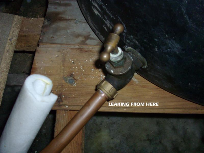

Just one more thing when i was in the loft i noticed a leak from the left pipe ( see picture ). It looks like it just needs unscrewing and the pipe pushed in a bit more
Because of the leak i have turned the tap off so no water is coming out now ( so of course i am not messing round with the heating now )

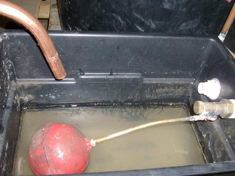

Just one final question. As you can see from the second picture the smaller tank does not have clear water...This isn't a problem is it?
I only ask because a powerflush is not under the BG cover

In the second pic of the drained f&e tank, it looks to me like the water level is now below the outlet?

If you start unscrewing the nut on that stopcock - chances are the cock will move and the connection to the tank will leak :cry: . It wants replacing with a proper tank connector then a piece of pipe and a modern full bore valve - forget BG cover and find a decent plumber - none of the work needs a Gas Safe person - just a competent plumber - good luck . Probably don`t need a powerflush either

Anyway yes it was a faulty pump. So he replaced it with a new one ( same model )

For an extra £7 per a month i can take out plumbing cover, but it's fixed now. Just unscrewed the nut on the pipe and put a bit of PTFE around the thread and pushed the pipe in full and tightened it ( not too tight )
I left some kitchen paper underneath ( past 8 hours ) the pipe and have been using the taps all day just checked the paper and there is a slight damp bit on it, so may need to tighten the nut again?
Yep didn't need powerflush i asked about the price and was told £700!

90 mins to change a pump head with plug in electrics :eek:
