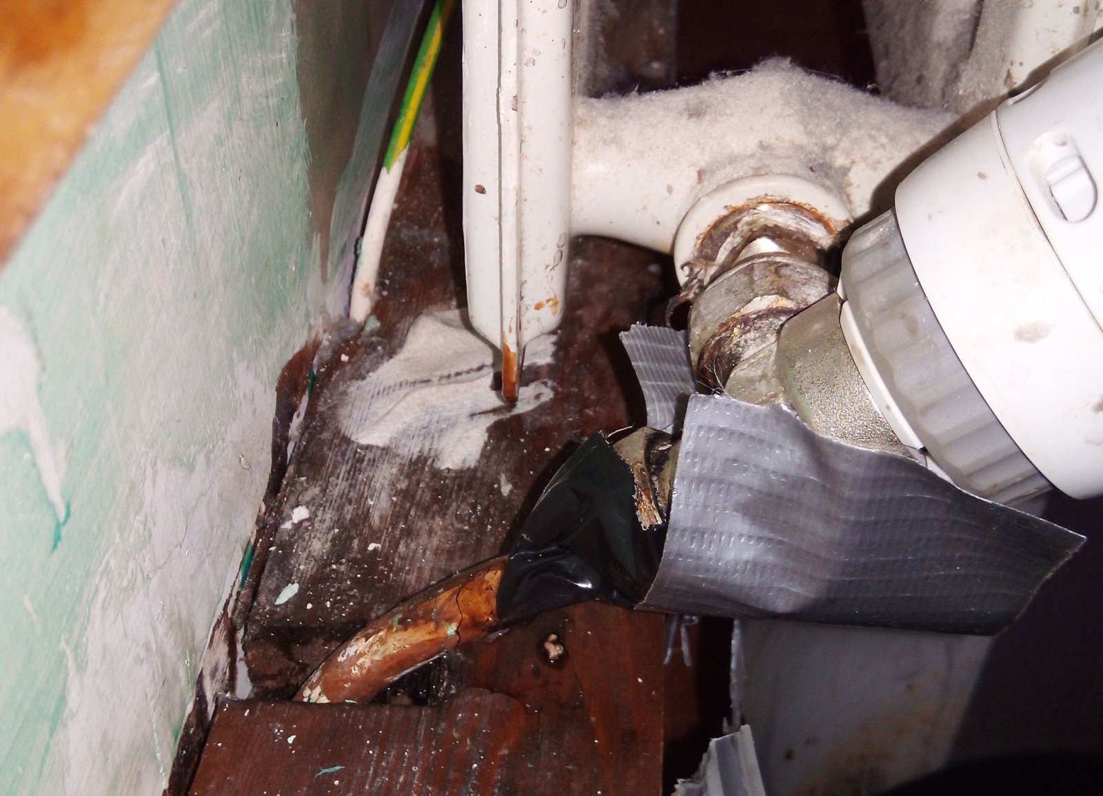

Thanks everyone. A few photos as requested by The Novice:
Sorry about the Duck tape, it's there to form a temporary "gutter" just to stop the water running back down the 10mm pipe and on to the floor. It's just dripping into a bucket instead. The hexagon on the nut with the 10mm pipe passing through it, is just over 24mm across flats.

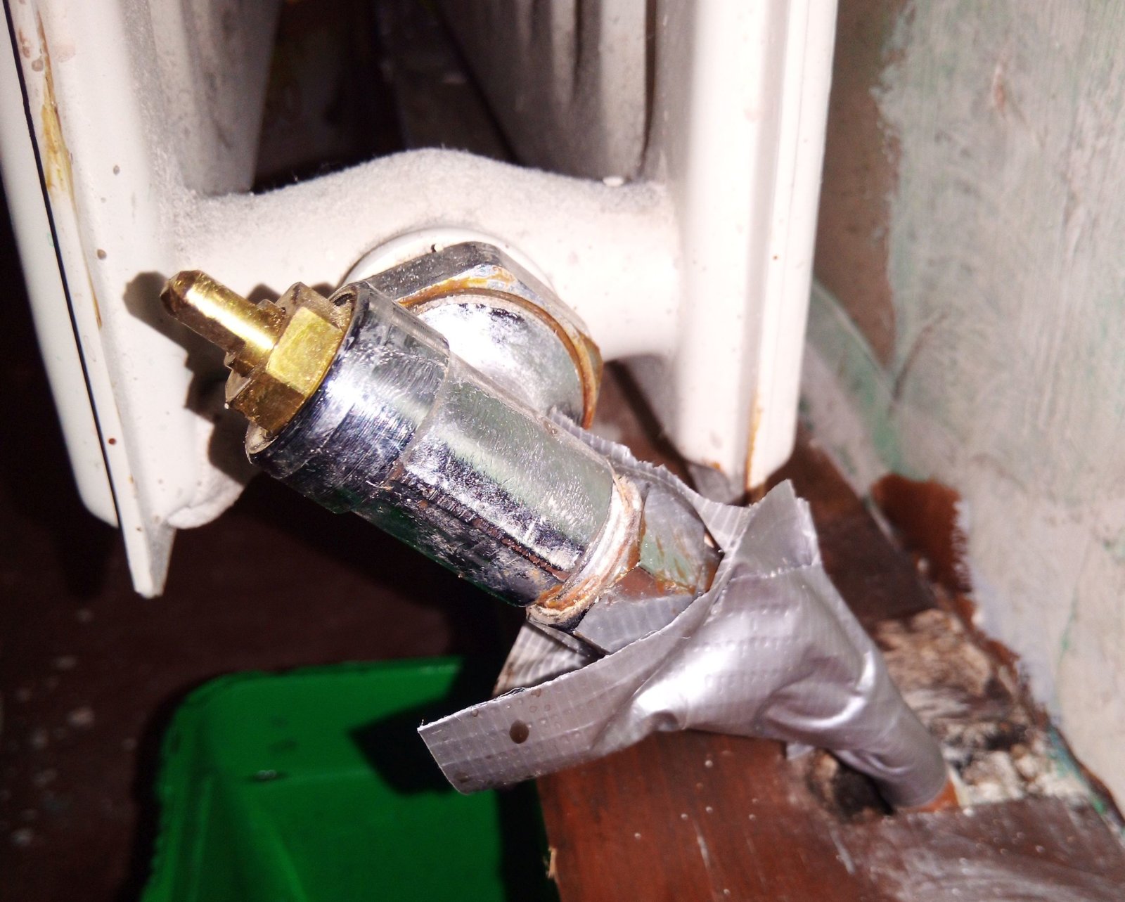

Sorry about the Duck tape in the way again! Spanner size on that hexagon nut on the 10mm pipe is 18mm across flats.

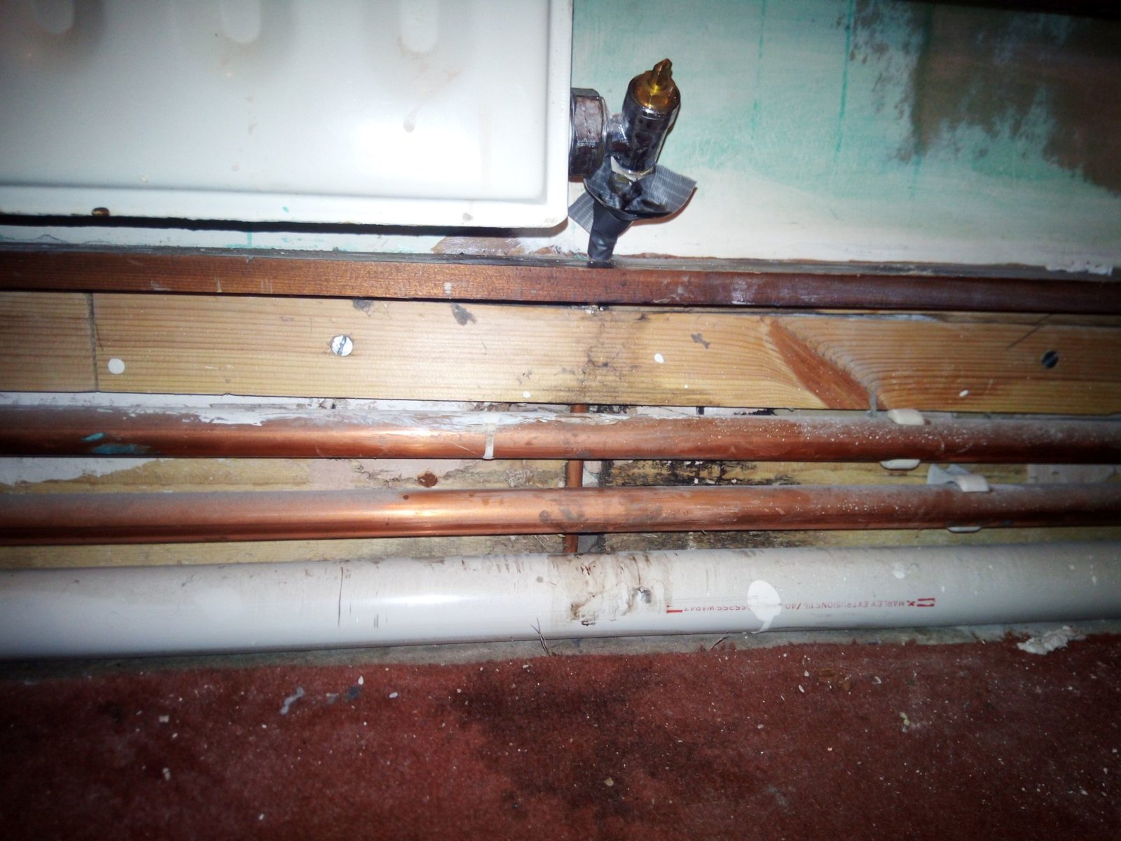

Those 10mm copper pipes disappear under the floor. I suspect they'll be soldered to T pieces under there. If the ends are compression fittings and the pipes are distorted, can I cut the top (say) 3" off the copper and joint a new piece on with a compression coupler?
The TRV will have a set of reducers ,and the other valve probably just 10 mm olive ,judging by the nut sizes. If pipes are deformed , a soldered fitting reducer will sort out the TRV ,and the other valve a new piece of 10 mm copper pipe soldered on with a coupler.

On the TRV I would be fitting a 15x8 ( or 15x10) adapter and on the lockshield cut the pipe back and redo the joint

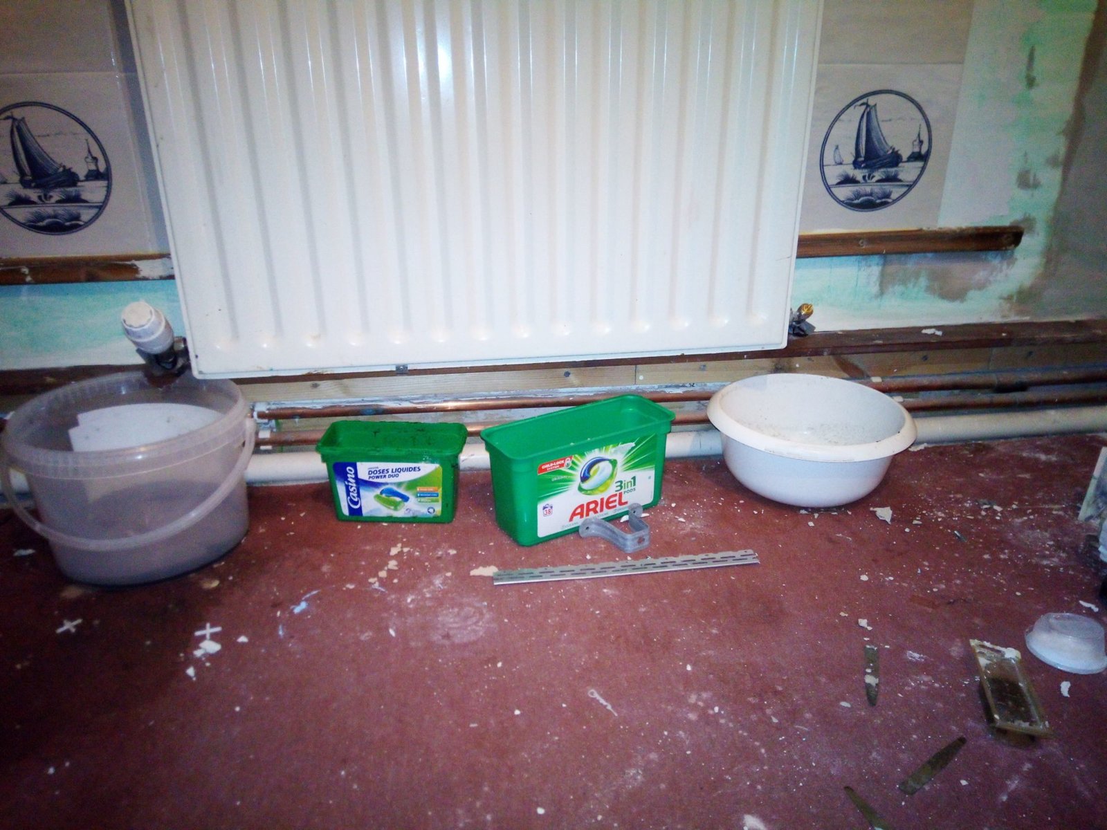

The board isn't the floor, the photo is deceptive, it's the top of some boxing that hides the 22mm pipes going to the bath, and the waste coming back from it. Unfortunately, however, the central heating pipes are behind that lot, and they DO come up from under the floor!
