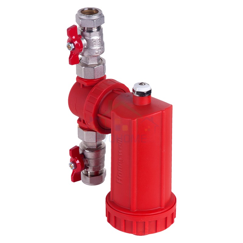

You could always go with one of the new Honeywell filters...
That'd look lovely under a boiler in the kitchen eh? Why couldn't they have made it white FFS :rolleyes:
What bad things.
they don't split and leak.
Don't need to open them so no seals to damage
Easy to clean on service
Never had a blocked plate etc with one fitted seen loads of blocked plates where magnacleans/tf1s/all the other ****e on the market are fitted.
