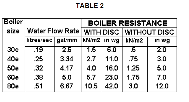

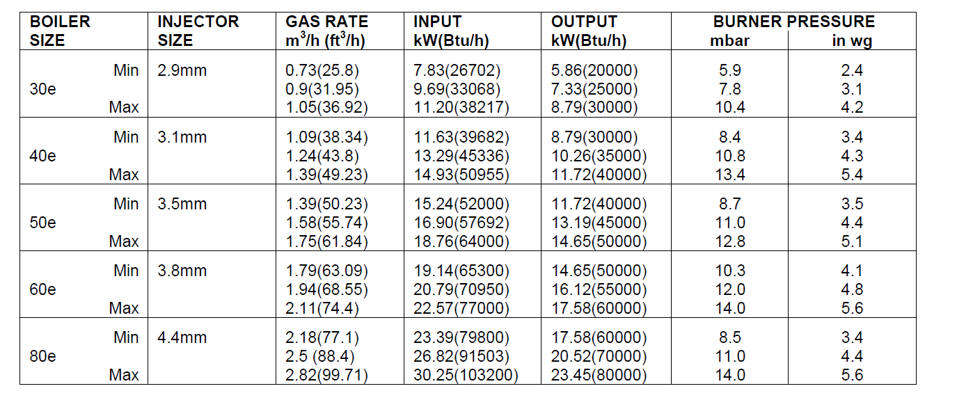

We don't know what model boiler, not sure but it seems that they don't modulate but have a 3 stage burner, if so the min output is still quite high, the pressure loss through the Hx is quite small especially if a injector disc? is used but of courde could still be full of crap after 22 years despite power wash etc.
Apparently a fantastic boiler, shouldn't be too difficult for a competent person to figure out if there is a boiler problem.
The newer type A rated circ pumps now give very very useful info in trouble shooting flowrates as most (apart from Grundfos) display at least the power in watts from which the flowrate can easily be derived from the pump curves, personally, I wouldn't, and didn't, buy one without this.

What is the boiler size, is it a 30 40,50,60 or 80E, it will be labelled somewhere.
