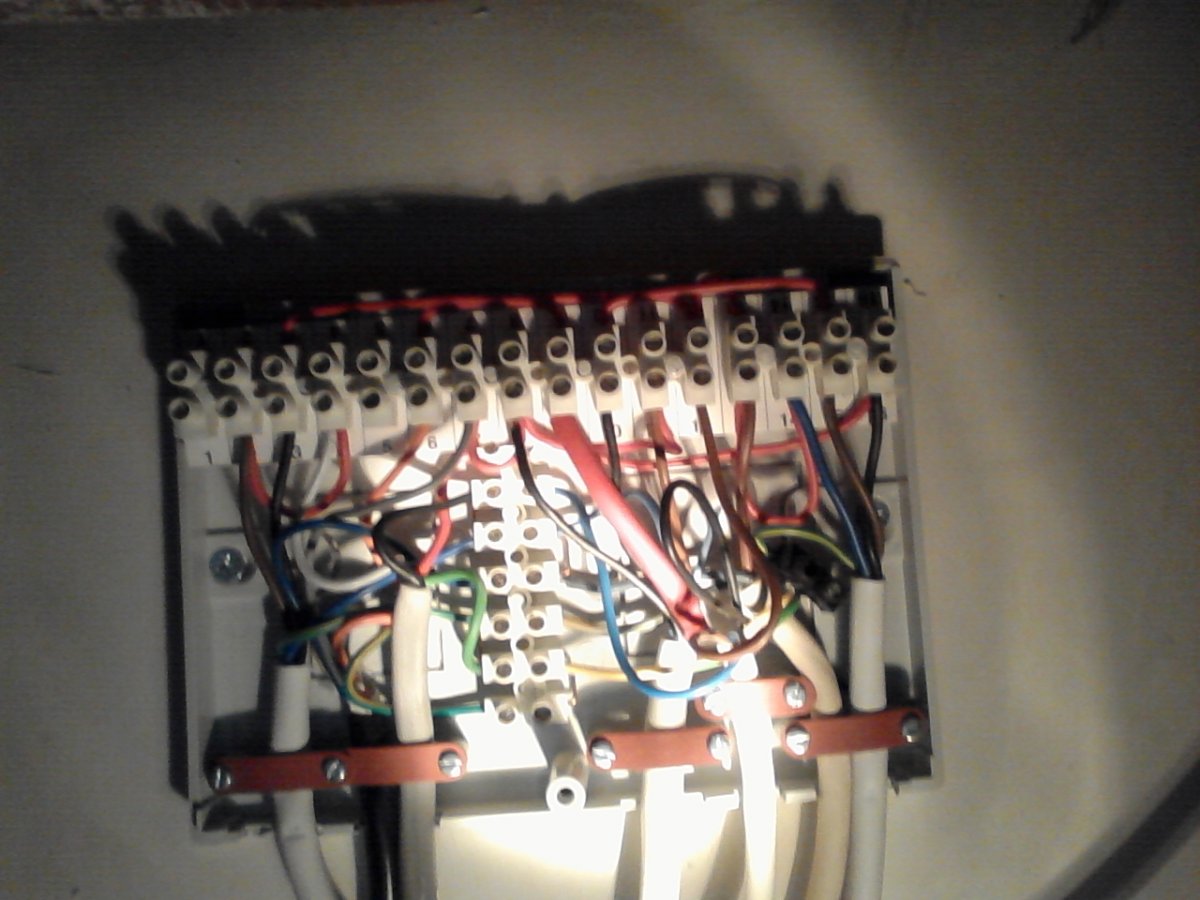

Can you post a picture of the wiring centre?

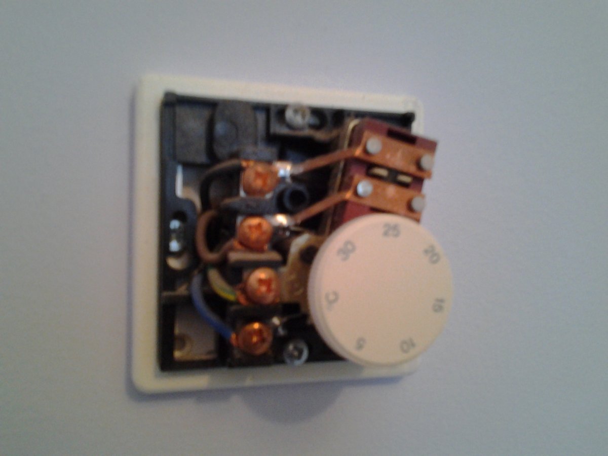

Live wire doesnt become live when CH called for. Here are oictures of wiring centre, therostat wiring and programmer wiring

The thermostat doesn't call for heat when CH turned on. Is this a thermostat or programmer problem then? Hope to hear back its quite cold haha
Sorry, I'm still looking at the pics but it's hard to make out the wiring colours and the connections properly in the uneven light.
Which model programmer and thermostat are they?
It's possible the programmer is getting a bit unreliable.
With Heating Only on the programmer.....assuming you have a multimeter, can you keep one probe on an Earth terminal in the wiring centre and then measure the voltages on terminal 8 and then 10.

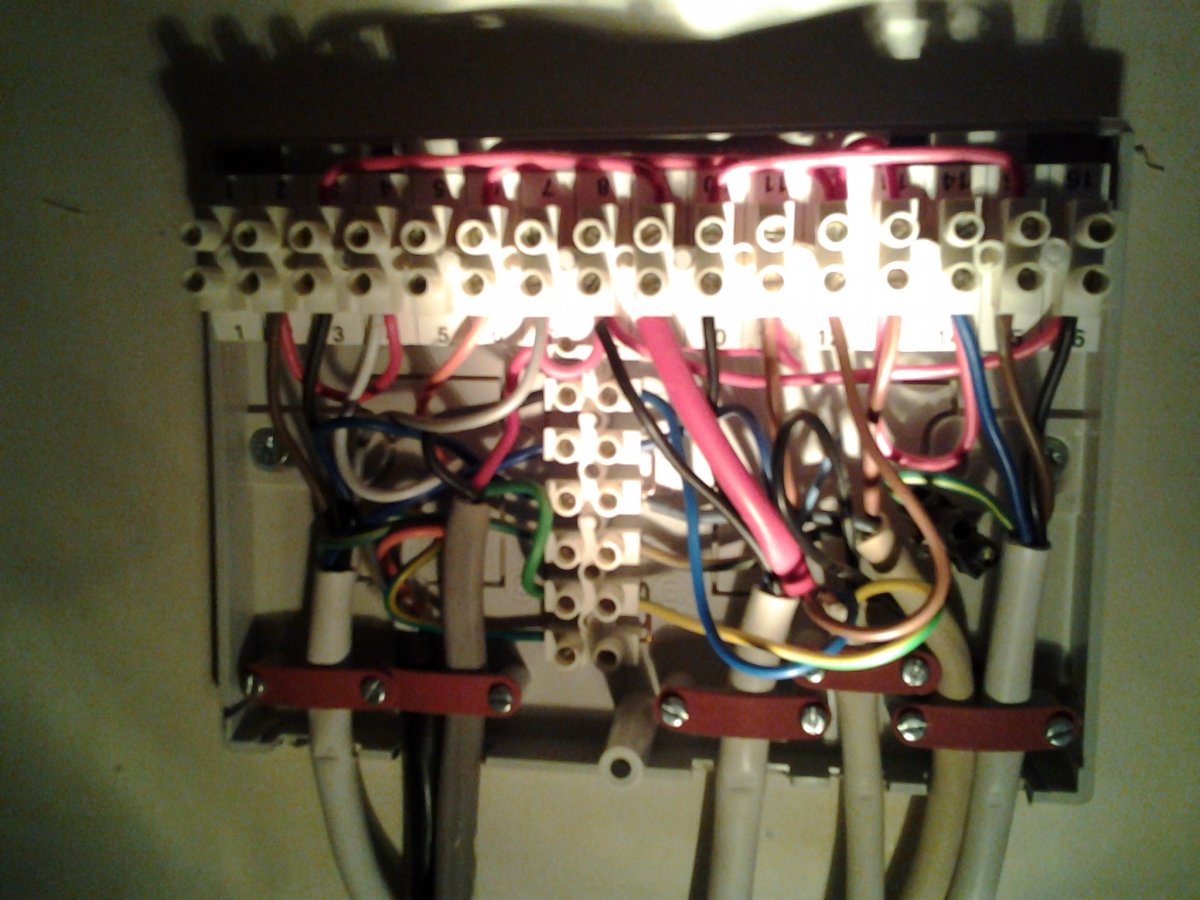

We did find that links between 7 and 8 were broken but weve fixed that and still no luck ill send a picture of the back of the cover plate too
Sorry here are better pics i hope

That makes it a lot easier.
With the programmer on Heating Only, can you measure the voltage of terminal 9 in the wiring centre, which should be live regardless of the room thermostat setting..

On the programmer backplate, wire links from Live to pin 1 and pin 4 together, should be equivalent to Heating Only.
Thats HW OFF and CH ON should be Live.
Oh my god thank you so much its worked! The heating is on constant now but can be switched off with room thermostat. Seeing as though this has worked does that mean we do need to replace the programmer?
Yes it looks like the programmer may not be supplying the HW OFF signal when it should be.
