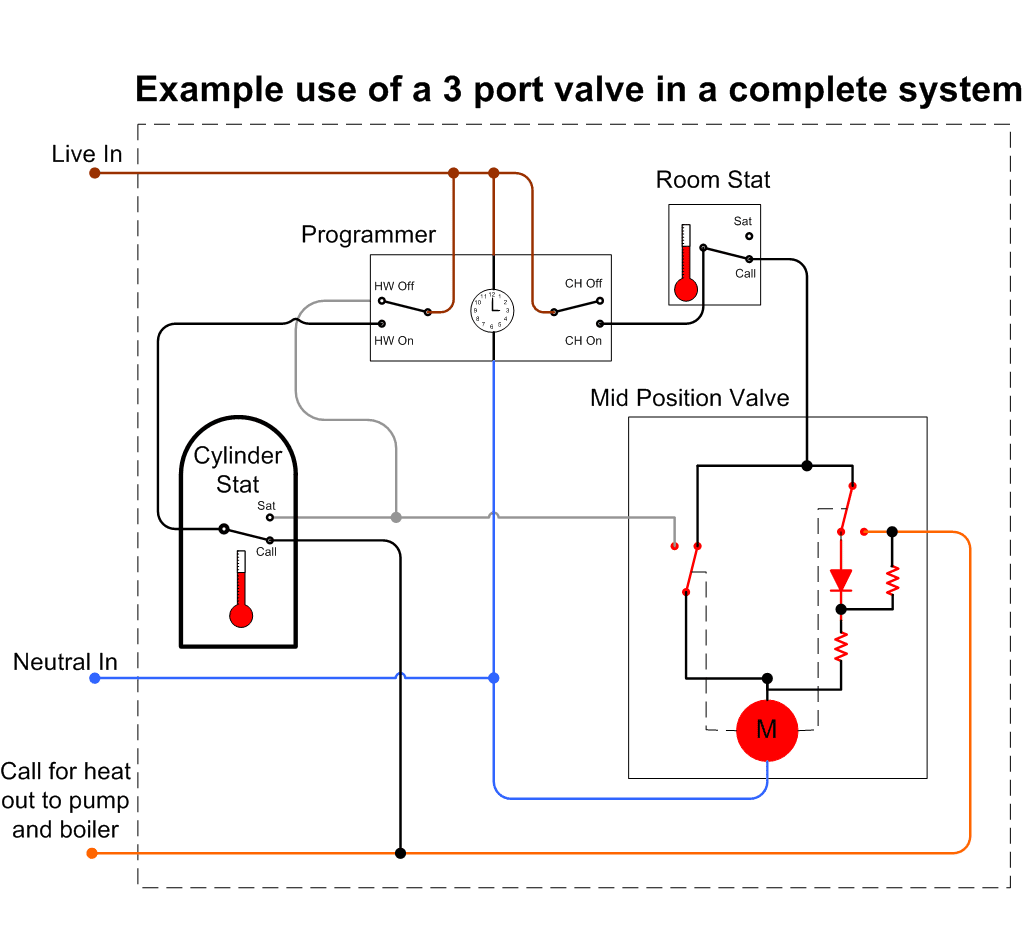

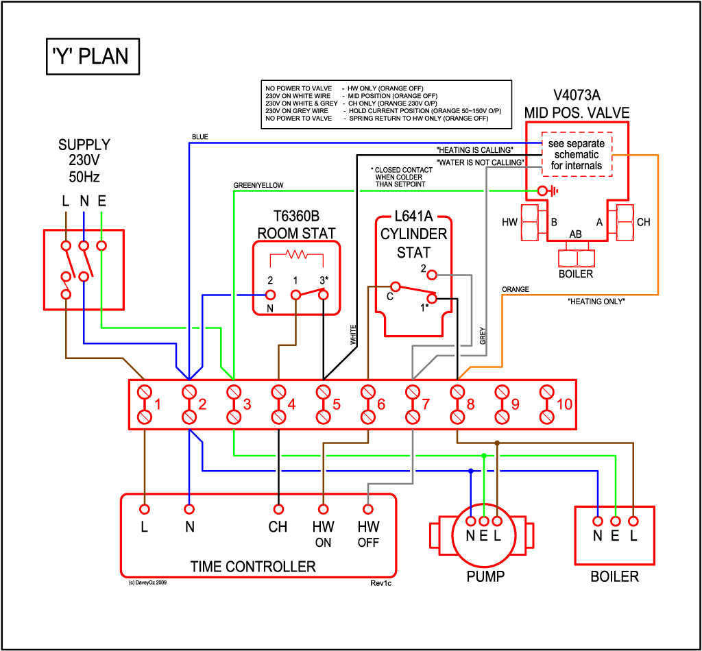

Just to confirm, AB is from the boiler FLOW (hot)?, B goes to cylinder & A goes to CH.
You say, above that "(Central heating on from controller on its own is not designed to work)." are you saying that you can't have CH on its own without the HW on and calling at the same time. If its a 3 port mid position valve then you can have HW only, CH only, and HW&CH together. (see user friendly schematic, below and "official" Y plan), if it a 3 port diverter valve then you can only have HW or CH but not both together. Can you confirm that you have a mid position valve via model number or photo?.
thank you Johntheo5 for looking into this. Some observations below :-
1. Correct, AB is from boiler flow (hot). AB is fed from pump installed just below the AB.
2. Central heating only works when HW is also on from controller. This does not mean HW is called by cylinder, just on from controller. My understanding is that when central heating and hot water are both on from controller, hot water cylinder thermostats decides if there is need for hot water or not, and if there is no need for hot water, then it sends signal to value to move to central heating only. I am looking for wiring diagram to allow for this function. All this will not happen if hot water is off from controller. This is how system was working previously.
3. 3 port valve -
HONEYWELL HOME V4073A1039/U 3 PORT MOTORISED VALVE 22MM 22MM COMPRESSION​
