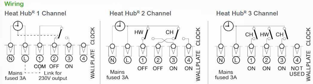

We've just turned the CH back on for the winter. It's controlled by two Drayton Digistat +3s, one in the hall and one on the landing.
Every night since turning it back on, downstairs has been fine (21C) while upstairs has been sweltering (typically a displayed 24C). I've been through the programming on the upstairs Digistat and it's programmed to heat to 21C.
Last night I put the upstairs one into Manual mode (which is supposed to override the programming until you switch back to Auto) and adjusted the temp down from 24C to 21C. When I got up at 5.30am, it was still in Manual, but it was reading 26C, and the bathroom was like a sauna.
The only fix I've been able to find is to switch the CH back off overnight.
Can anyone suggest what's going on?

Two thermostats = two separate zones so each thermostat will operate a zone valve.

So how are the zones controlled, by which pump runs or by a motorised valve, is the valve stuck if a motorised valve. There are normally leavers or other things where you can see if valve is working or not, in the main a thermostat controls the valve, then valve controls the boiler, so if valve stuck it will over heat.

If you have 100% checked the digistat settings then the fault is (:idea:assuming the system is correctly installed) either the digistat is faulty or one or more of the zone valves are at fault.
As a test,have you swapped the positions of the digistats (they are hard wired) to see if the fault is moved to the downstairs zone.
While the system is at fault.The zone valves need checking for defective switching using a multimeter and checked for let by via observation of heat movement.
Depending on the zone valves and the installation method,testing will vary.
I swapped the stats over at the weekend and the problem stayed the same, so I guess that points to the zone valves? Although I suppose there's still one more thing to try, which would be to replace the button batteries inside the stats (that I didn't know existed until I popped them off the wall). I'd already replaced the AAs that seem to drive the display, so maybe the replacing the button batteries will force a full reset of the stats which *might* help...?
If the problem remained with the upstairs radiators despite swapping the stats over, then fault is not with the stats. Time to start checking elsewhere. The zone valves as suggested by old& bold would be my next port of call.
