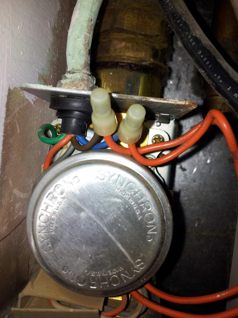

Hi All,
My central heating isn't working, Hot water is fine but the heating doesn't fire the boiler into action.
I think i have proved it down the the synchron motor picture attached, i am getting 240v at the motor. But nothing is happening. Makes me think it is a faulty motor.
I have a separate one for the HW and this functions normally.
Do I just need to purchase a standard synchro motor? Do i need to drain the system if it is this thats faulty?
Thanks for any advice.
Worz
Turn on heating controls and turn thermostat up, then move the lever on the 2 port valve to see if it moves. It may just be stuck.

I think i have proved it down the the synchron motor picture attached, i am getting 240v at the motor. But nothing is happening. Makes me think it is a faulty motor. Do I just need to purchase a standard synchro motor?
If the motor is faulty, then yes.
No

The lever moves fine, but nothing happens. Do you think the motor is most likely faulty?
Thanks for the fast replies. The lever moves fine, but nothing happens. Do you think the motor is most likely faulty?
If it still does nothing, with voltage present, after you've moved the lever, then it very probably is faulty, yes.

Hi again,
It looks like it is the valve that is buggered. I managed to get the motor off, it is very awkward and the motor is turning fine, it just seems the valve wont move, i was able to move the man/auto switch, but i think it was just spring pressure, not the valve opening, is there any way to free these up or will it need replacing?

If the valve was seized I don't think you'd have been able to operate the lever, if you want to you can remove the actuator and attach an adjustable spanner to see if the ball will move, it only moves a small amount, around 45° iirc
IIRC, there's usually some lever movement before the valve starts moving - so maybe that's what the OP experienced, and thought that it was moving the valve?
