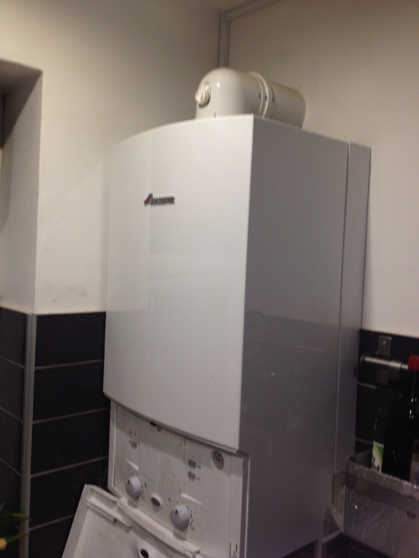

1. Boiler - white pipe at the top connects through the wall to the wide plastic pipe (flue) outside.

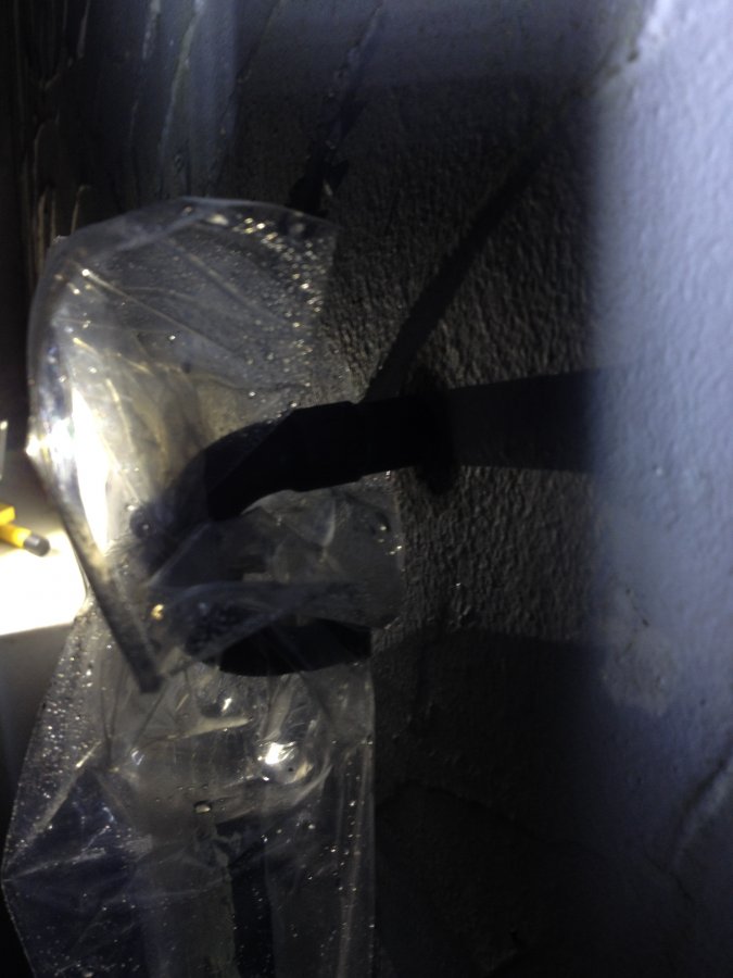

3. The relief copper pipe with a plastic bag around it.

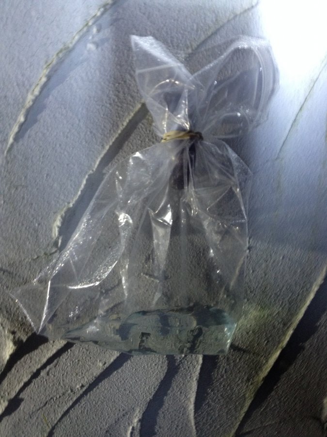

4. Water in the bag from image 3 gathered after ~2.5 hours. Bag size is 240x340 mm^2 (=9.5x13.5 in^2)

OP: the bent copper pipe is your discharge from the boiler, it is connected to the pressurised central heating circuit and is governed by a PRV (pressure relief valve) which is a safety device that allows expanding water to escape if the pressure gets to high due to overfilling/overheating. If the PRV is defective, it can allow the escape of system water at a much lower pressure level than it is rated to, hence the drop on your gauge and need to frequently top up.
As you have collected water in the bag you tied around it, it would appear that it is defective and is letting by! Get this looked at and possibly replaced but do not rule out other leaks on the system.

Water leakage through the PR pipe is ~0.2 liters/24 hours .
To refill boiler pressure from 0.8 to 1.5 bar takes 10 sec, and on my estimate takes less than 1l of water, so 0.2l/day is not negligible and hence PRV valve must be faulty.
