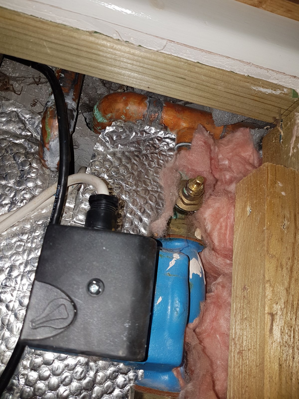

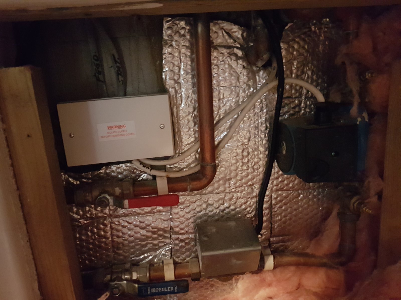

I have found 2nd pump motorised pump and junction box. The thermostat does not start up pump, motorised valve. Oil boiler is on the outside wall behind the picture. When main house ch started then nothing happens when thermostat starts in annex the water just feeds through. Put some images up below

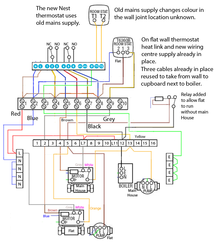

I found only way was to make a diagram showing what you have, then trace what should happen.
I have made a mistake, which I need to cure.
I added a relay to allow flat to run without house, however if you trace it, you will see if flat runs then it will also energise house pump, I need to move pump from 13 to 4 until a second relay added. Without drawing it all out, it is near impossible to find where the error is.

What you have posted looks like a professional installation. So, you may have everything in place, but something has failed.
For example, the room thermostat should open the motorised valve to allow water to flow to the annex radiators and start the pump. When the valve is fully open it operates a small microswitch inside that should start the boiler (via the orange wire in the diagram posted by ericmark) These switches can fail and so the valve opens as it should, but doesn't start the boiler, so nothing happens. Then when the main house heating comes on, the main house valve triggers the boiler and both the main house and annex (because it's valve is open) heat up. - That would be one theory that would fit your symptoms.
A basic test of the valve would be: With the annex heating 'off' slide the manual lever on the side of the valve, you should feel resistance as you move it. Now turn the annex heating on, with someone listening next to the valve and they should hear a 'click' after 20 seconds or so. That is the switch operating. The operating lever should now be loose and floppy. If it is the valve is opening. Now turn the thermostat off again with someone listening and you should hear a whine / whirr as the valve closes.
You have one boiler, but how many pumps? Had mine been plumbed with one pump it would have been easy, not a clue why two pumps, but that is what causes the problem.
You can have on the S system 10 zones with 10 thermostats and 10 motorised valves as long as only one pump and one boiler all one does is connect all orange wires together.
But with a second pump there is only one micro switch in the motorised valve so unless one add relays you can't have same micro switch power boiler and pump it could be done if the pump and motorised valve power on together, but then the pump is running before valve has had time to open.
I think Stem is likely correct (he usually is) and some thing has failed, most likely is a micro switch.
The way central heating is wired it's easy to get it wrong, with my diagram the domestic hot water relay also works the central heating, NC contact is used when DHW is not required to power boiler for central heating, things like this can cause errors, it did in my case, it's easy to make a mistake.
