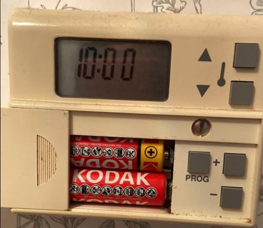

CH now not working again after new batteries fitted in thermostat
13 Nov 2008
1,554
32
Avon

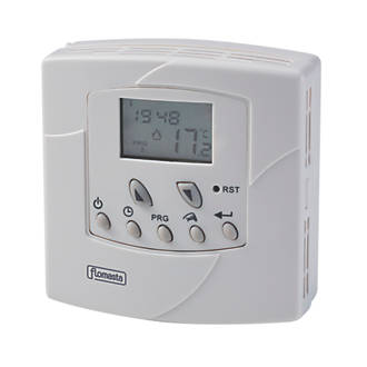

My sister last night said that her central heating wasnt working.
What she means is the radiators are all cold.
She looked at the timer / thermostat item on the wall if thats the correct name for it & said the battery icon was flashing.
She fitted new batteries & set the time etc again then in 10 minutes time she messaged me to say the radiators are now getting warm.
DANFOSS TP5E
This morning she messaged me to say that the display had changed back to 23.25
She also sent me a short video clip & i see the battery icon was flashing again.
Attached is the item in question.
Has anybody come across this before & what steps should now be taken.
It seemed last night when batteries & time set etc sorted itself out but unsure of this mornings actions

I asked her that and she said she had just bought them.
I will tell her to go buy Duracell and try.
She also said this.
There are more than 24 hours & more than 59 minutes.
Make any sense to you

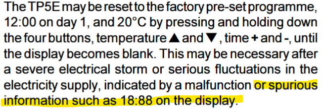

Some of those controllers need a reset after a battery change- annoying cos you lose your custom programming but tis what it is.
Danfoss TP5EManual here

She also said this.
Obviously not the right settings then
As above, need decent quality alkaline batteries, not cheap zinc batteries
Those Kodak batteries are about as cheap, and useless as can be bought. Pound shop?
Suggest she buys and fits some decent ones. For low cost batteries, which seem OK, I buy JCB alkaline batteries, from Home Bargains.
Aldi own-brand alkaline batteries are best value, and very good. In "Which" tests, Duracell are almost as good as Aldi, but twice the price. Kodak are a "don't buy."
It is an advantage to use a nylon toothbrush with a trace of WD40 (spray a tiny bit into a saucer and rub the brush on it) to clean the terminals in the device, and the ends of the batteries, each time you change them. Do not spray into the device. The amount of dirt should be imperceptible, but you can wipe it away with a tissue. You can also spin the batteries a few times with your thumb to rub the terminals together.
