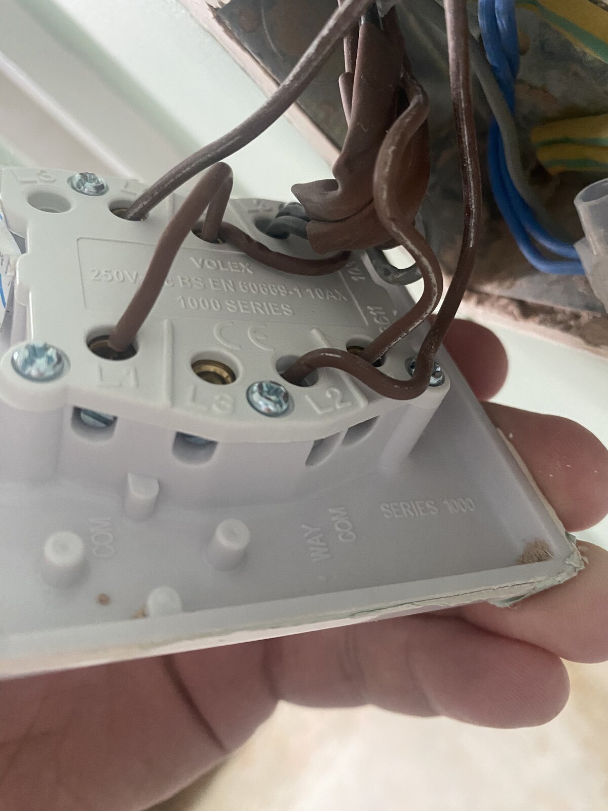

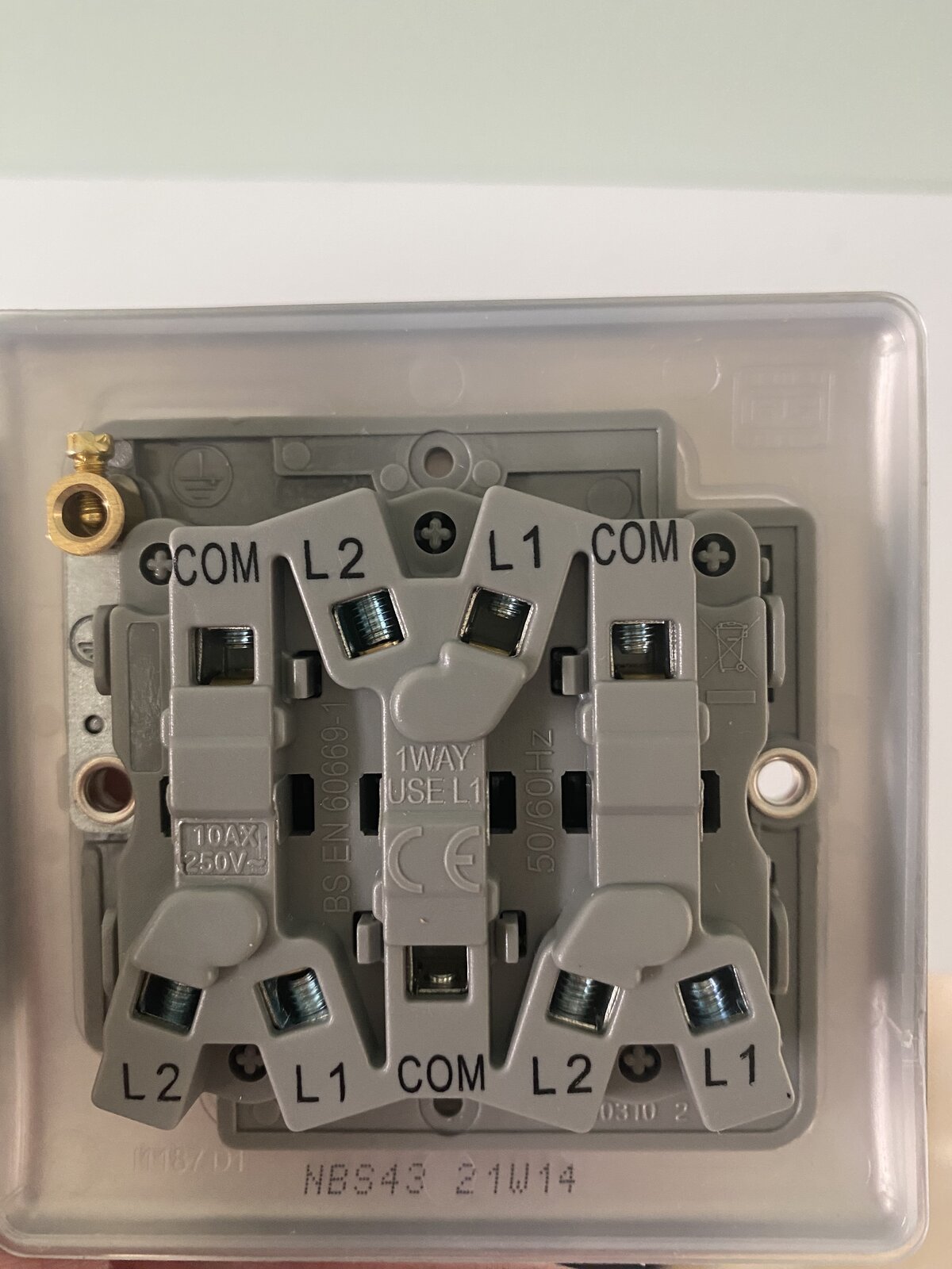

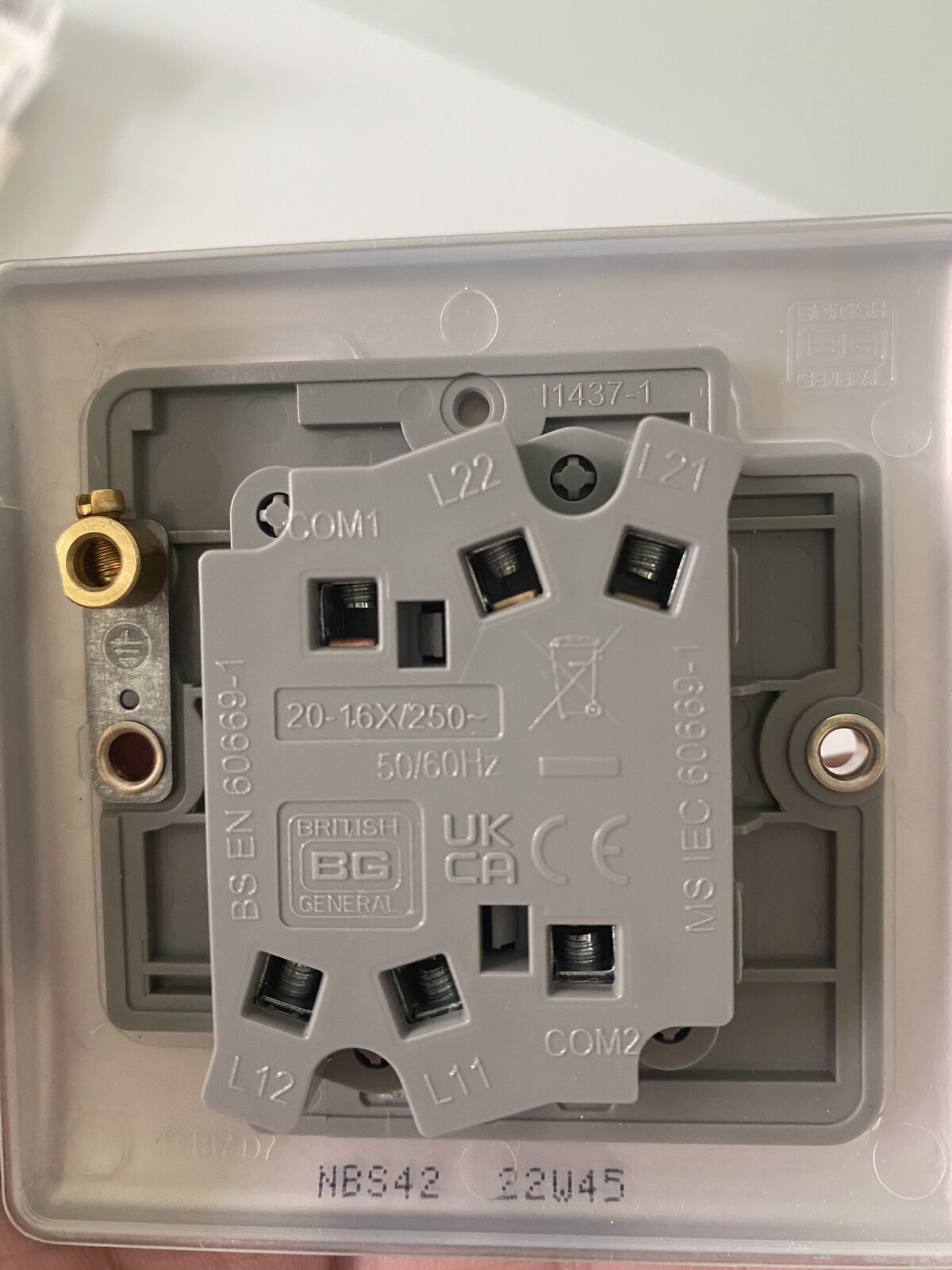

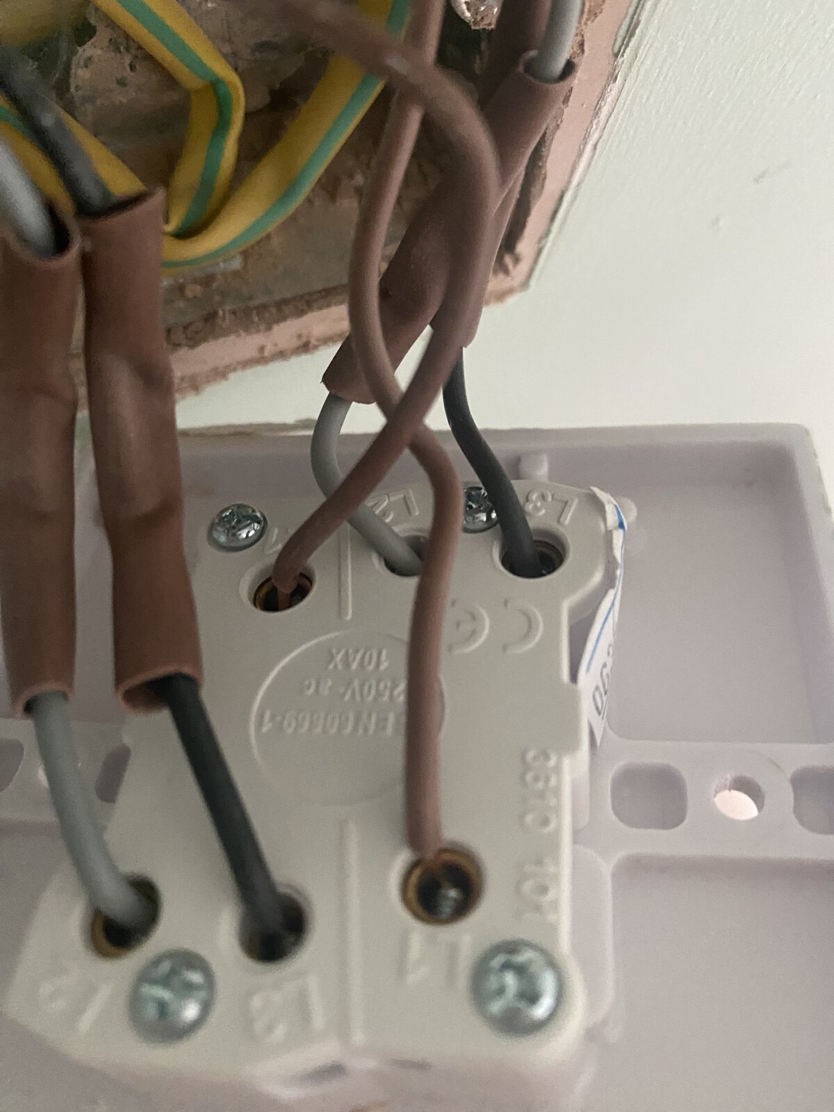

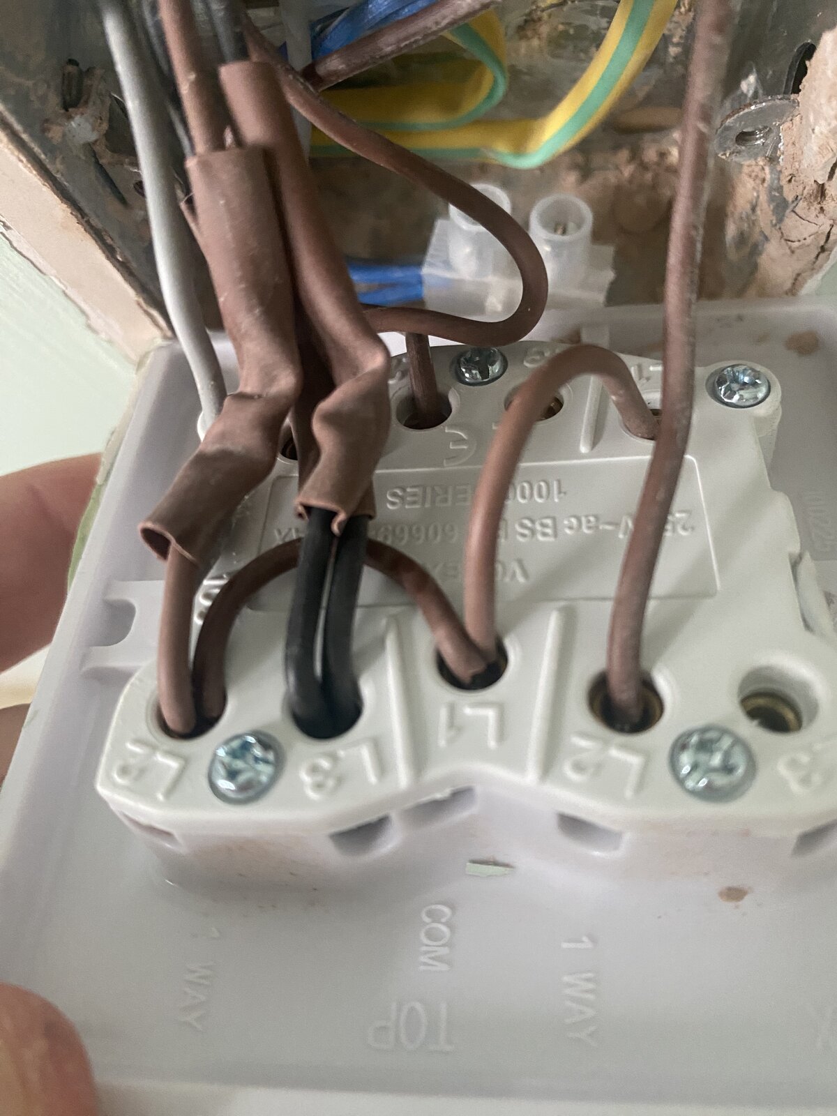

Hi I’m looking at replacing 2 light switches 2 gang and a 3 gang however when I’ve looked at the wiring I’ve noticed the new switch are slightly different and confused me I will attach pictures of the current switch’s and wire and the new one if anyone could point in the right direct that would be great

On the old switches L1 is COM on new switch
L2 is L1 on new switch
and L3 is L2 on new switch
and the good thing is you have pics of the wiring BEFORE you removed any from the terminals
Yeah now looking back they do look same its that the new one have com and the old have l3 which are putting me off

Thank you think that clear it up more just so confusing with them having differing number attached to them
