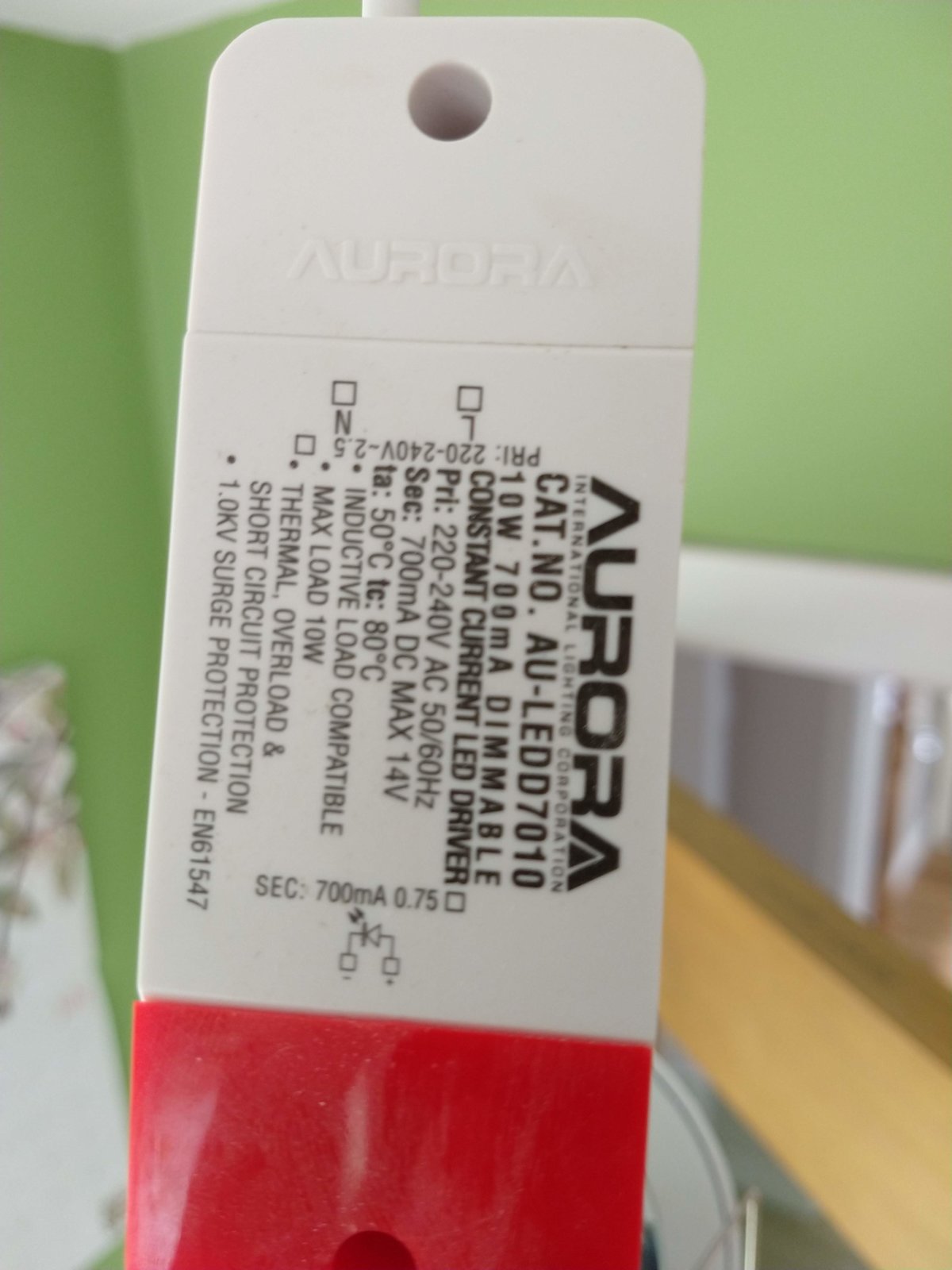

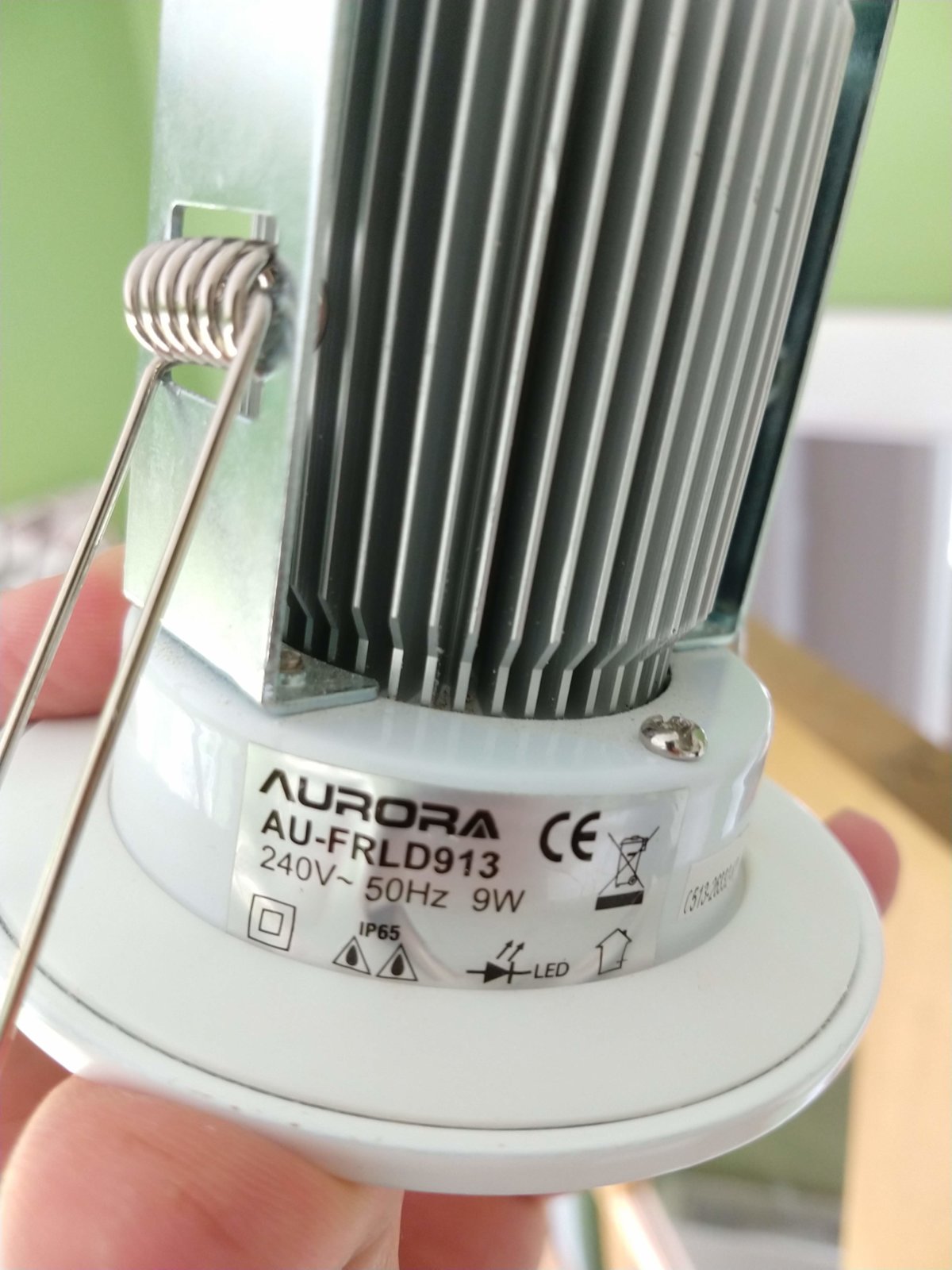

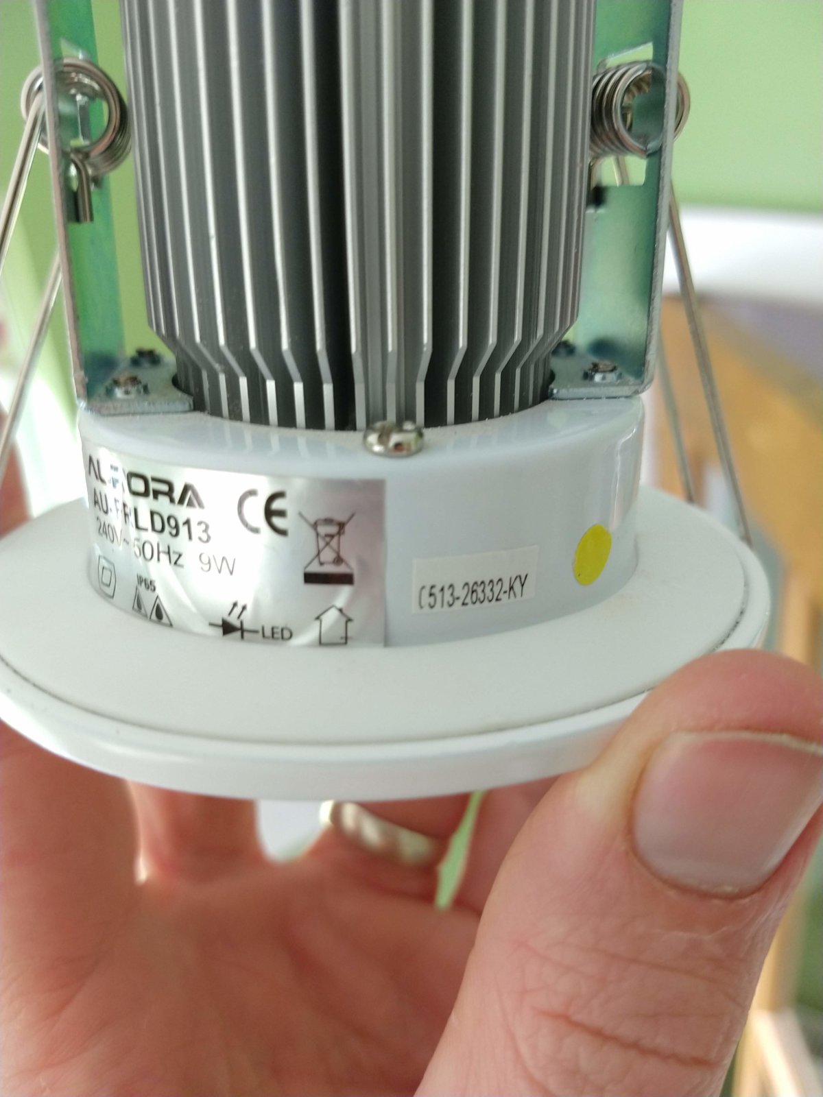

Hi,
One of the LED spots in my kitchen has gone (after only 4-5 years?)
I'm trying to replace the 'bulb' but I can't see how, it looks like the whole fitting needs replacing, which is just insane.
Make/model: AURORA AU-FRLD913.
Images below:
IMG_20180701_154712605.jpg IMG_20180701_154610701.jpg IMG_20180701_154601697.jpg
I'm trying to replace the 'bulb' but I can't see how, it looks like the whole fitting needs replacing, which is just insane. Make/model: AURORA AU-FRLD913.
It's not what you want to hear, but I don't think that light has a replaceable 'bulb' - so the whole thing will probably have to be replaced (and that model is no longer made, but you might find some 'old stock' somewhere). Sorry!

It's possible that the driver has failed - can you dismantle a couple and swap the drivers to find out?

Have you tried checking to see if it is just the driver which has failed? If so, that could be replaced.
This serves as a reminder why these fittings aren't a good idea - they don't last forever, as hoped, and replacements can be difficult to source.
GU10 fittings with LED lamps are best IMHO.
Seems the OP isn't listening :rolleyes: At least these have an easily accessible driver with easily accessible terminals. Just needs to pop the cover off the LED side connections and check the voltage - if it's 0V (or thereabouts) then (almost certainly*) the driver is faulty and can be replaced, it it's 14V (or more) then the LED itself has failed open circuit.
* It's always possible that there's an internal short, but I don't believe this is a common failure mode for LED emitters. Can be verified by checking the current which would be fixed at 700mA but around 0V.

Thanks all for replying. Wasn't getting the notifications. Will test the driver. Cheers.
