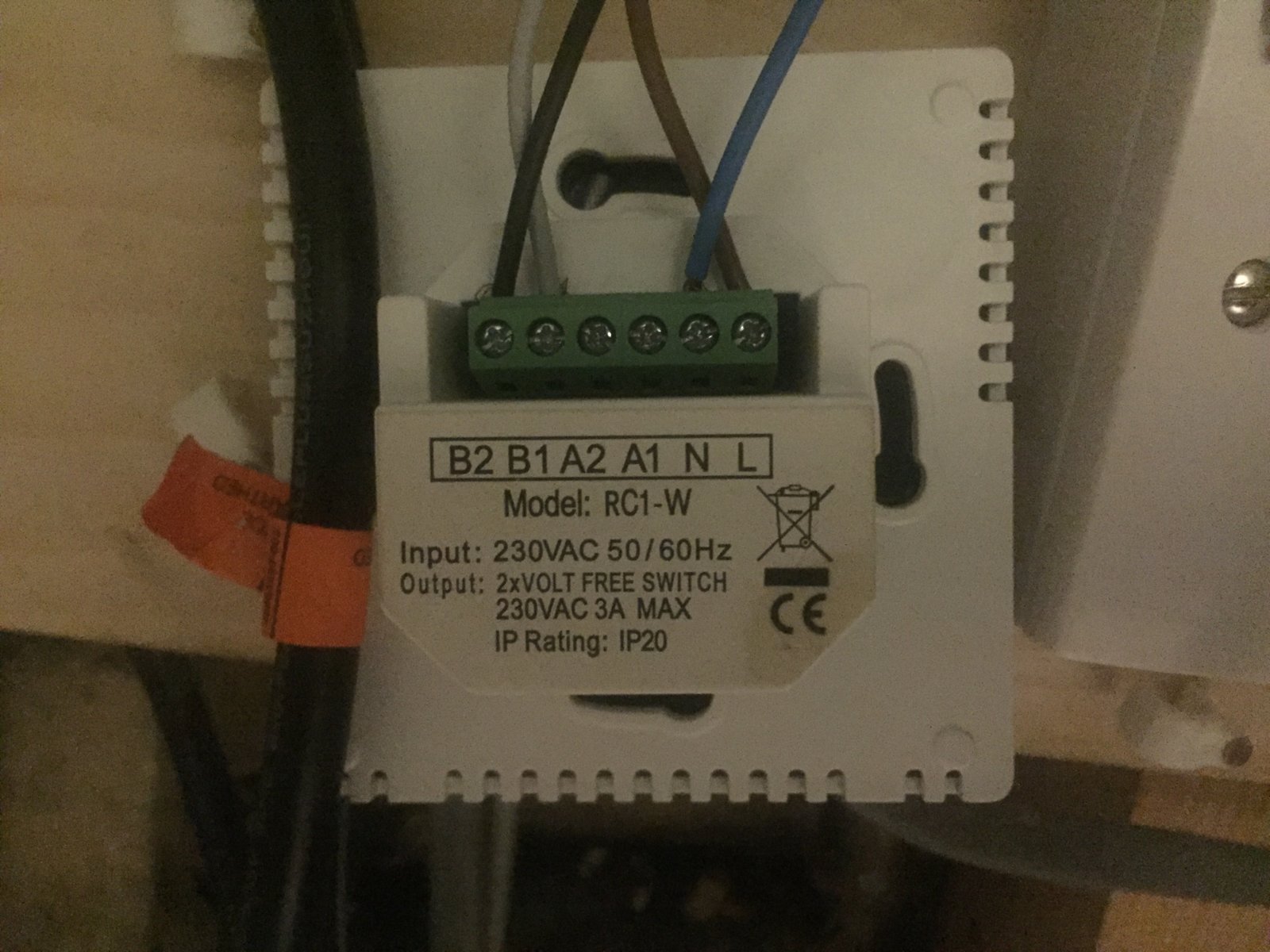

I am trying to replace a broken and now discontinued heatmiser rc1-w with a newer heatmiser from switch.
I had to get a plumber out to diagnose, but he didn’t have the spare parts, so I said I’d wire in the replacement as it was just a case of putting the same wires back in the same place.

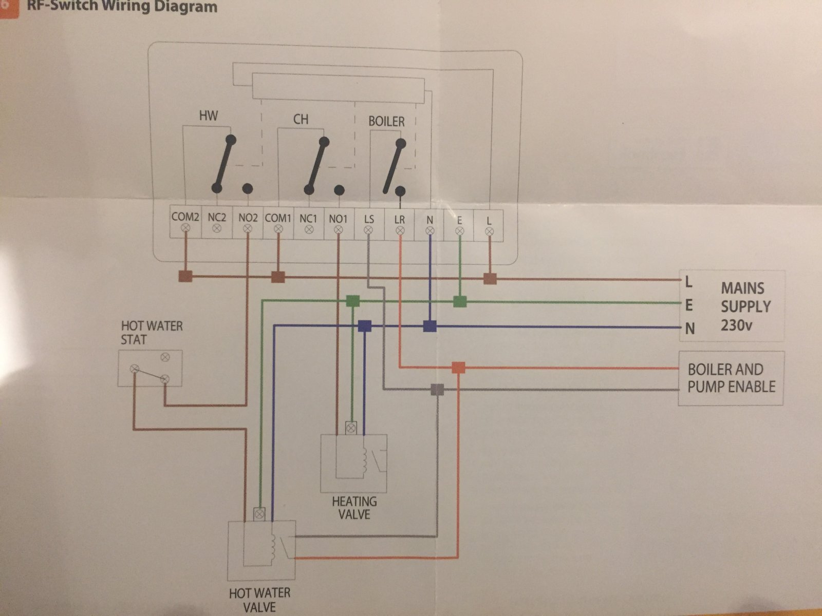

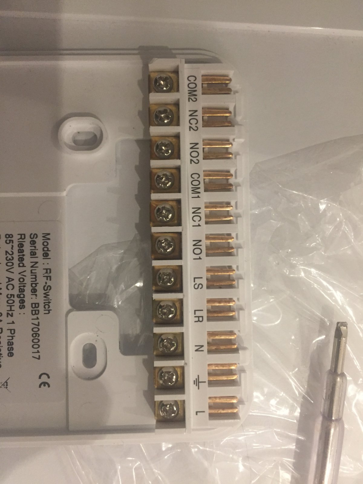

Problem is, on the new rf switch there are loads more terminals than there were in the rv1-w.
Can anyone advise what goes where so I can avoid calling the plumber out again?

Assuming you're controlling your heating, just connect the wires that go to B1 and B2 in the old model, to COM1 and NO1 in the new model.
Assuming the existing wiring is correct and working properly, you don't need to connect anything to the boiler terminals.
The new model appears to offer an alternative relay to fire the boiler, rather than use the micro switches in zone valve(s)
What sort of boiler do you have, and do you indeed have a pump or any zone valves external to the boiler?

So it should be:
B1 to com1
B2 to no1
Correct?
Thanks again.
John
Yep. If you know which wire is the live feed, this preferably and conventionally goes to COM1, and the wire to the valve to NO1, but it doesn't matter electrically in this case - unless OCD keeps you awake at night.
