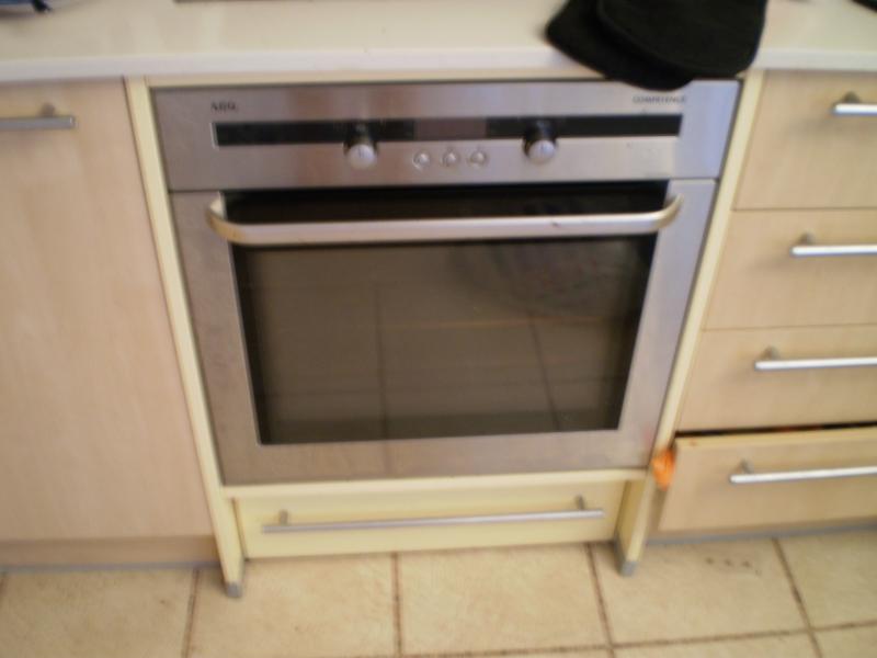

Next question this is my oven
2)Is there a way i can get a black gloss door hinged to the trim or is it to thin .I need it to go cover the oven all the way to the floor.

You can get him to give you a price for the job, Howdens may give him a discount which he may or may not pass on to you. Can't cover an oven up, dangerous, can't think of any reason you would want to and how would you make the door handle on the oven disappear.?

And re the oven, nothing combustible on, around or over it. Oven will also require air flow so you cant block that.
Hmmmm Steve, being as most built under ovens usually go into a housing made of MFC, I wouldn't say that no combustible materials can go around , or over it. Ovens should be fully insulated to prevent heat transfer to adjacent units anyway. ;) ;)
Point taken, I just went cold at the thought of a cooker door being covered in wood.
I am used to fitting free standing range cookers with my made to measure kitchens, even though they too are insulated they still require a small air gap each side. I stand corrected :unsure:
Built-in ovens have an air gap too, inside the carcass. Convection removes the small amount of heat leaked via the service gap.
