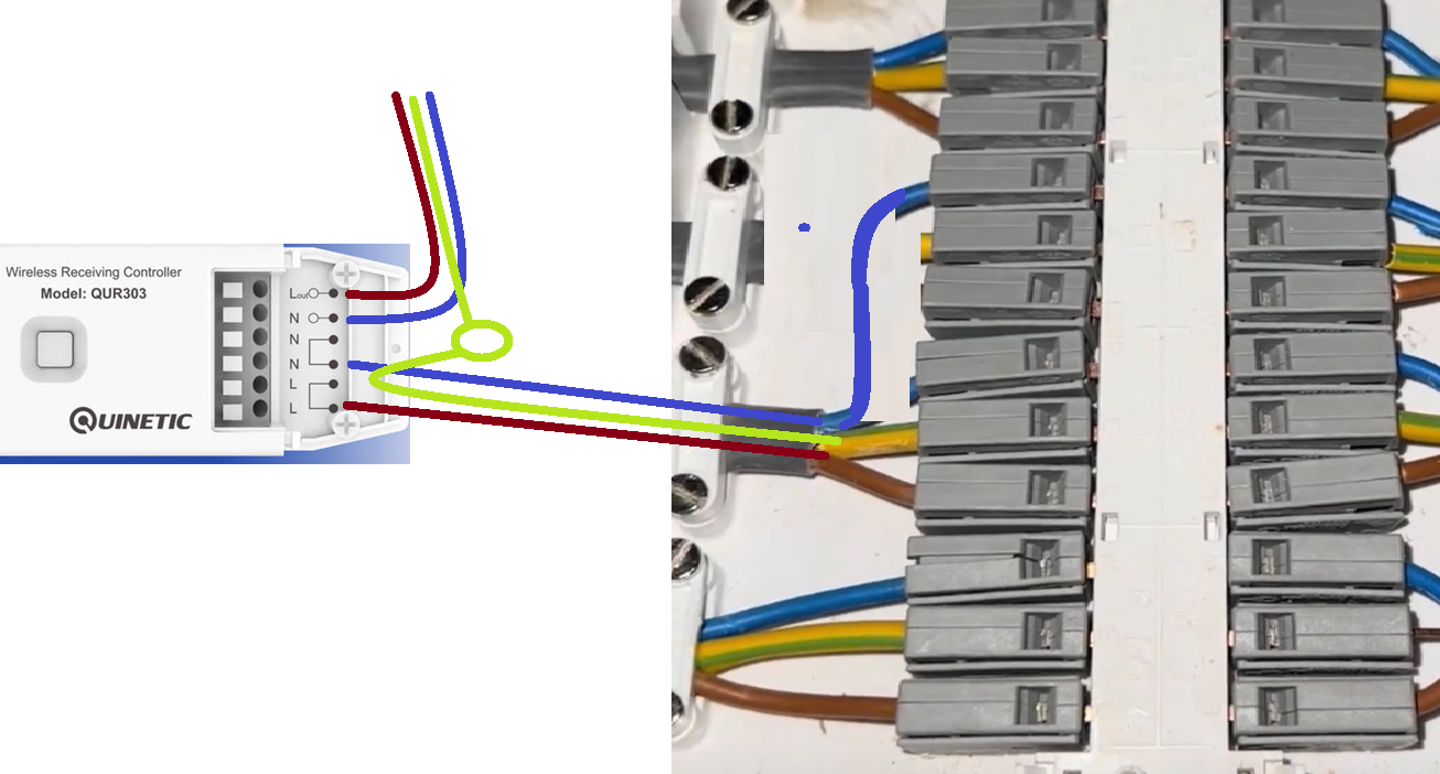

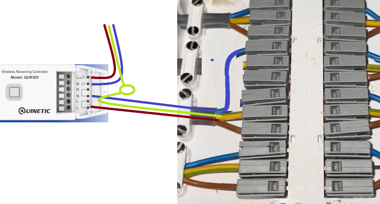

Thanks all. I’m not getting it honestly. I was also thinking about taking perm feed that goes from fan isolator, split this for perm feed to the kinetic receiver and connect lamp cable to out. Is this bad practice? It seems easier, for me at least.

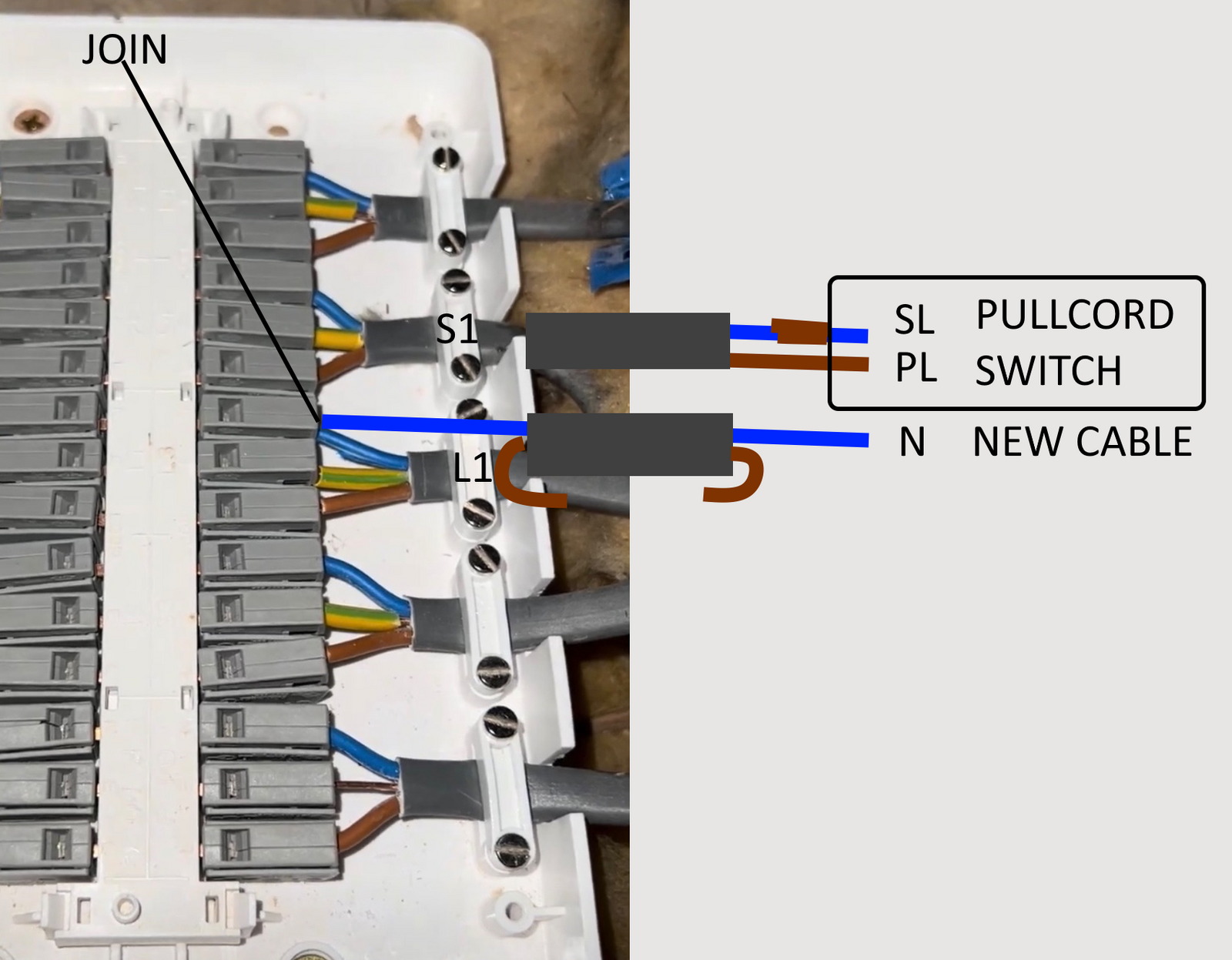

How many more times? You have a Perm feed at the pullcord switch cable.
It is the Neutral that is the problem.
It seems silly to use a fan isolator when everything you need is in the junction box.

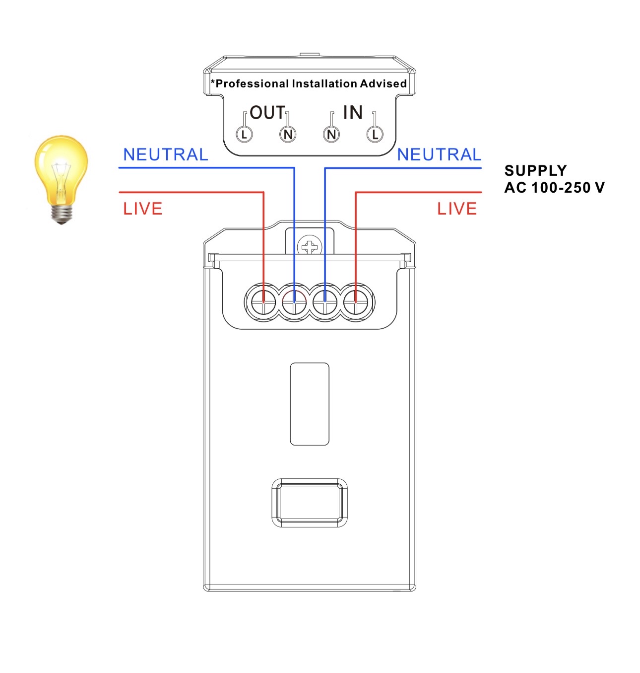

have you got your wireless receiver yet?
does it ned a Neutral and Live and Switched Live? IE 3 wires
can you post pics of the receiver and the wiring instructions that came with it?

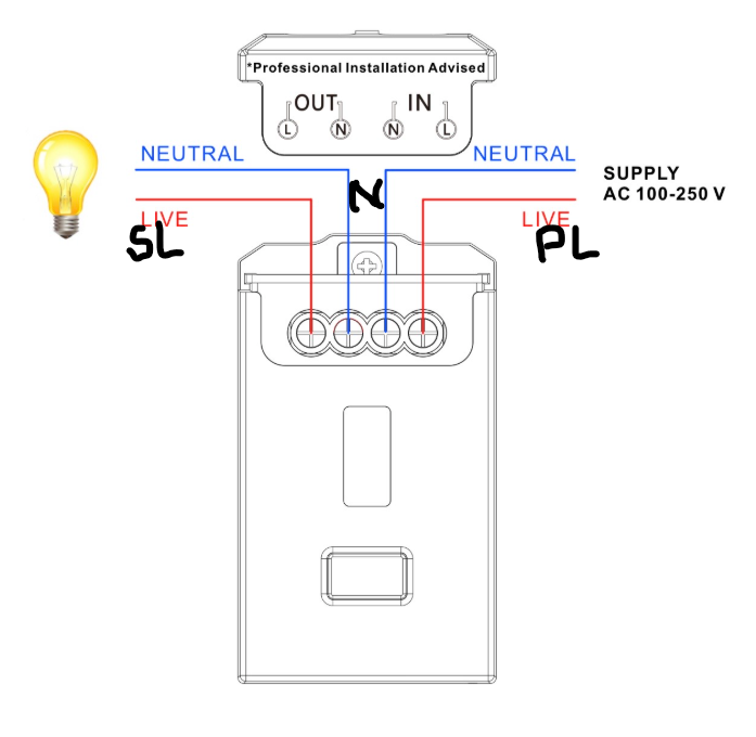

If it does require perm L and N then this is works
picking N from the light position and L from the switch position
For example
A receiver of that style will require an enclosure with proper cable restraint/clamps so the earth wire is enclosed.
If it does require perm L and N then this is worksView attachment 406663
For exampleView attachment 406664A receiver of that style will require an enclosure with proper cable restraint/clamps so the earth wire is enclosed.
These surewires and other similar products are brilliant devices until something different is required.

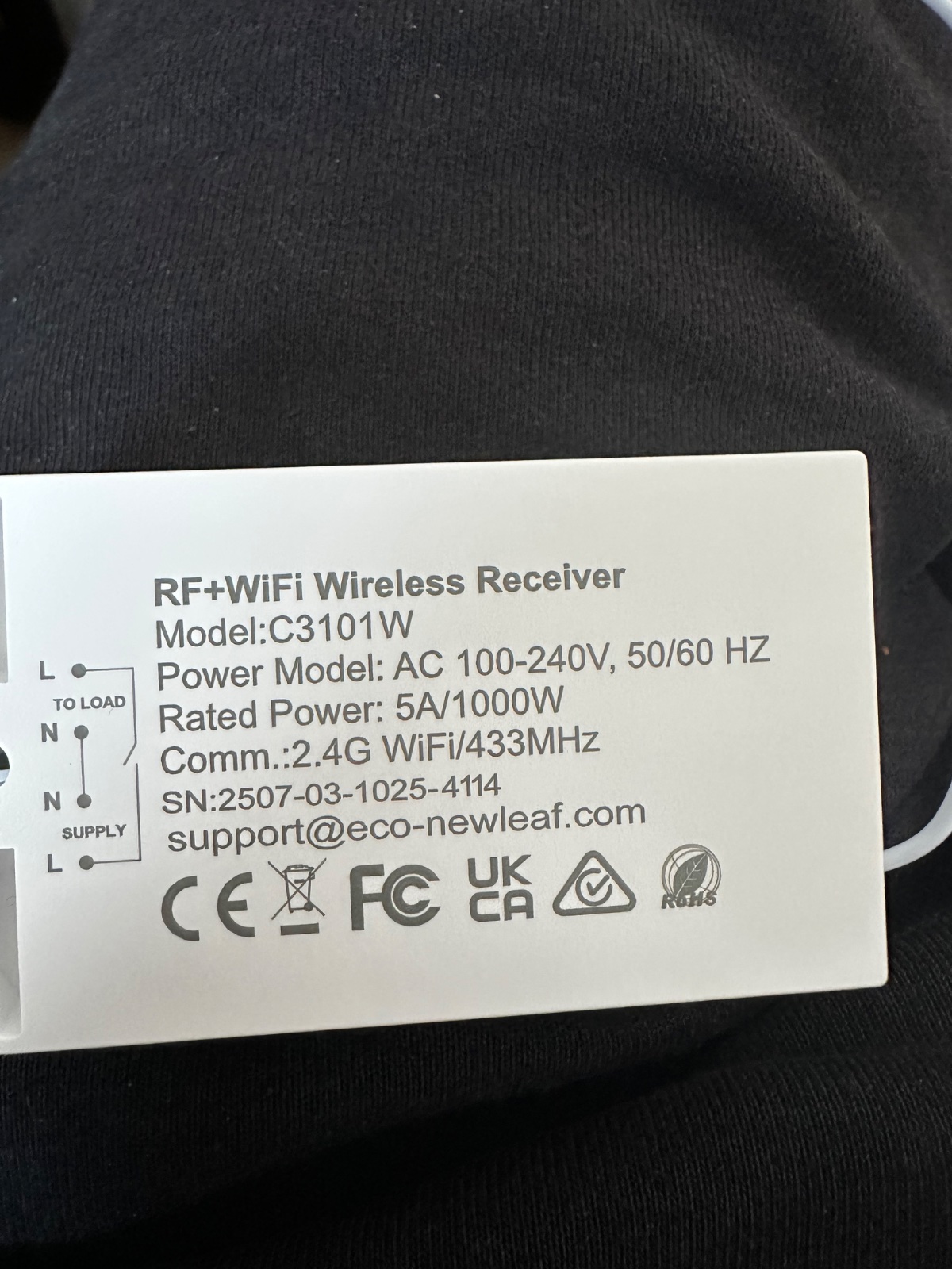

Thanks. Attached is the wireless receiver I have with me.

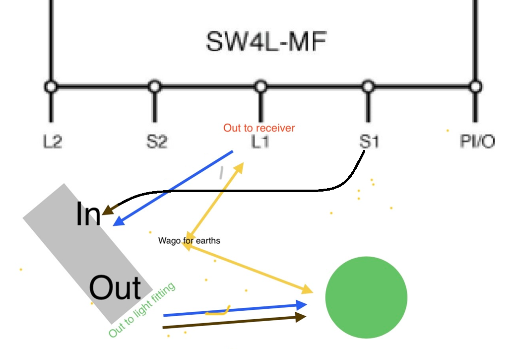

Wiring attached.
