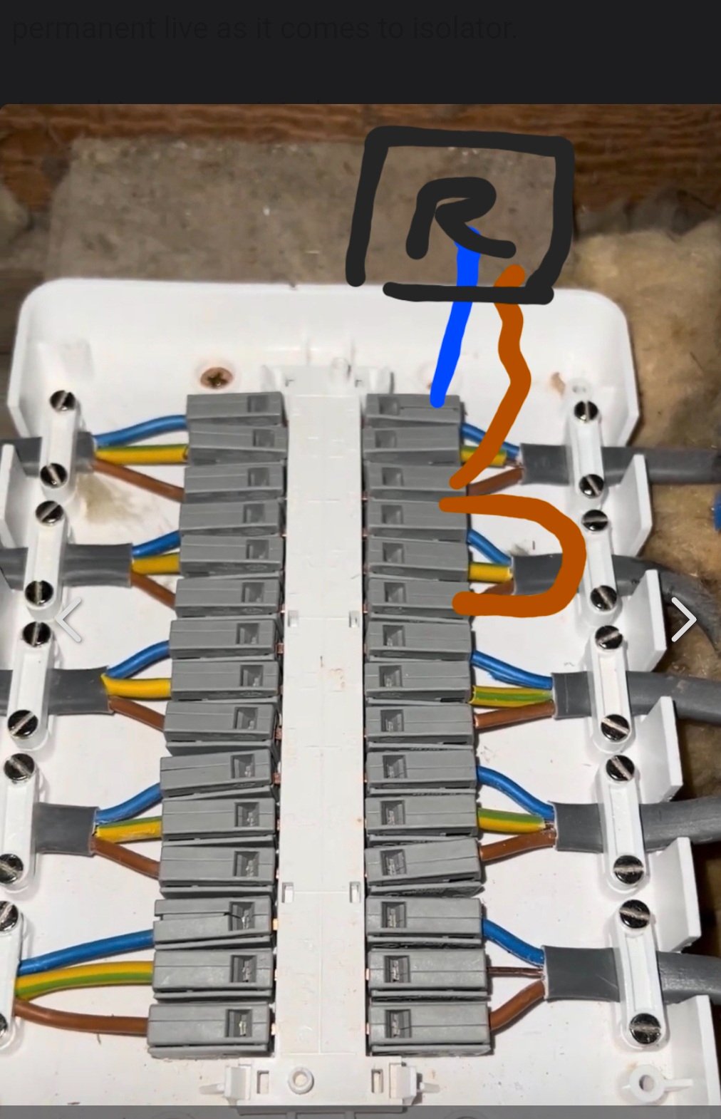

I need a permanent live. Junction box has power in and out already in use. Shall I just use wagos to tap into it? Doesn’t L1 rely on a permanent feed from JB?
I was also thinking about going by permanent feed from isolator switch for bathroom fan. That had permanent live as it comes to isolator.
Any advice appreciated.

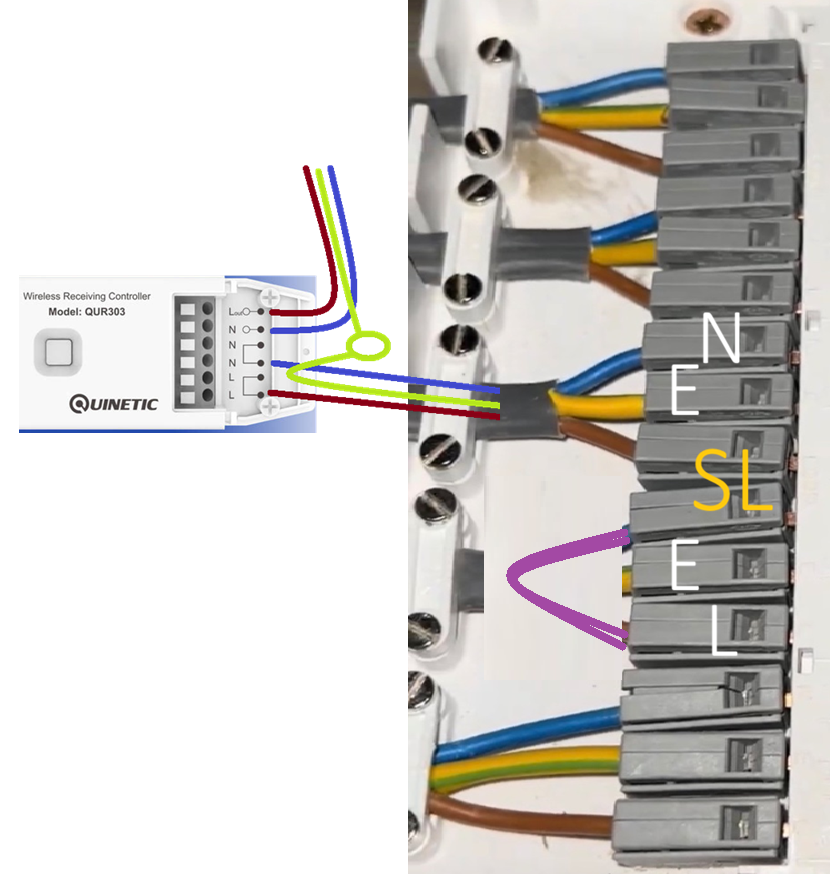

If your isolator is 3 pole for L, N, & SL and easy to run a cable to; then a length of 3 core and earth from there to the receiver. BUT that will require additional investigation on how it's been wired beside the Surewire system and how to isolate the existing switch wiring.

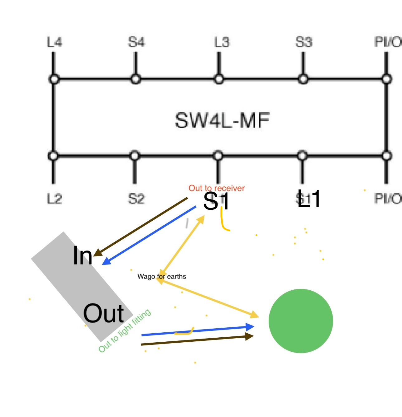

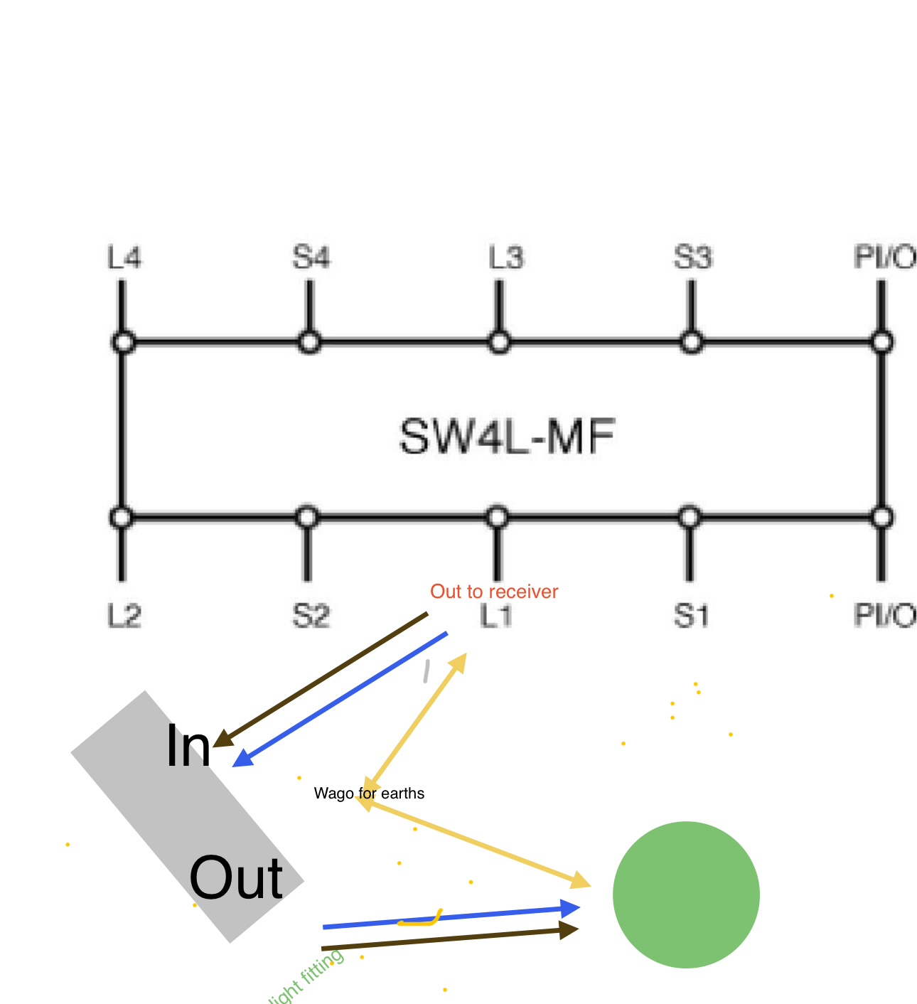

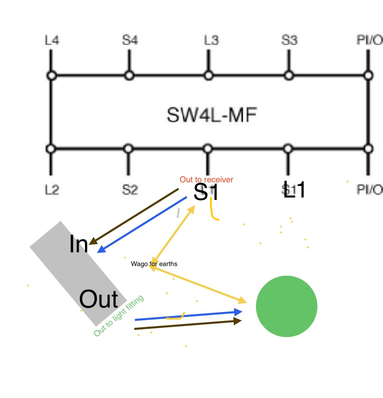

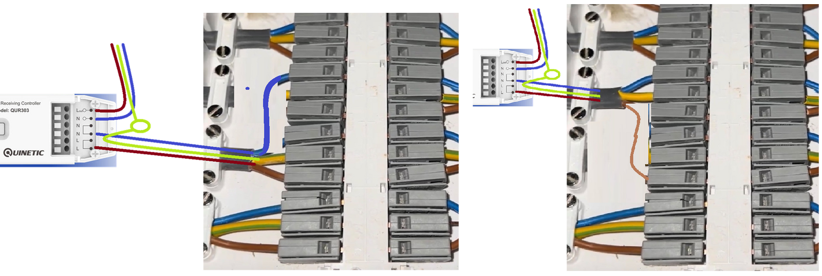

So you’re trying to say this would work too? Of course I got l1 confused here.
I did take a look at your diagram and I will try it if I won’t get confirmation that below will work too.
This is what I mean:

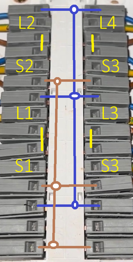

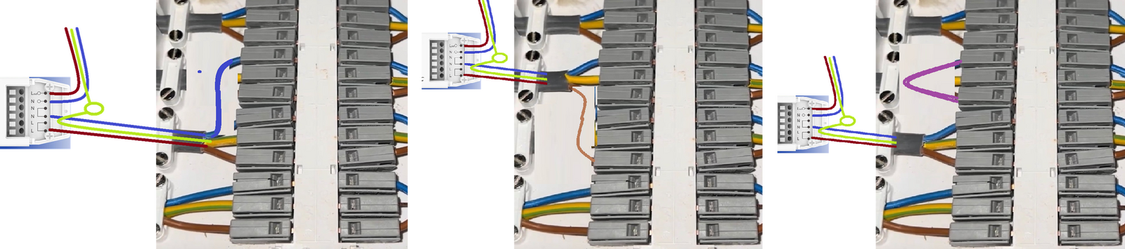

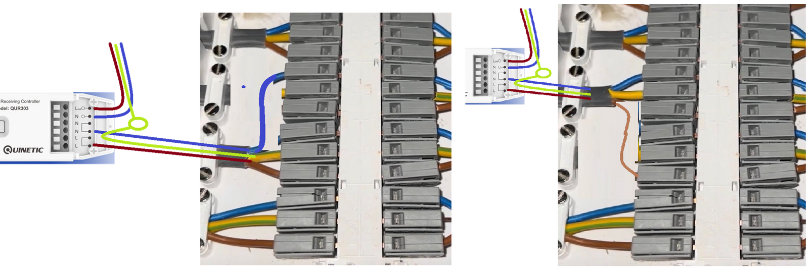

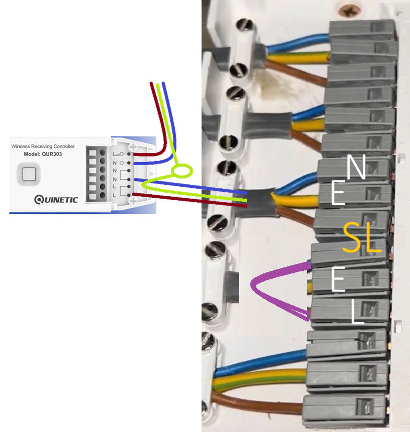

You're starting to get mixed up

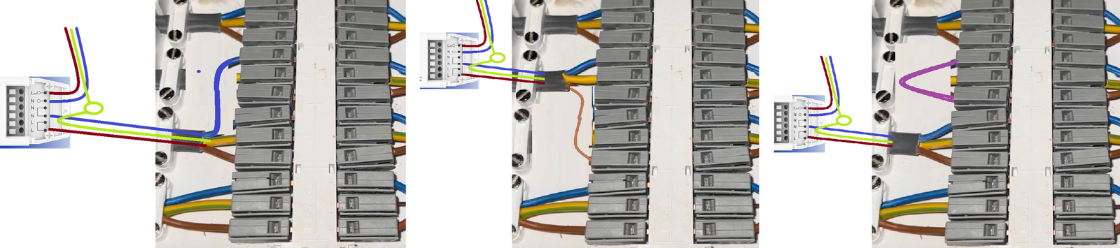

The position of L1 and S1 are fixed in the Surewire by the internal electrics in the white strip between the terminals with Line (Live) going to the switch and Neutral to the light and a Switched Linebetween (I hope I have the numerical designations correct in this pic as I cant read any of the markings but have followed the line sketch)
This
is what you are indicating but you will need to add the link in the Surewire which I've shown in purple (just to make it obvious).
Ultimately you will need to connect to L from S1, E from S1 or L1 & N from L1 which your suggestion achieves.
These are electrically the same and any of the 4 versions are acceptable, only 2 require the link wire:
You're starting to get mixed upView attachment 406694
This View attachment 406696

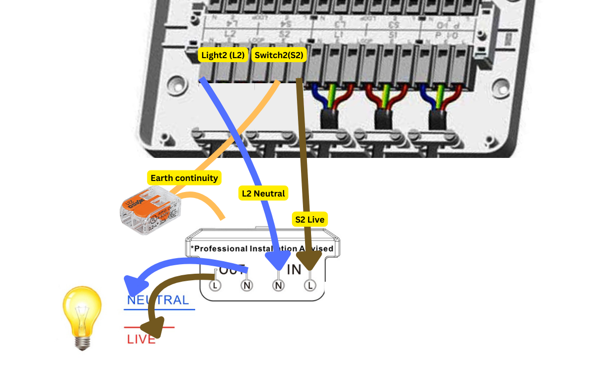

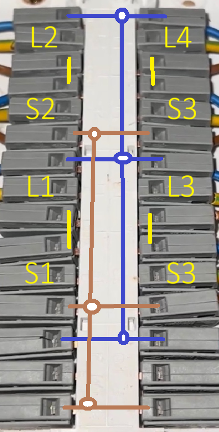

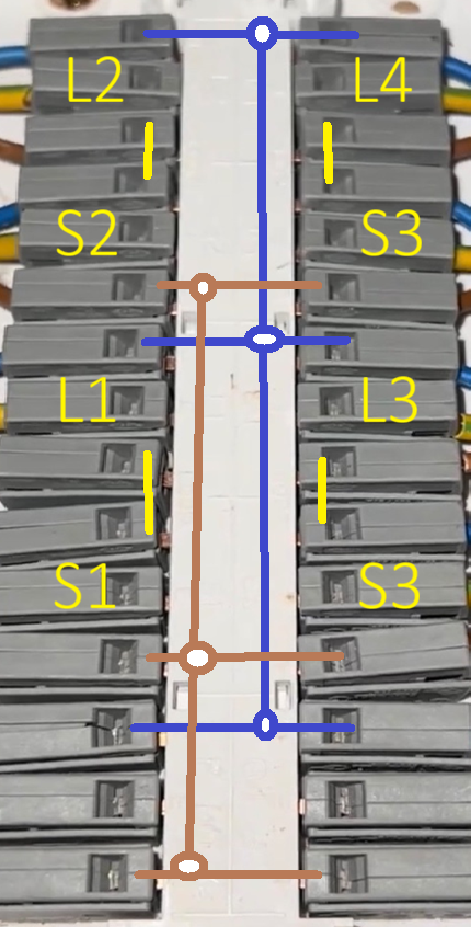

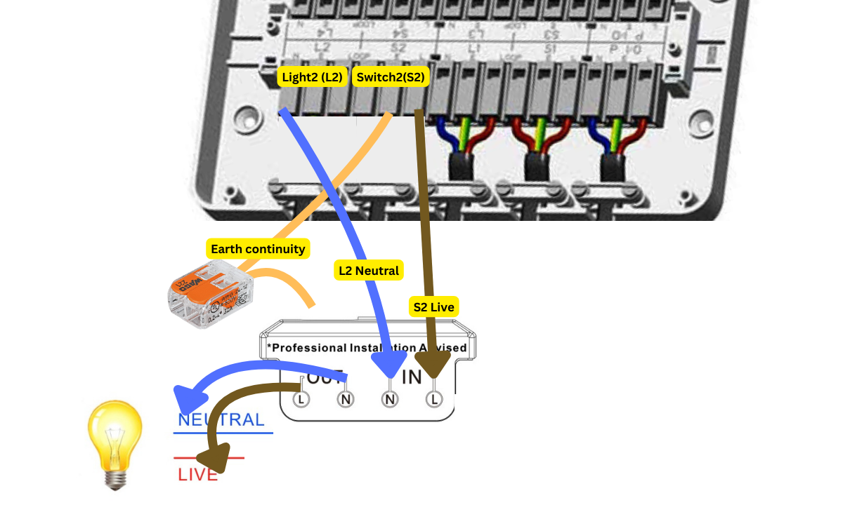

Thank you. This example makes sense for me. I think the easiest will be to do what I’ve attached. It matches version 1 of 3 examples image. Is this correct? :) changed to s2 and l2 as this is exactly as they are for bathroom light. Was going by 1 as it was easier.
I don't think that will work as there isnt a live going into the switch connection for one to come out
According to the diagram prepared by another user above, it should have live. It’s already supplying live to pull cord, or not?
Sorry I've edited this a bit too close but perm L is on S2 and perm N is on L2 the SL parts are redundant
just like used here
and as close as dammit to this except I showed it on S1 & L1
