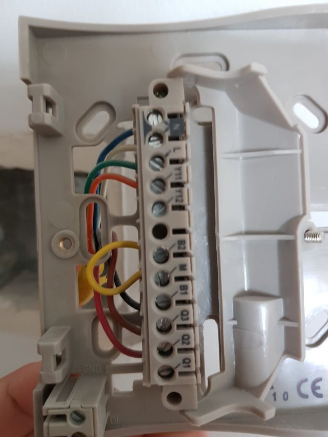

HiI'm changing my old Siemens thermostat to a new honeywell one however i'm struggling with the coding as it is different. can someone help? I have added the images for the old wiring and the new one and what i could match from the manuals however not sure where to put the N wires and the yellow wire in B2 and M

I am not familiar with the system but -
4 is obviously neutral, and
As for the yellow, it just bridges B2 and M - what are they for?
The model numbers would help.

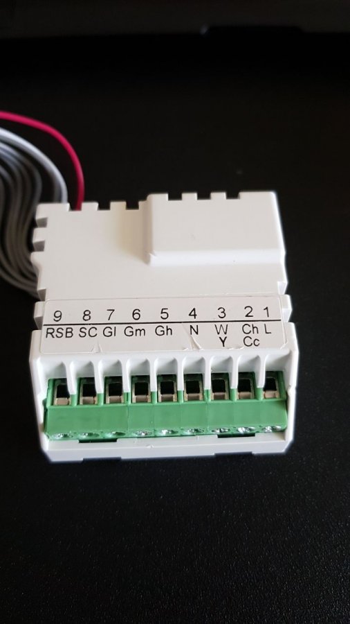

Hi Model numbers are Siemens RDF10 and the new thermostat is Honeywell T6861. the thing is in the old siemens there are two Neutral (white and blue) but only one N in the new thermostat

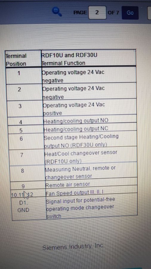

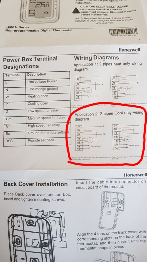

Here are the manuals too :)
