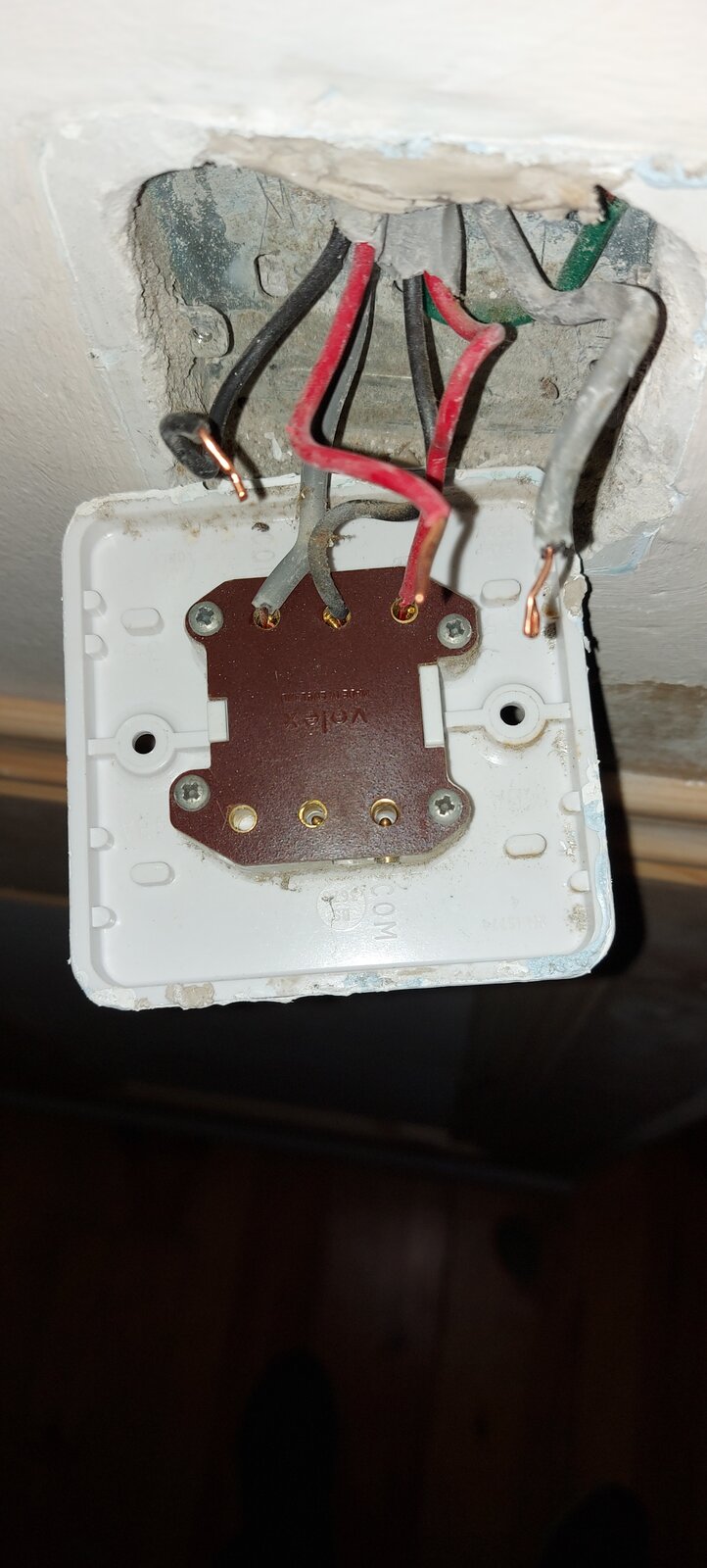

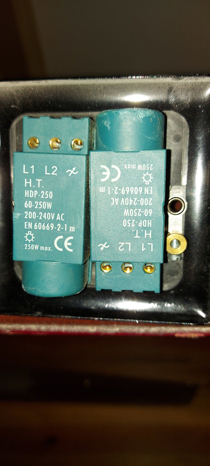

Can anyone advise where the wires go to the new switch plate please?
Old and New ones attached.

Wiggly line with arrow = Com.
The others don't matter which way round in this case.
The 2 terminals opposite the Com go to the same switch.
Oh, and earth the metal faceplate!!
If you have LED lamps, make sure they are dimmer compatible.

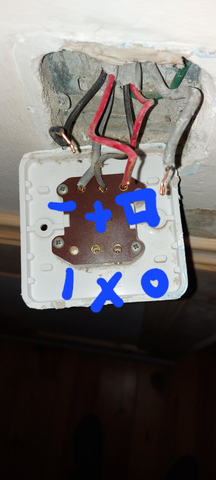

What does the symbols mean as in com 1, com 2 and wiggly line with arrow etc...
I =
X =
For new switch

The dimmers do not look suitable for led lights.
But here is the order for the wires.
Mark the cables and photo them before you remove them from old switch so you can put them back in if new switch does not work.
And make sure new metal face plate will have an earth cable connection to it. If it does not, STOP, and keep the plastic plate.
You can see the words COM on the plastic plate next to your o and your -.
- = COM (wiggly line on switch 1)
+ = L1 (on switch 2)
□= L2 (on switch 2)
I = L1 (on switch 1)
X =L2 (on switch 1)
○ = COM (wiggly line on switch 2)

Tried thie above lights didn't work at all.
Checked the other 2 single gang switches and the red wire is in L1 in one switch and L2 in the other switch. The black wire is the same.
Grey wire is com.
Tried this too lights didn't work.
Any ideas or dimmers will not work?
