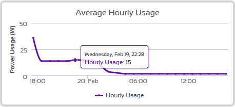

When I put my battery charger on an energy meter I could see the charge rate
and you can see how it turns down in stages it actual starts at 3.8A, then 3A, then 0.8A then 0.1A and finally off, and most scooters have some form of switch mode stage charging, however not all things using lead acid look after the battery in that way, the stair lift had rather a high charge rate and relied on being used on a regular basis to stop over charging, the hedge cutter stated 16 hours only, the jump starting pack was similar to the Lidi battery charger shown and turned off the charger and to look at there is nothing on the charger to say if a stage charger, pulse charger or a charger with no control, the battery charger for my hedge cutter looked exactly the same as the jump starting pack.

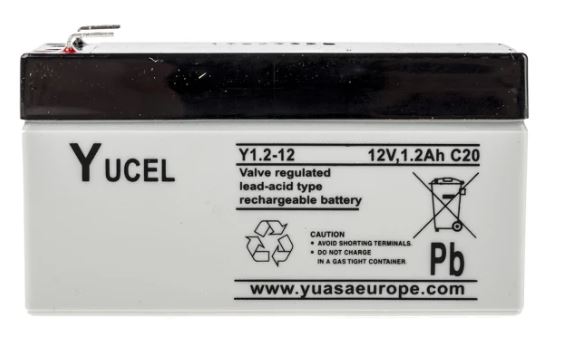

If you supply details of the battery (manufacturer, and model number) and the same for the charger, you might get an objective answer
