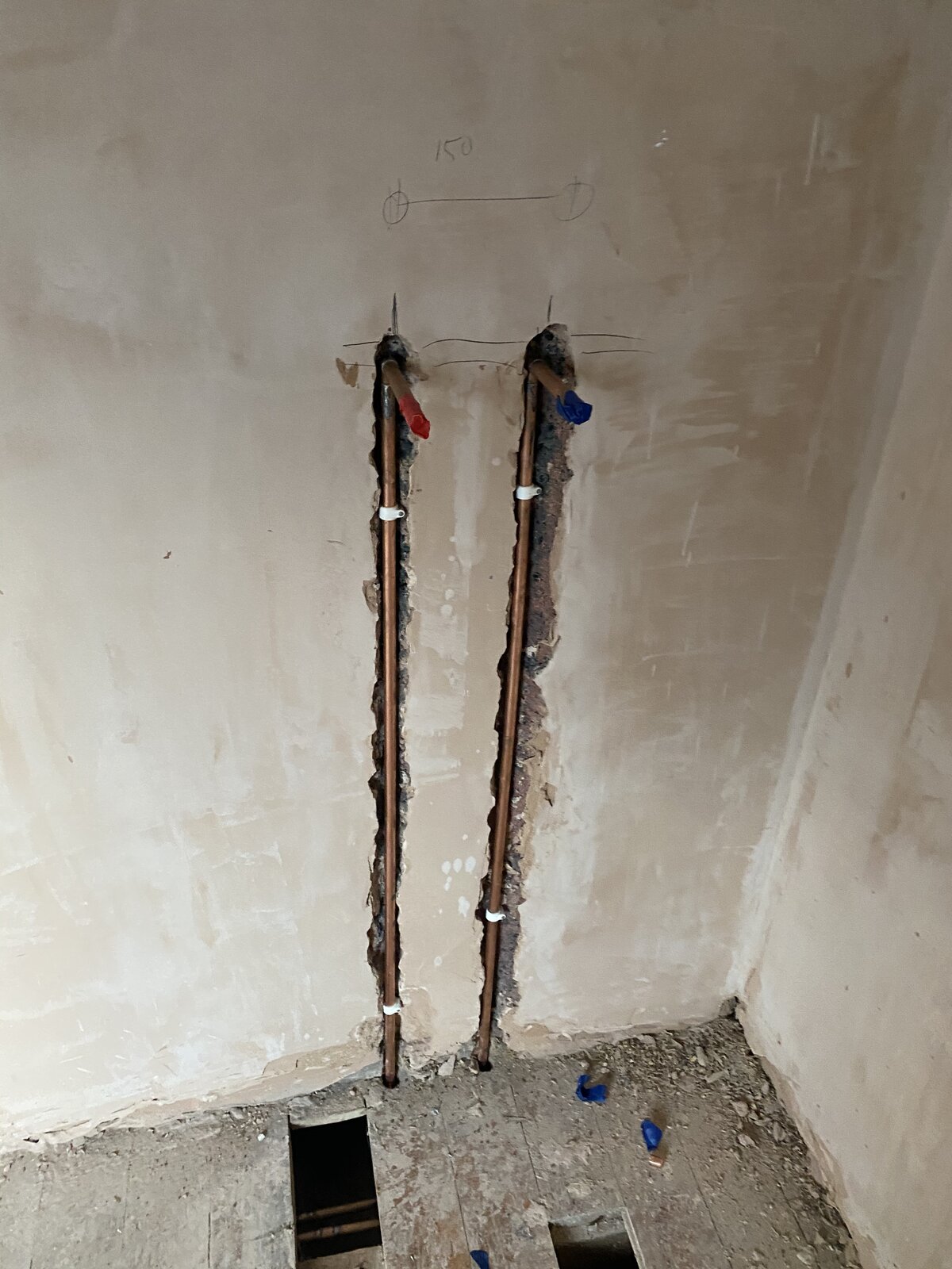

Chased in pipes to shower. Do I need to protect?
8 Sep 2012
833
11
West Midlands
How should I protect the following shower pipes. They going to be tiled.
I have some spiral wrap. Would that work?
Too late, you really want to wrap them before they're in the wall :whistle:
Only joking, Denso, insulating, gorilla, duct(gaffa) tape. Even painting them with an oil based paint will do.
