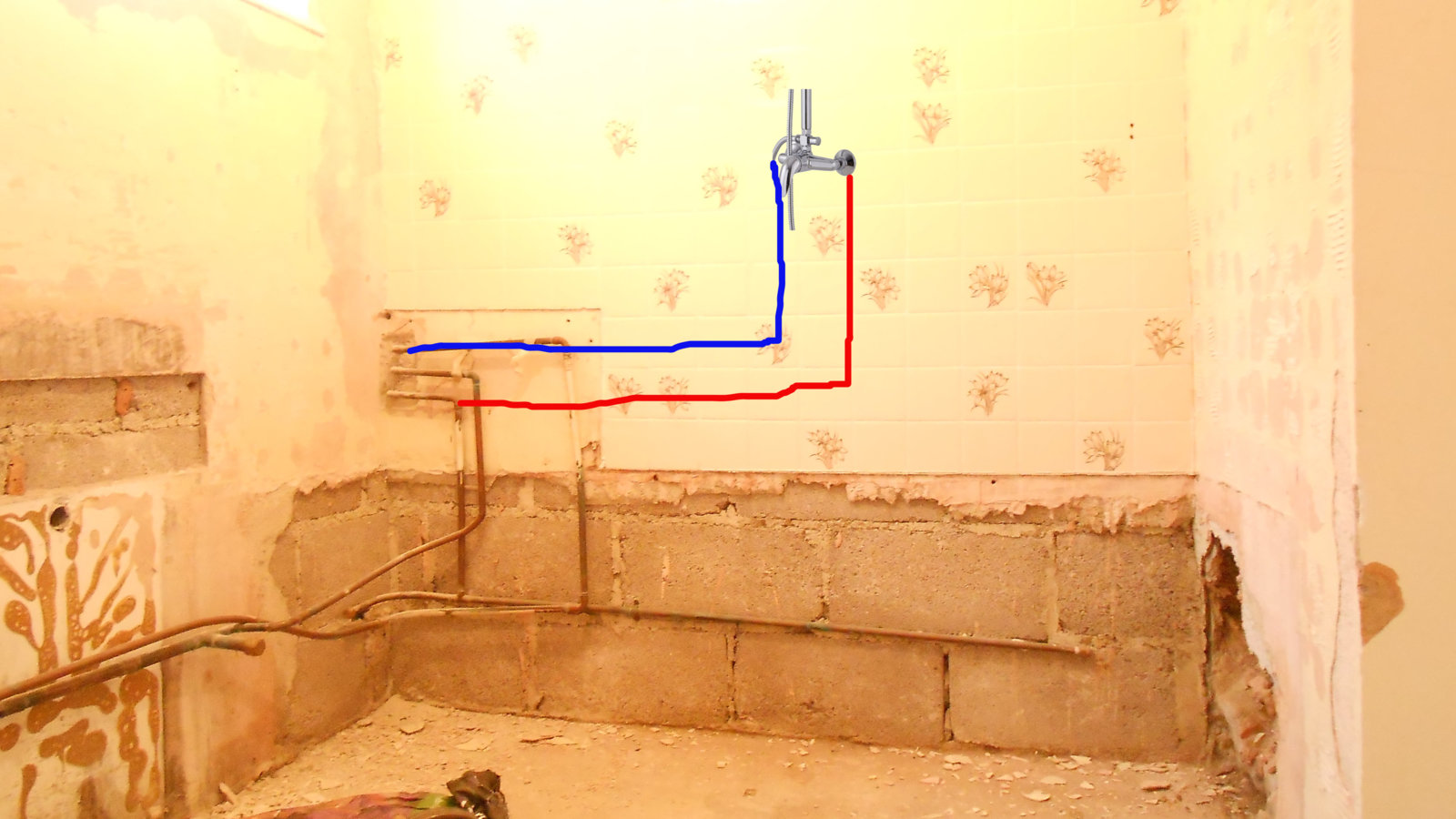

Hi all,
I want to cut the chases to run 15mm hot and cold pipes to a mixer shower: https://www.diy.com/departments/mai...ver-mixer-shower-with-diverter/1618581_BQ.prd

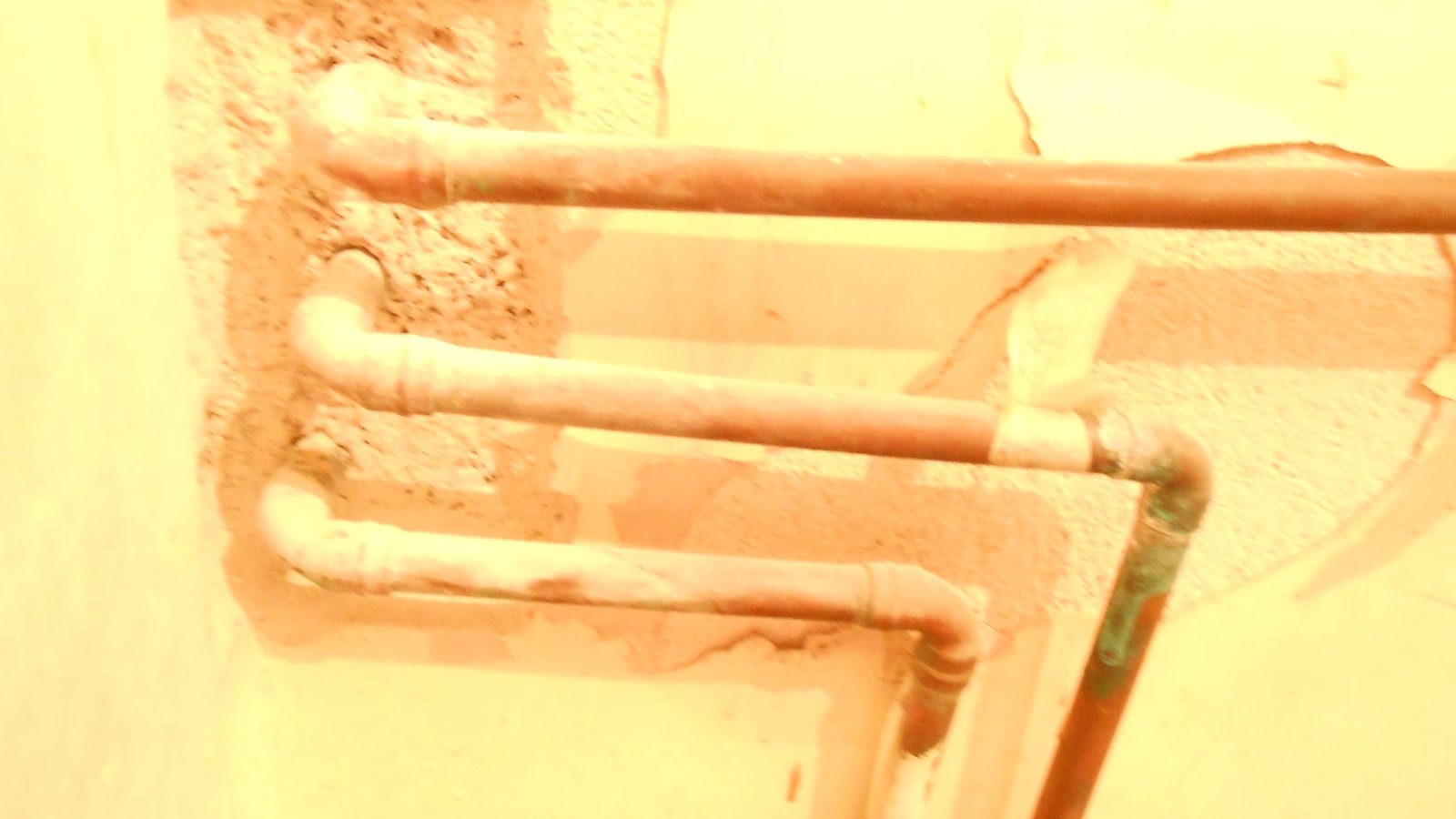

The photo shows the current pipe runs, and the planned position of the shower. the 2nd photo shows the detail of the pipes going into the wall (from the bottom up they are hot, gas, cold)
The wall is an internal breeze block wall, which I'm going to tile (or have tiled).
I'm going to get a professional in to do the plumbing, and would like to get the chases cut in the next couple of days (before I'll have chance to speak to him).
Would I run the chase across and then up (as in the photo, but a bit less wriggly!)? Also how deep and wide should I make the chase?
Many thanks for your help, Stephen

2 Two vertical chases centres 150mm apart, deep enough to accommodate 15mm pipes with 9mm insulation i.e. 40mm minimum, from floor to shower position may be a better option than random horizontals both from the point of view of wall strength and future tradesmen knowing where not to drill.
